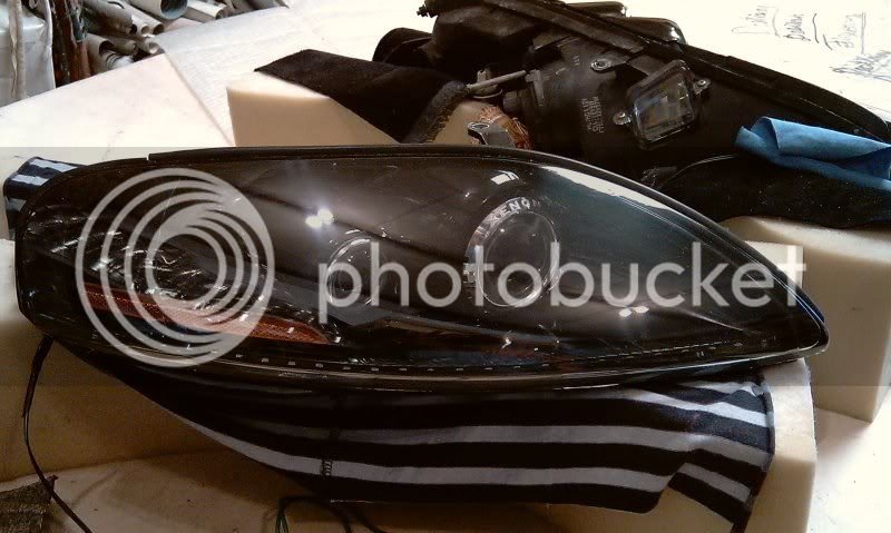

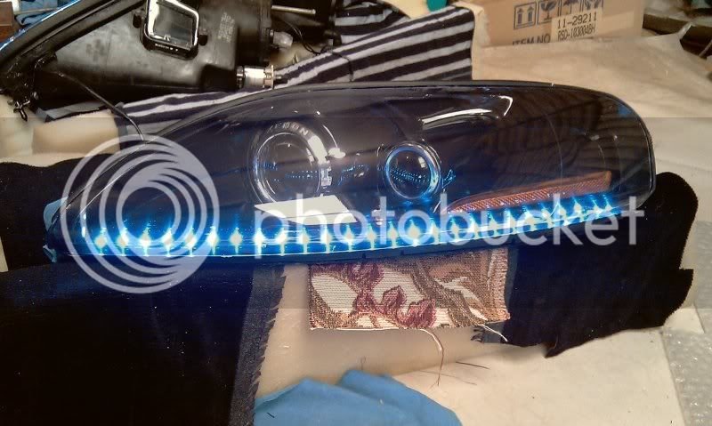

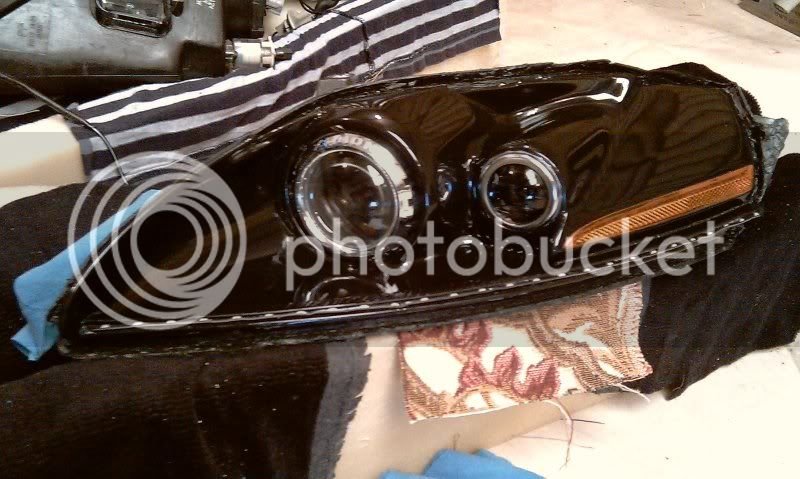

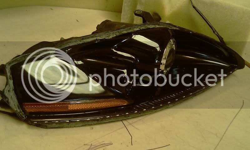

I stopped by and saw my headlights today...They are completed. They look Badass. I am quite pleased with them. The goal was to make a light that looked OEM, incorporated high quality HID, and still remainered OEM compliant...I managed to do so. Lety me know your thoughts...I will take better quality pics later, and soon some pics with them on the car. But not before the reveal.
No lens cover Passenger side:
No lens cover Driver side:
With clear Supermade lens cover Passenger side:
With clear Supermade lens cover and LED's on Driver side:
Ryan

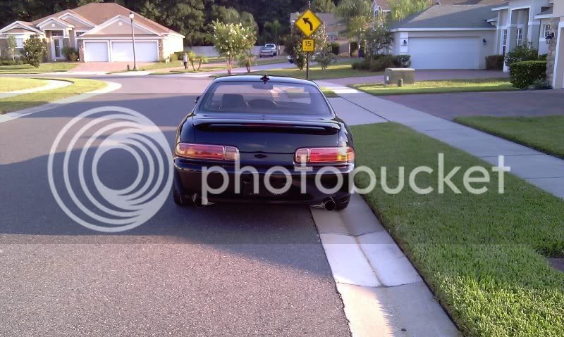

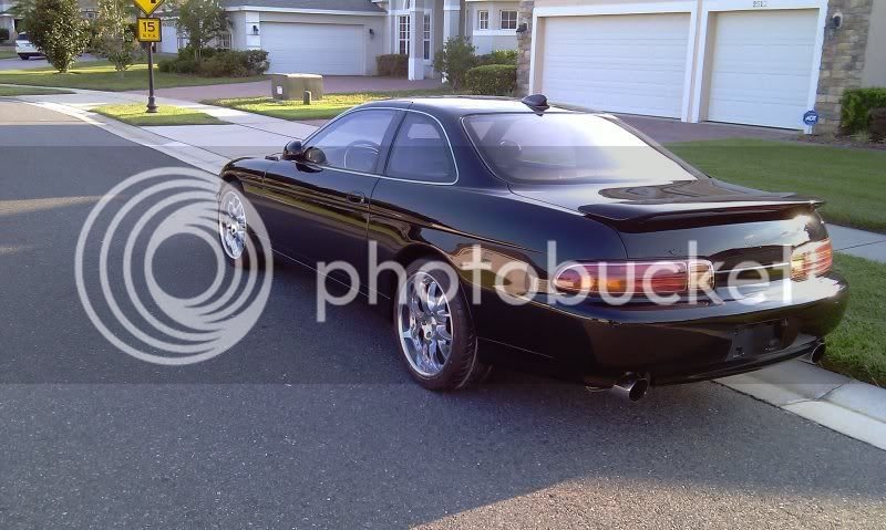

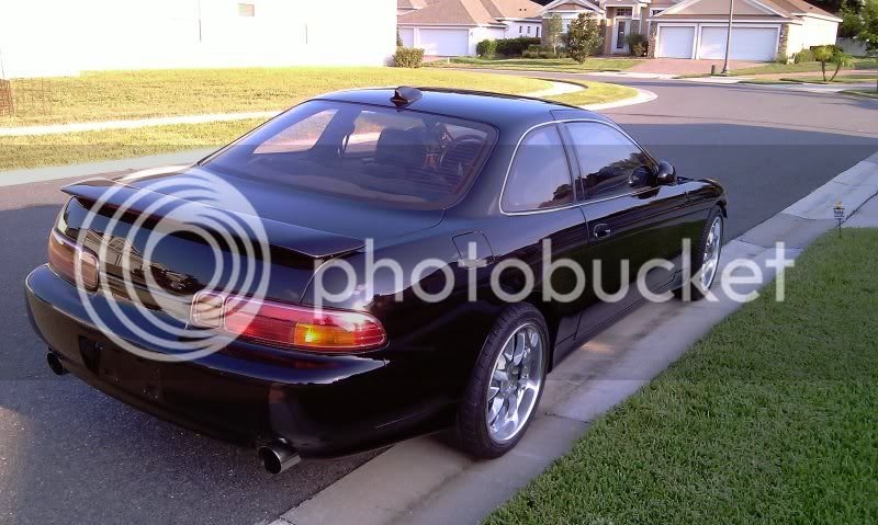

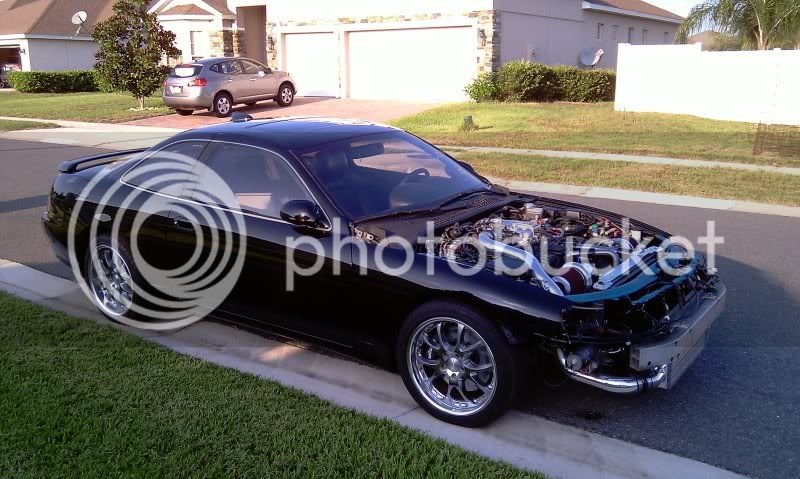

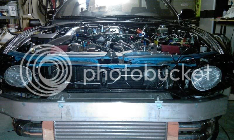

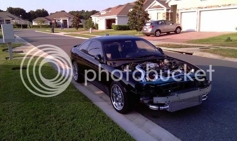

Great news! I did a real test drive today. I drove the car for a few miles while Scott did some base tuning. He got into the heart of the MAP, and accomplished some great tuning. We made some good progress today. I did not make a video, but trust me, one will be made soon.
I will be working a lot on the car this weekend.
I do have some pics to post so you can see that my car was indeed out of the garage.
