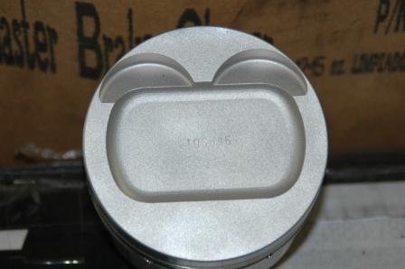

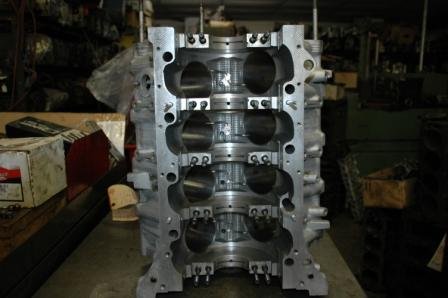

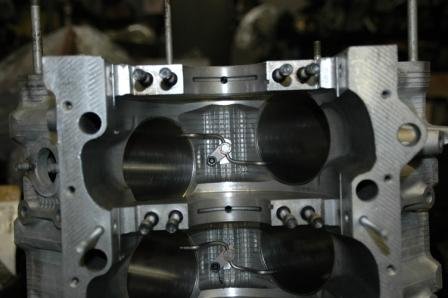

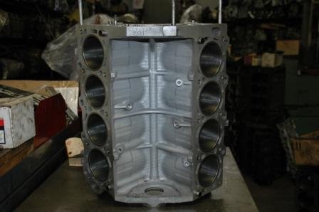

My built transmission has arrived, my built engine is finished complete with 2UZ oil squirtes, I am picking it up next week. My fuel mod is shipping out to me next week.
We will be performing the mock assembly to test all clearances at home, and then complete the final assembly of the engine. Then the swap gets done.

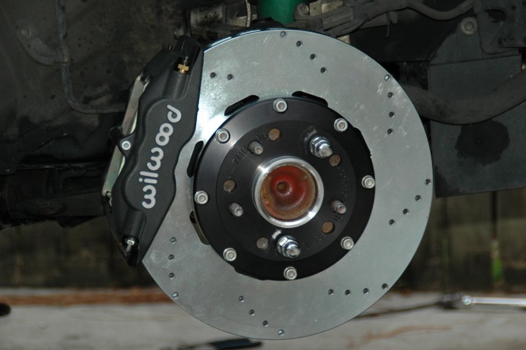

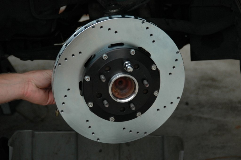

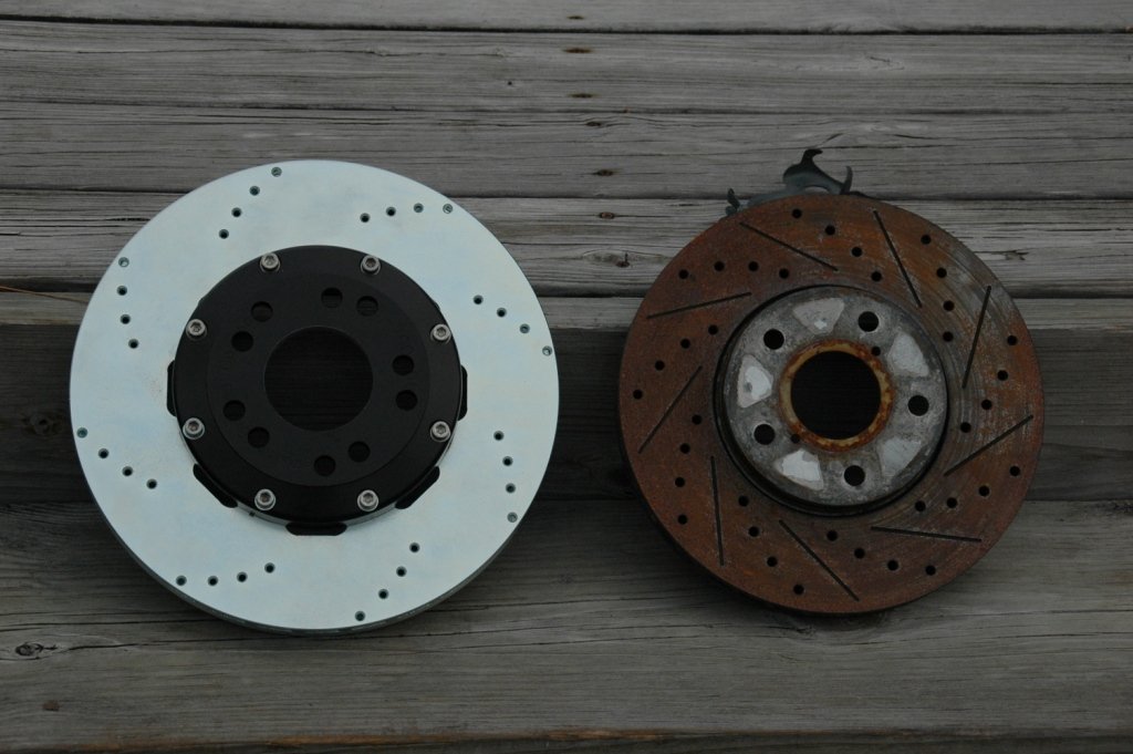

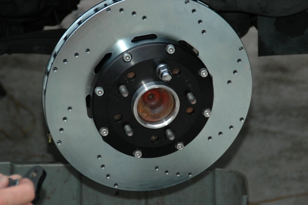

OK, Gang...We got the front BBK's installed, but did not have time to complete the rears, so that will be done tomorrow, and we will bleed the brakes at that time. I gotta tell you, these guys at Revolution Brakes (formerly Precision Brakes) make a quality kit. Everything was machined extremely precisely, and abviously, the Willwood calipers are awesome, and extremely lightlweight...thumbsup.gif Even the SS braided brake lines were made precisely...The ends were made exactly to fit into the Lexus mounting bracket and be held in place by the stock C clip, and the larger rectangular mounting clip. The fit was spot on exact...thumbsup.gifthumbsup.gifthumbsup.gif I was extremely pleased. Thw center rings that they machined to extend the hub center were also spot on perfect...
From brackets to bolts to washers to calipers to hats to rotors, this kit was well thought out and engineered to work on my car, and provide increased braking capability utilizing the stock master cylinder...woot.gif
Here are a few pics...
BBK Installed
Another
Another
Comparison of size of old one-piece rotor to new two-piece rotor.

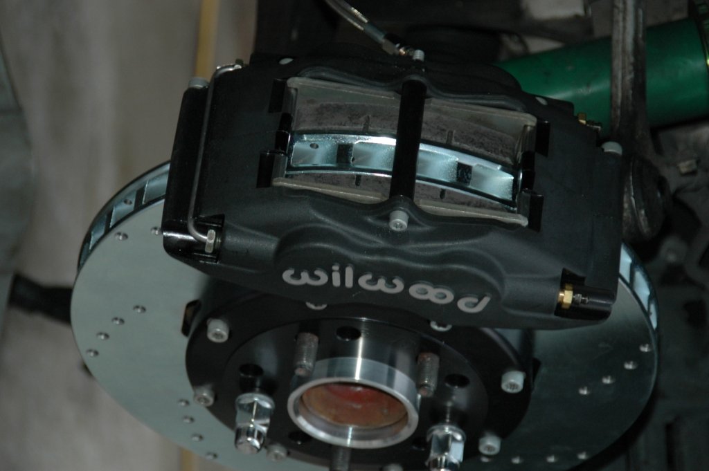

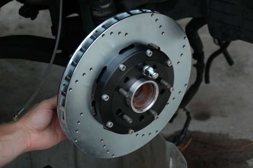

Here are the rest of the pics of the front BBK's before installing the rears and putting the wheels back on...More to come tomorrow...
With Caliper installed...
With Pads and SS Line installed...
Close up of Wilwood pads...

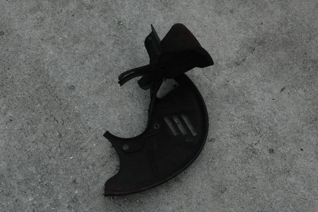

Removed the Dust shield, decided not to reuse, won't fit anyway...

Looking very nice mate, good to see you are useing wilwood...as thats what i will be useing for my setup, as they comeout about 1/2 the price of Brembo & stoptec, and if you ask me the wilwood ones are just as good if not better,
Yup and that looks like the way he has them? or i'm looking at it all wrong? is the caliper rear or front mount?
If it's front they are right, if it's rear the rotors are on backwards as you say :)
You are correct...They are on backwards...I miust have been dislexic when I was installing them.....
Thanks for the heads up.
