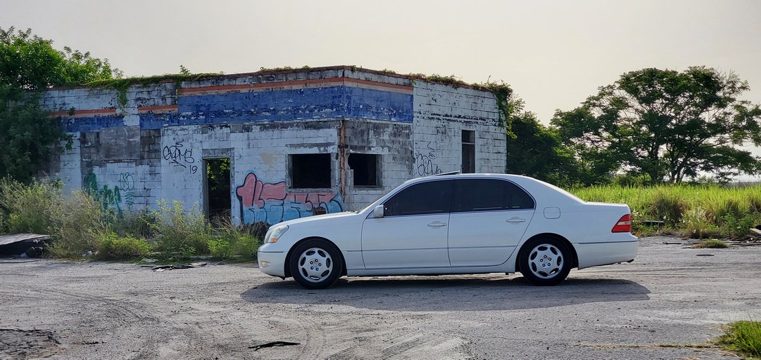

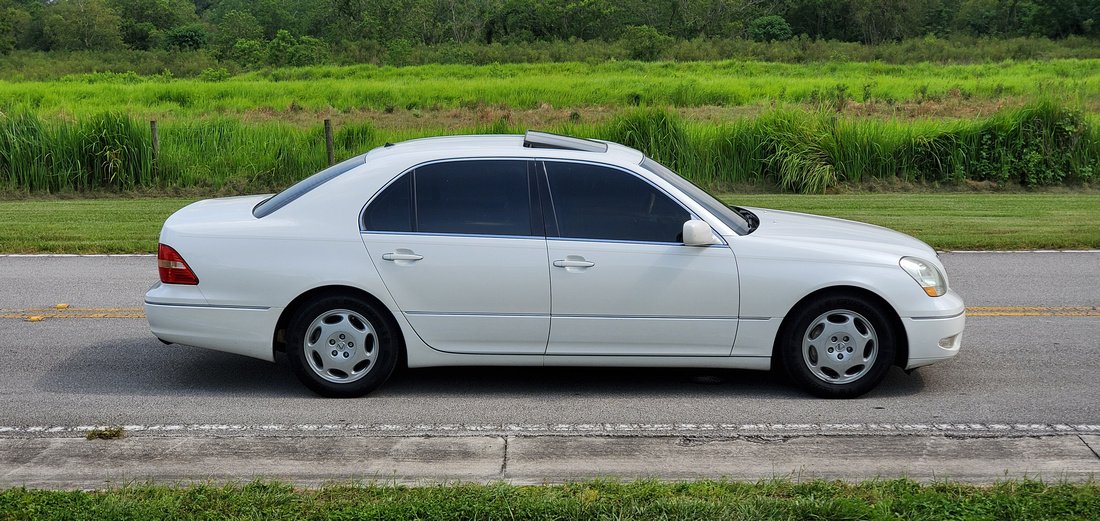

On a side note, a couple weekends ago, I got the timing belt, water pump, pulleys, tensioner, thermostat, temp sensor installed, the throttle body cleaned, and... The Fortune Auto custom valved coilovers installed. Dropped an inch at all four corners.
