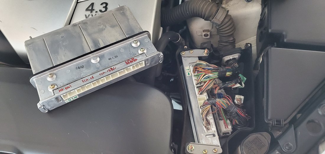

So at 2 in the morning, I decided to go out to the garage and install the new ECU. I jumped the OBD2 to let the ECU "learn" my keys for 30 minutes. Afterwards, pulled the jumper and gave it a go, and... It cranked right up! My girlfriend hopped in for a nice little night drive around the baron roads here in town.
