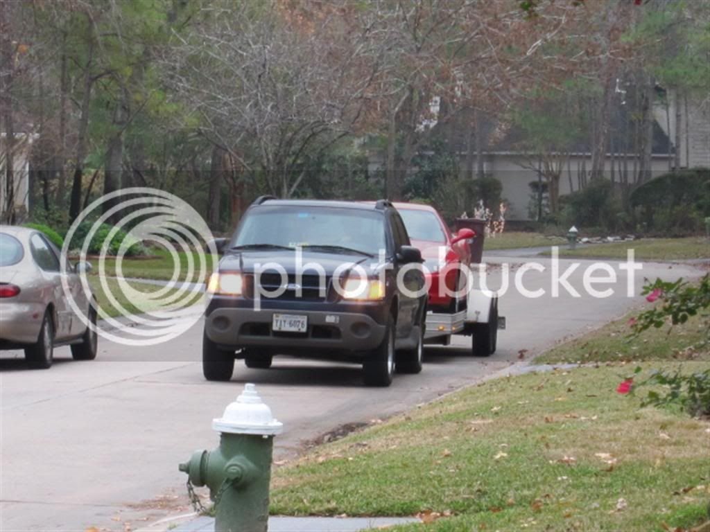

“Santa” arrived yesterday, a couple of days early, and towing a little red package for me:

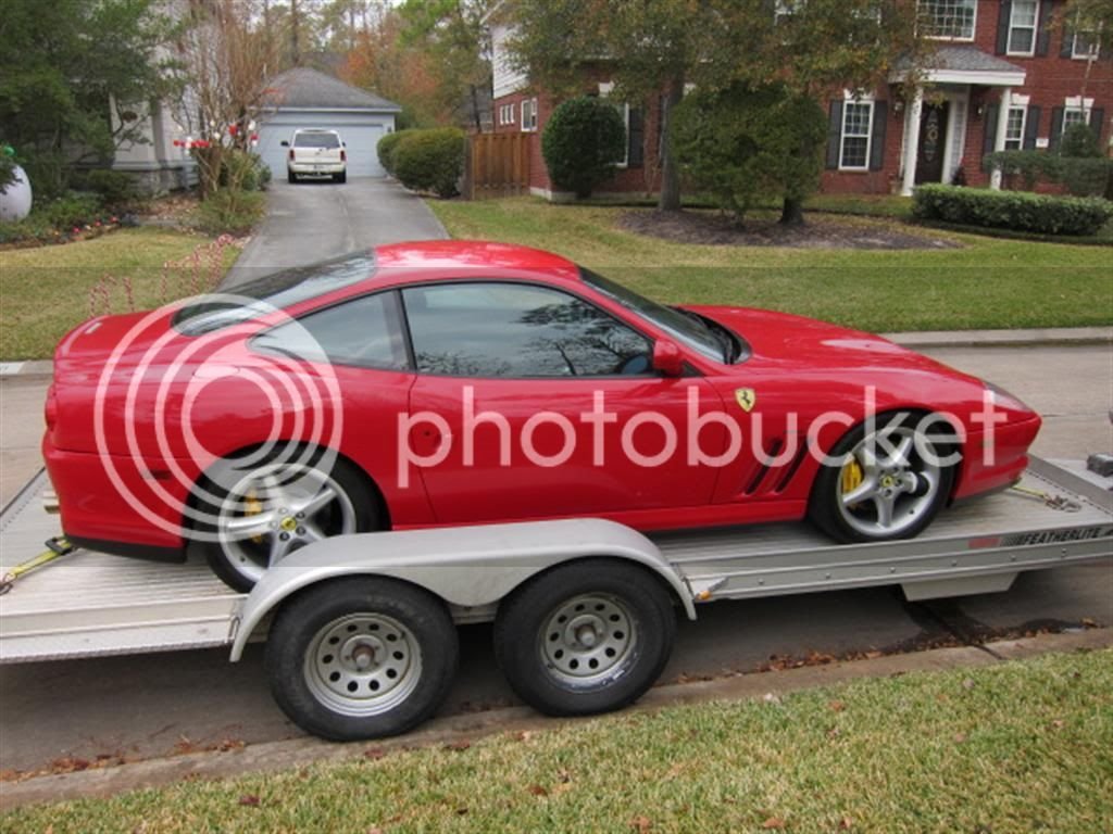

His finished work:

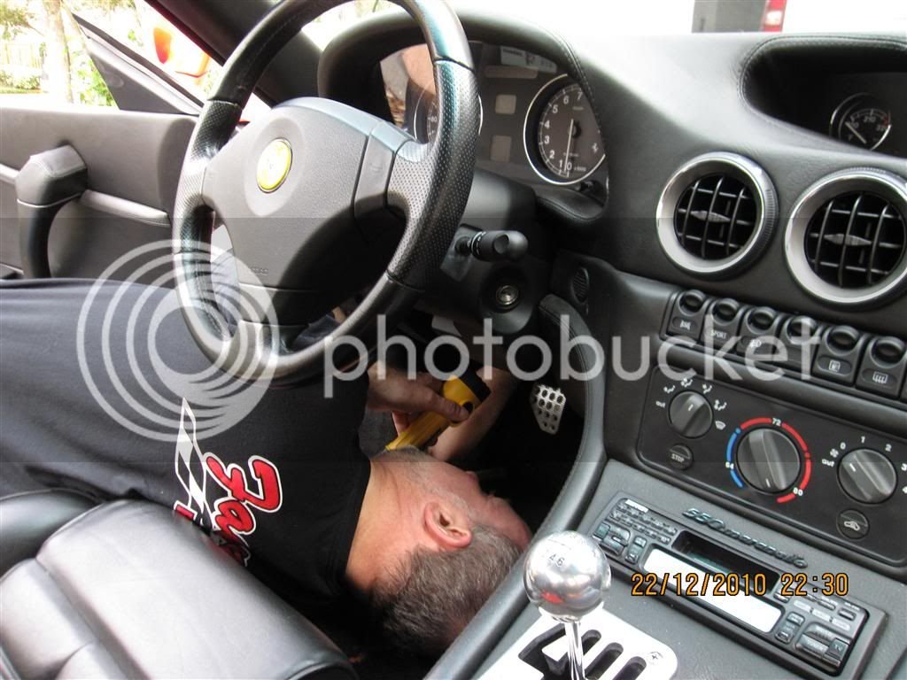

Of course, I couldn’t leave well enough alone; I felt the new clutch was engaging too high on the pedal, so I’m adjusting it:
