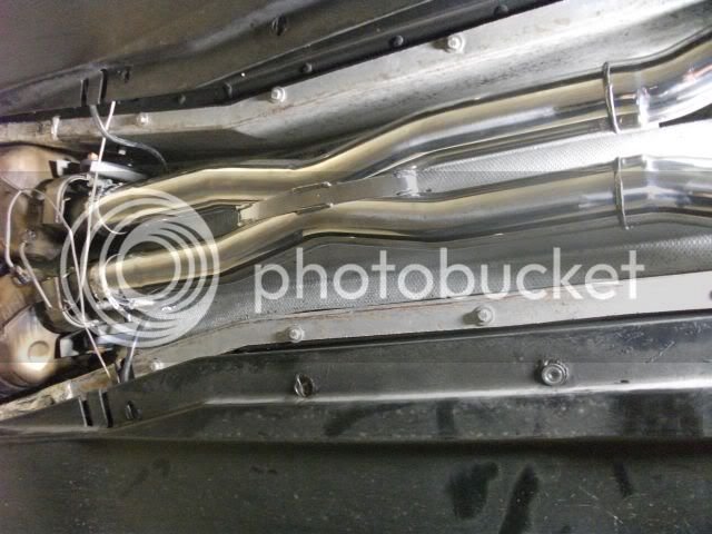

We'll see how it sounds with the X-pipe. I've been advised that the lack of resonators may cause too much of a "drone", and if so, it's easy enough to undo and put the resonators back on. I was tempted to go all the way and replace the cats with test pipes, but the harness would require a bit of modification for the O2 sims to avoid the CEL's, and one thing I'm not going to do with this car is allow any harness mods. Both the resonator replacement X-pipe, and the cat replacement pipes are made by Larini in England, so they're very high quality stainless pieces.
Can you post a pic of the Larini x pipe?

@ Sean: Sorry, I didn't see your post; here's a pic of the Larini X-pipe for the 550 Maranello:

The Larini X-pipe resonator replacement installed:

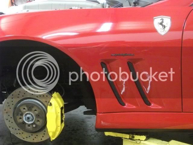

The newly powdercoated calipers and SF shields installed. The traditional Ferrari script will be applied to the calipers today or tomorrow:

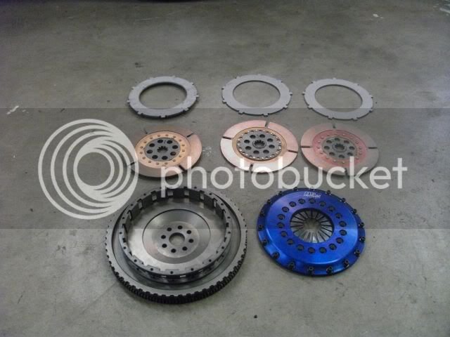

The new OS Giken clutch.

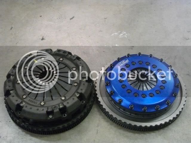

It’s an 8.5” triple with metallic linings to replace the 11” single disc organic. This is Giken’s first street clutch for the 550 Maranello, and my car is the beta test case. Here’s the old & new setups side by side:
Some weight comparisons:
OEM Clutch w/Flywheel: 45lbs
Giken Clutch w/Flywheel: 31lbs
OEM Flywheel: 20lbs
Giken Flywheel: 16lbs
OEM Clutch: 25lbs
Giken Clutch: 15lbs
People who know me will think I’ve completely lost my mind buying this clutch after all the moaning I’ve done about the TRD Twin Disc in my Supra, but we’re hoping for greater things with this Giken clutch than the TRD. First, the Maranello is NOT torque challenged at launch, like the Supra so it should be able to launch better with a lighter setup than the Supra does, second, we’ve only shed perhaps 31% of the weight of the OEM setup, so at 31 lbs total, it’s still a fairly heavy setup. We’re not going from OEM 35lbs to 15 lbs like the TRD setup. Third, Giken have put their lightest pressure plate on this, to ease the engagement, and fourth, Giken’s metallic clutches are known to be some of the easiest to drive metallics in the business. So here’s keeping my fingers crossed that this isn’t an undriveable on/off switch……

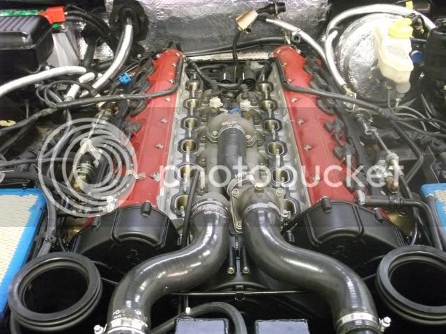

Here's the Scuderia Rampant Innovations (SRI) coolant hose kit going in:
Ferrari manufactures a car that is a piece of rolling art, and is engineered to perform extremely well. Unfortunately, it’s not engineered to be reliable, at least not in the sense of GM/Ford/Toyota type reliability. Many Ferrari replacement parts are known to be of fairly shoddy quality, and their hoses are some of the best (worst?) examples. On the Maranello model, it’s not unusual to have to replace these coolant hoses under the intake manifold every 3-4 years or so. On my 1999 car, the service history shows they were done twice already, and one was leaking again. Shocking.
So an enterprising Ferrari technician & shop owner set up a cottage business called Scuderia Rampante Innovations, to improve upon certain areas of Ferrari’s poor reliability, and these hose kits are one of his products. His goal is to make his hose kit the last set of hoses the car will ever need. He also does fuel hoses, replacement fuse boxes, and gold plated connector kits for many of the vintage Ferrari.

Cheers Justen, the jury's still out on whether this clutch will be great or a real dog. Should know something tomorrow when Josh takes it for a test spin before loading it on the trailer. Unfortunately there's 4" of fresh snow up in Virginia so he won't be able to give it a good test.
I got some very positive feedback on Giken's quad and triple disc clutches from another Supra owner that I have a ton of respect for. He's had three Gikens on his Supras over the last 12 years and loves 'em. His recommendation is what finally swayed me on this.
My guess ?? .. It will be o/k due to large surface area ?? Less Lb per squ inch ...
Are the hoses made of silicon ?? Suttle changes can make it so much more reliable...
NICE !!!
Thanks Graeme, I'm sure hoping you're right about the surface area 'cause that's what I'm betting on too for a lighter pedal. It's also one of the main reasons I went with this clutch, instead of another OEM. The pedal with the OEM was too heavy for the wife and I wanted her to be able to drive this car if she wants to. She gave me her blessing to buy the car in the first place, so I'd like for her to be able to enjoy it too, not just me.
To overcome the metallic's natural tendency for a harsher engagement, I'm betting on the lighter pressure plate (which may backfire and just produce more chatter) and still having a fairly high MOI with the fairly heavy flywheel, etc.. That and having a great OEM hydraulic release bearing system.
Pure silicone on the hoses. Not just a silicone outer layer.
