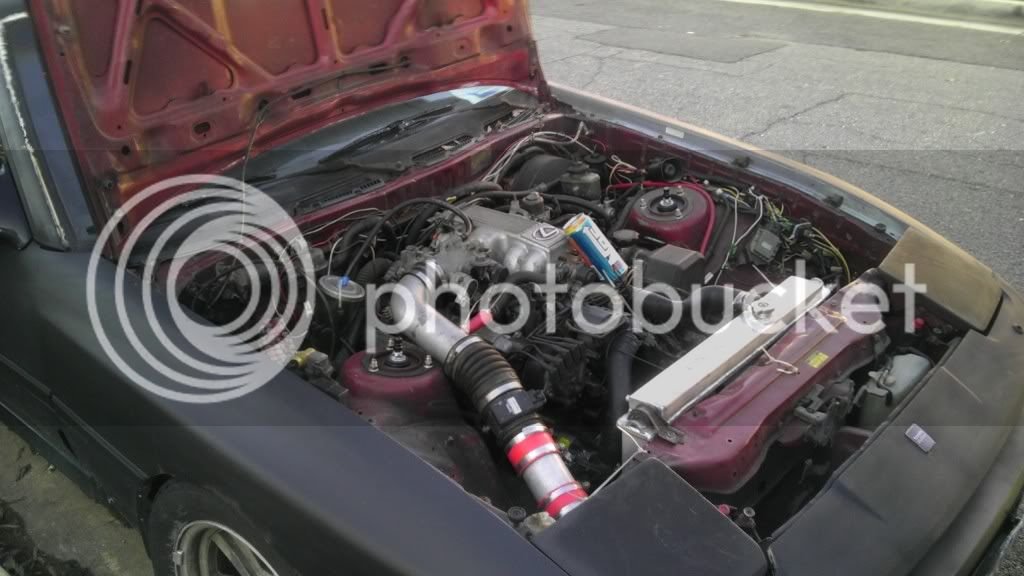

i know, its really my last resort.
ive been over the wiring a half dozen times in the last 2 weeks and i found that i was running a bunch of unnecessary wires and didnt have a lot of necessary grounds so i fixed that situation and it exposed a more serious idle problem. rechecked the wiring on it and its good, the iacv works it just dosent always catch the idle before it bottoms out like on deceleration (especially when coming to a stop)
however i decided to break out the timing light last night and check if the coils were firing properly and lo and behold the one on the drivers side made the light flicker out of time. and when i removed the plug lead the damn thing arced over itself from the mounting screws. i think this is the root of my problem so im installing a blaster2 coil i have laying around and ill see if this thing decides it wants to run right.
am i on the right track now?
