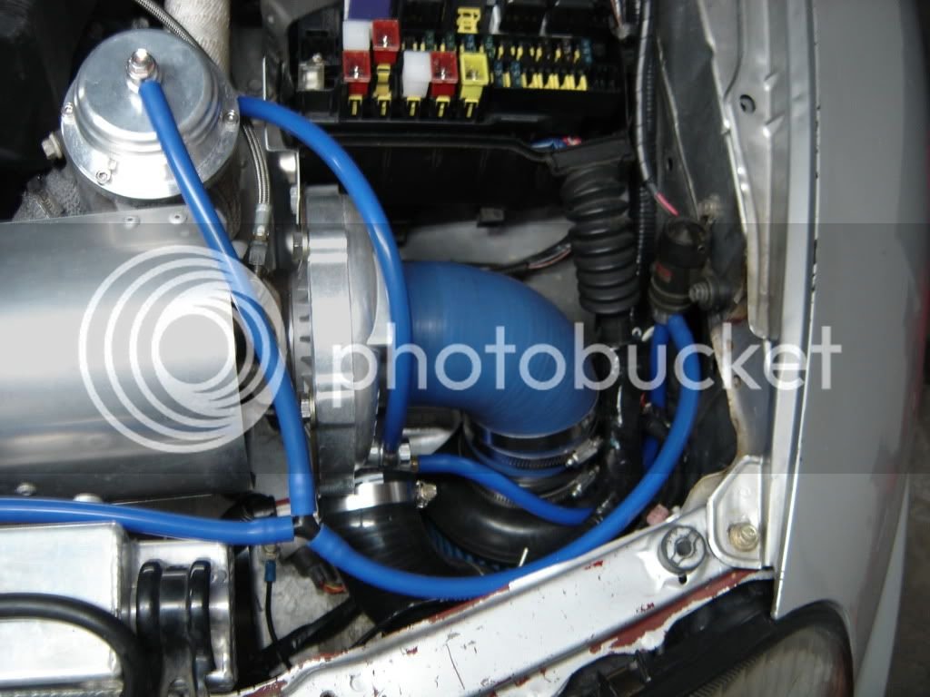

i have installed a subaru boost control solenoid and have made the mods to the megasquirt to control this solenoid.
i also have installed the 8 series 5 rx7 injectors.
these were bench flowed at 643cc/m so are more than capable of supplying me with my fuel needs, and some.

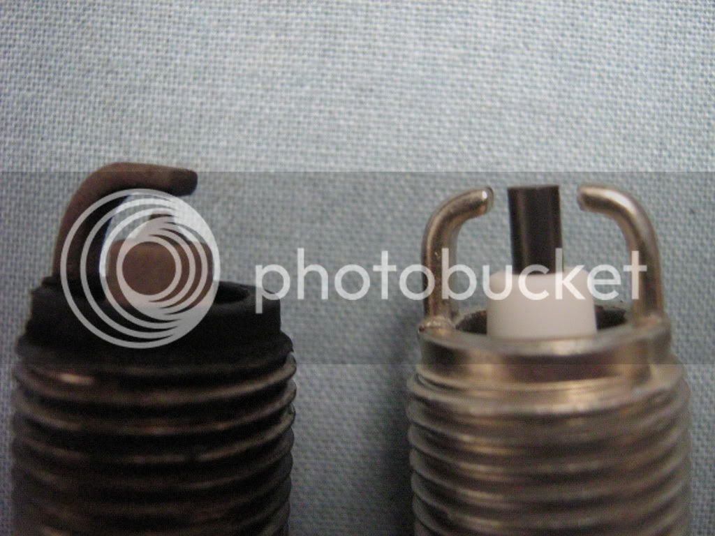

I have made a spark plug selection:
K20TR11 denso
these are a non platinum version of the post 97 2JZGTE plug
and are CHEEEEEP $2.50 from the local toyota dealer, so i bought 16 of them.....
they say normal plugs do about 30Ks so at my current mileage rate of 2000km per year i think these are very cost effective.
Ill pull a plug out today and see how it has faired from the quik belt around the block on 15psi

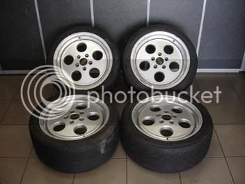

have also found some rims top replace my battered old TSW's
they are at a local wrecker
ive yet to purchase these but they are OZ racing Strosek wheel's
17x8.5 and 17x10
I think i will gloss black the center's and re-polish the outers.
i will finally be able to properly fill the enormous rear wheel arches that my supra has...
