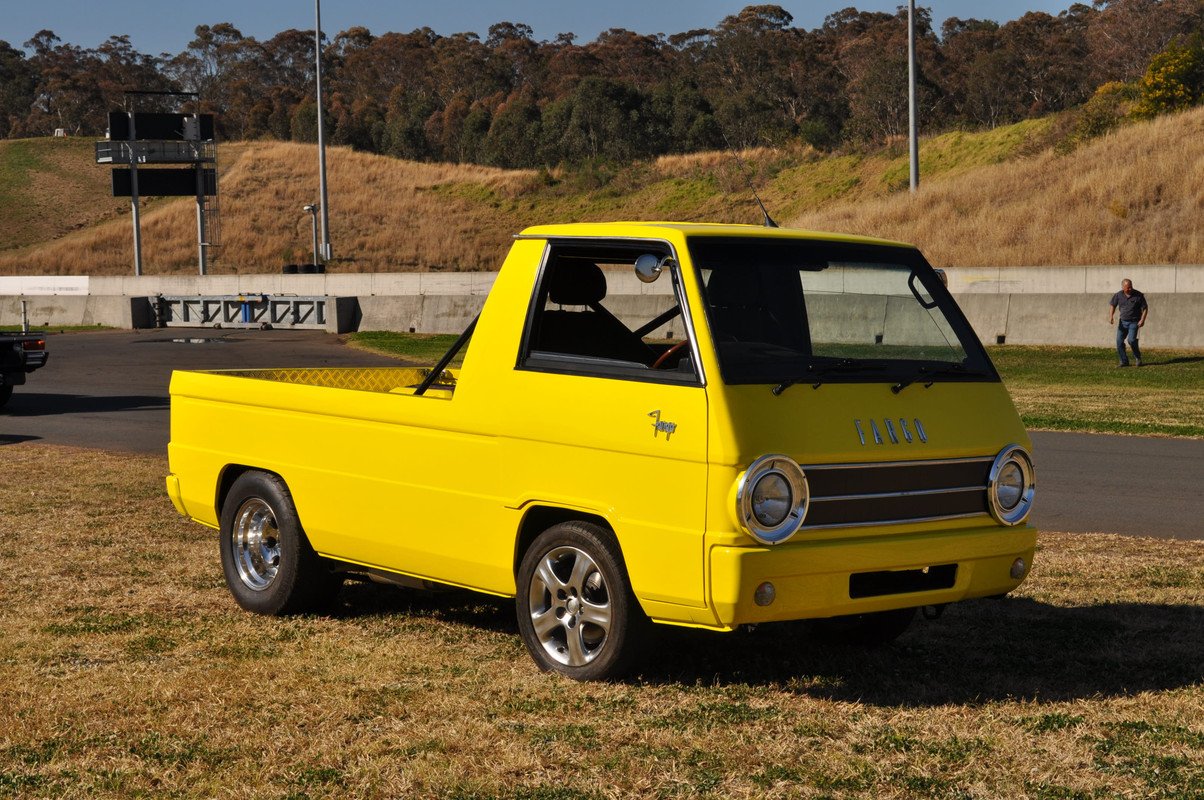

I have the same series L300 van cut down into a pick-up and fitted with an LS3 and 6speed auto.
It can get the front end off the ground on the street.
Scariest thing I've ever driven, but love it.

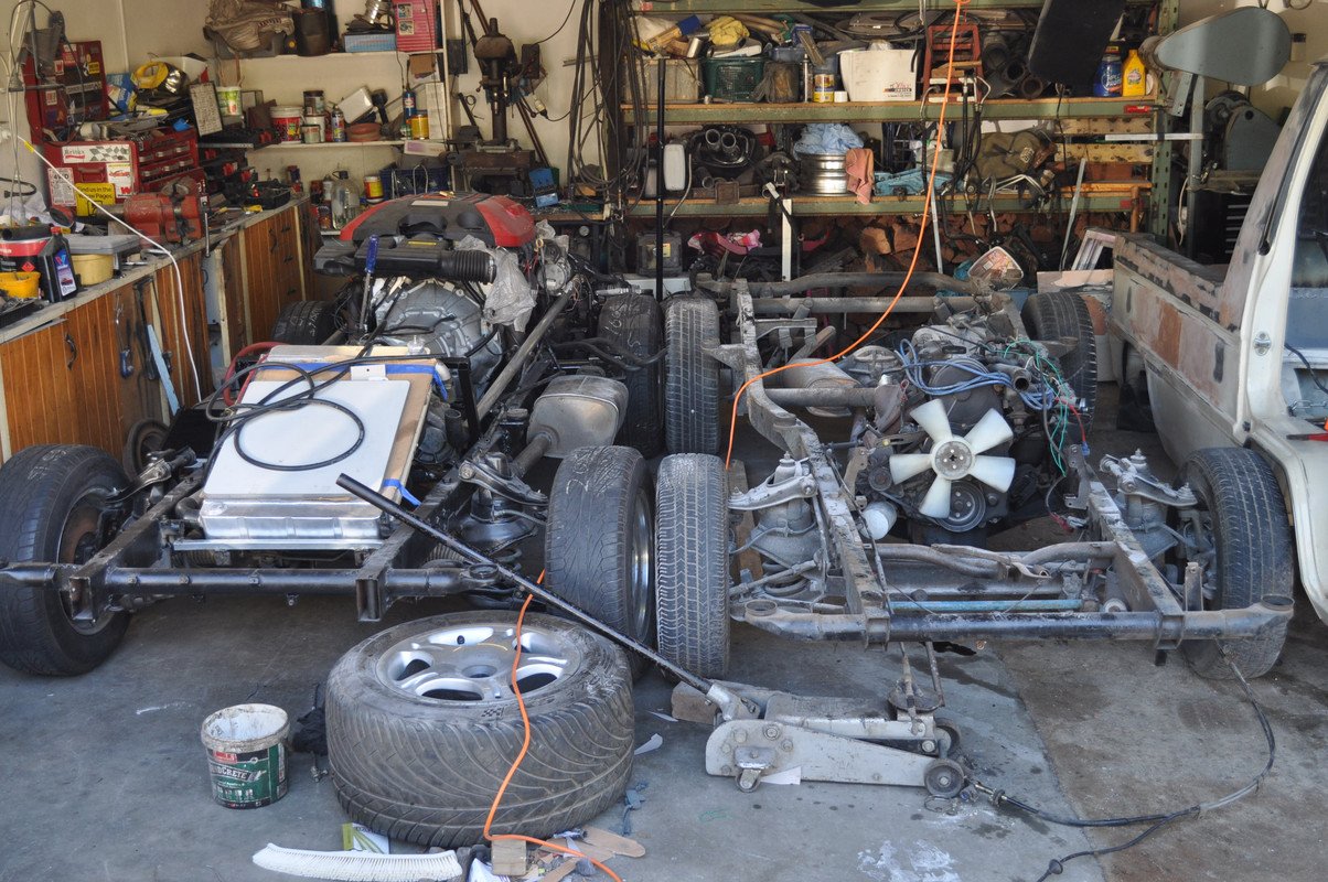

Here are the modified chassis I used plus a standard chassis and the body all jammed in my 2 car garage.

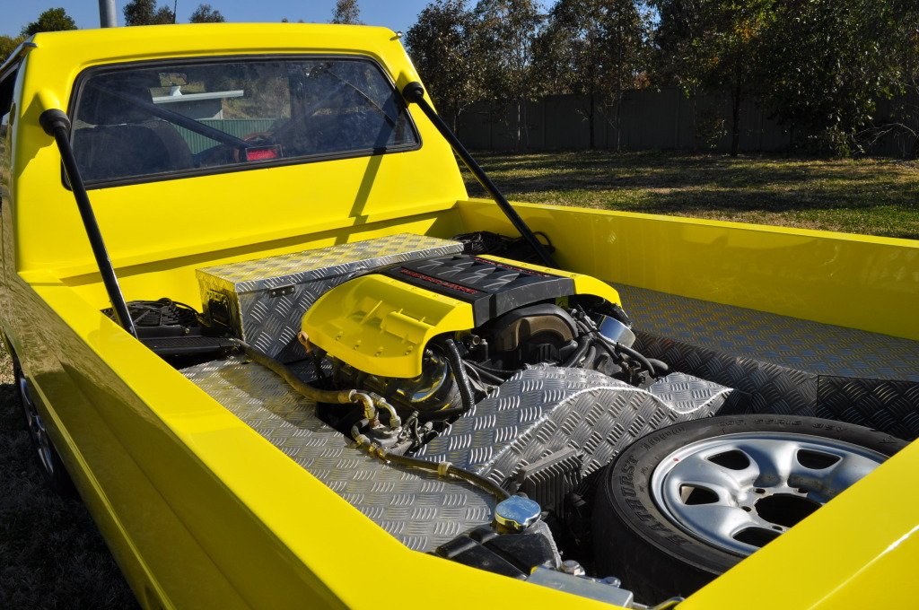

This is what it turned into.
And the business end.
The engine probably can fit in the existing engine bay but I just wanted it out the back.

You may have noticed in the chassis photos the one on the left has straight rails and the right they are waisted.
The left is after narrowing the rear half to fit my wheels and tyres under it.

The auto is adapted to a Nissan Patrol transfer case and I have it locked in Hi4x4 so the drive is taken off the front flange and passed back beside the engine to a heavily offset diff.
If you look at the first photo you can see the end of the transfer under the radiator.
