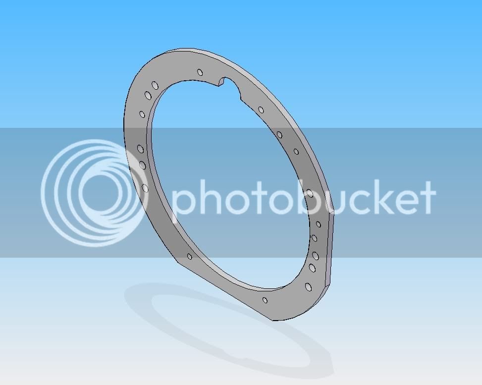

Here's a .jpg of part of the adapter plate system that was sent to me today.
Cowboy that plate adapter is $380 bucks? Man, I am about to bust out the jig saw, drill and bits and find me a thick slab to cut me out this plate, ha ha... A ruler, number 2 pencil and drafting board and I will be set.... No seriously I have been in touch with a two real good machinests here in the LA area whom one does these adapter makes for the porcshe's swaps. I remember he told me he can make just about any adapter plate as long as he has the blue prints and or plans for around $200 a peice on average. Bulk makes even less..
Cowboy, if you put this plate adapter make together and have invested alot of your time and have financial interest at stake I completely understand and you do not have to respond. However, if you have no interest I think maybe we should talk and save everyone a little cash on these adaptor plate makes. You can pm me if you want. Just trying to help out everyone....
If im not mistaken there are two plates. So by your guy jibby at 200 a pop it would be 400 for both plates.
Thanks for the heads up cowboy, i would have made an unnessesary mistake.
Got it, cool... Eric not sure if you can put a patent on a auto part of that nature, but it is worth a try because there maybe some copy cats out there....the plates sound nice and that they were really made to order, good job.....I may suggest to you to contact a few of the larger adapter making companies in the US to see if they would be interested in stocking these adaptors for re-sale. I saw two large companies off Google search but forgot their names, maybe one was called American Adaptors not sure. Just one call to the man and you could get paid, just a thought for you.
