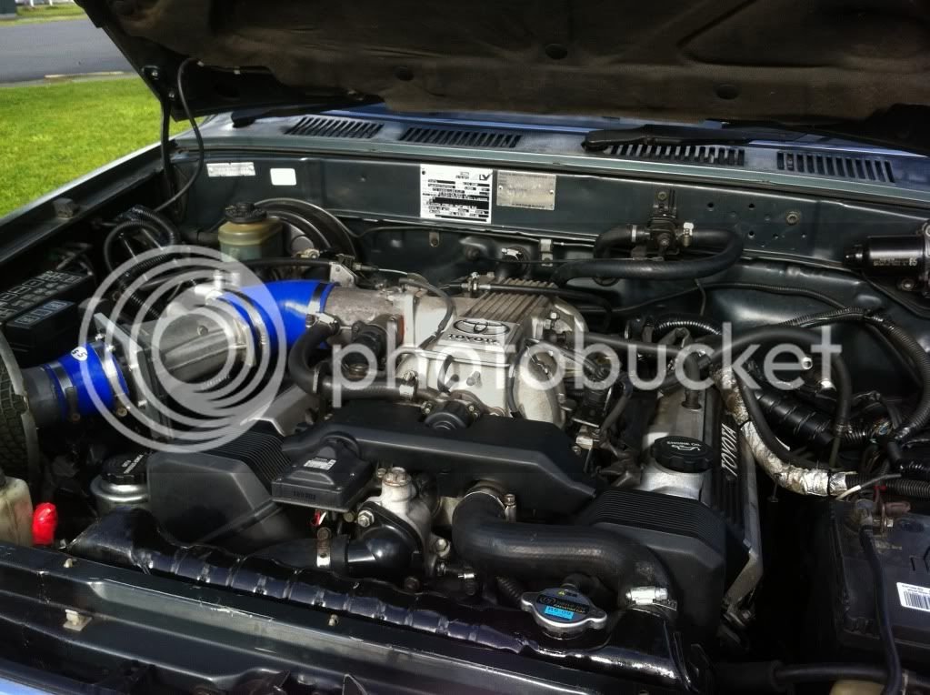

Hilux Surf LN130 1UZ-FE

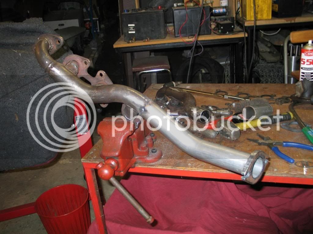

Making the Exhaust

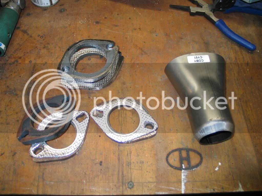

Using 2" from manifolds into collector, then 2.5" to muffler.

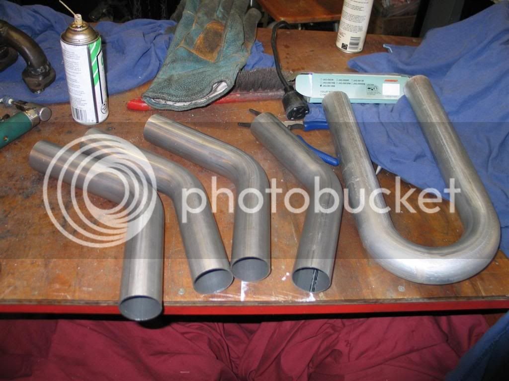

Bends

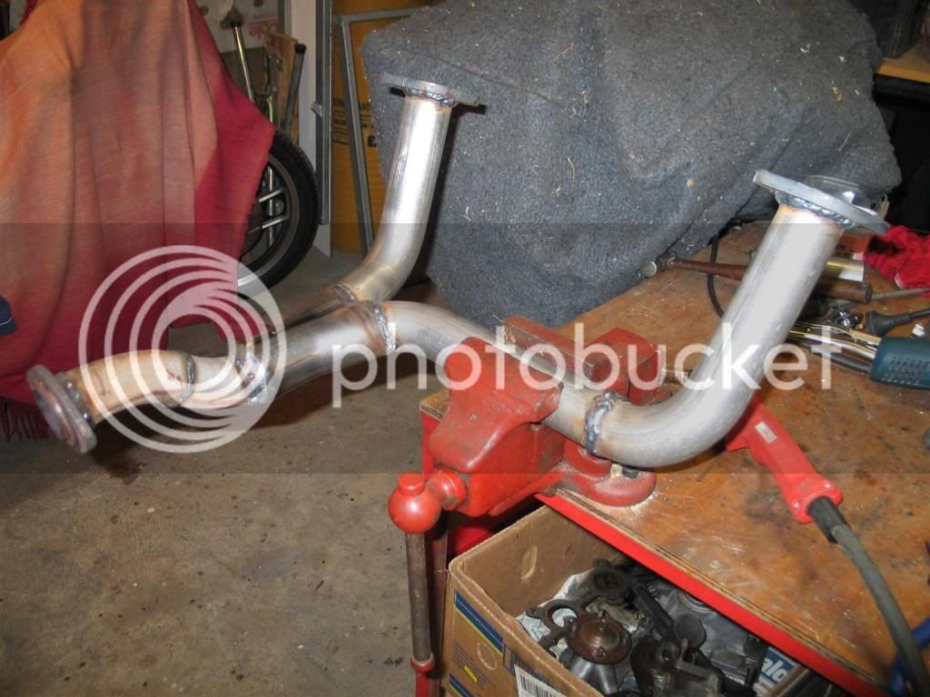

Flanges & Collector

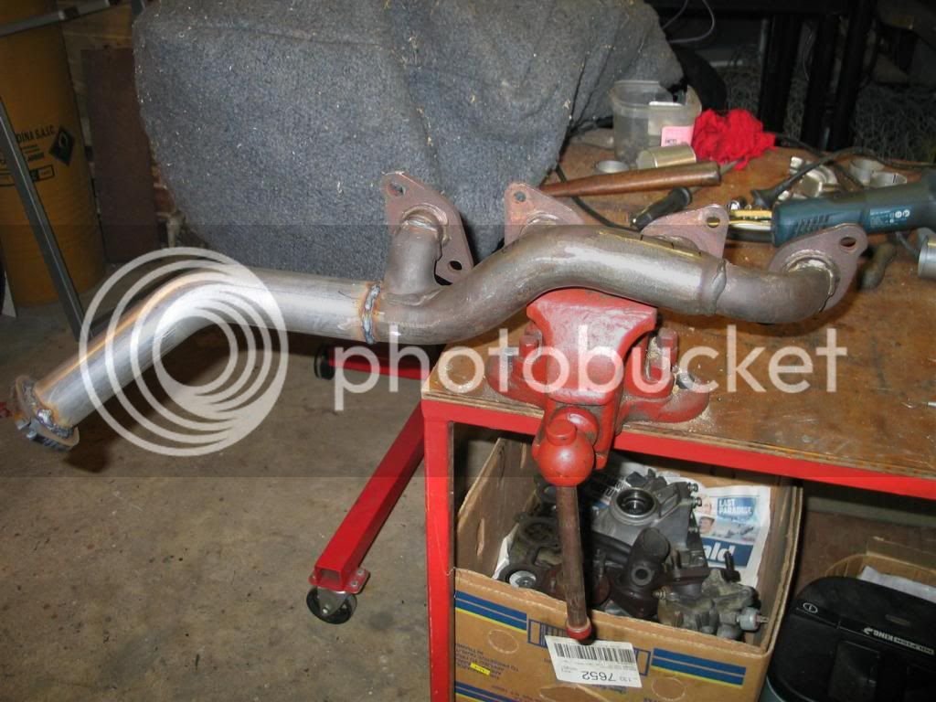

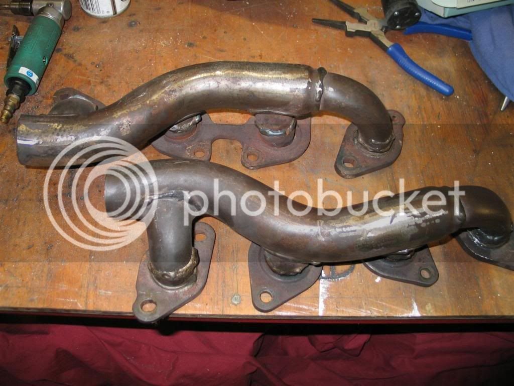

Original manifolds shortened. Die ground inside, very untidy from factory.
Right hand side
I've had one set of tri-Y extractors made to suit solid axle front suspension yet the supplier doesn't wish to put those into production. He does however wish to get my Surf off me and jig up a production run for 1/2UZ into IFS Surf/4runner/Hilux. Indicative cost of $800 AUD per set. This won't happen in a hurry as my Surf is a daily and good things come to those who wait

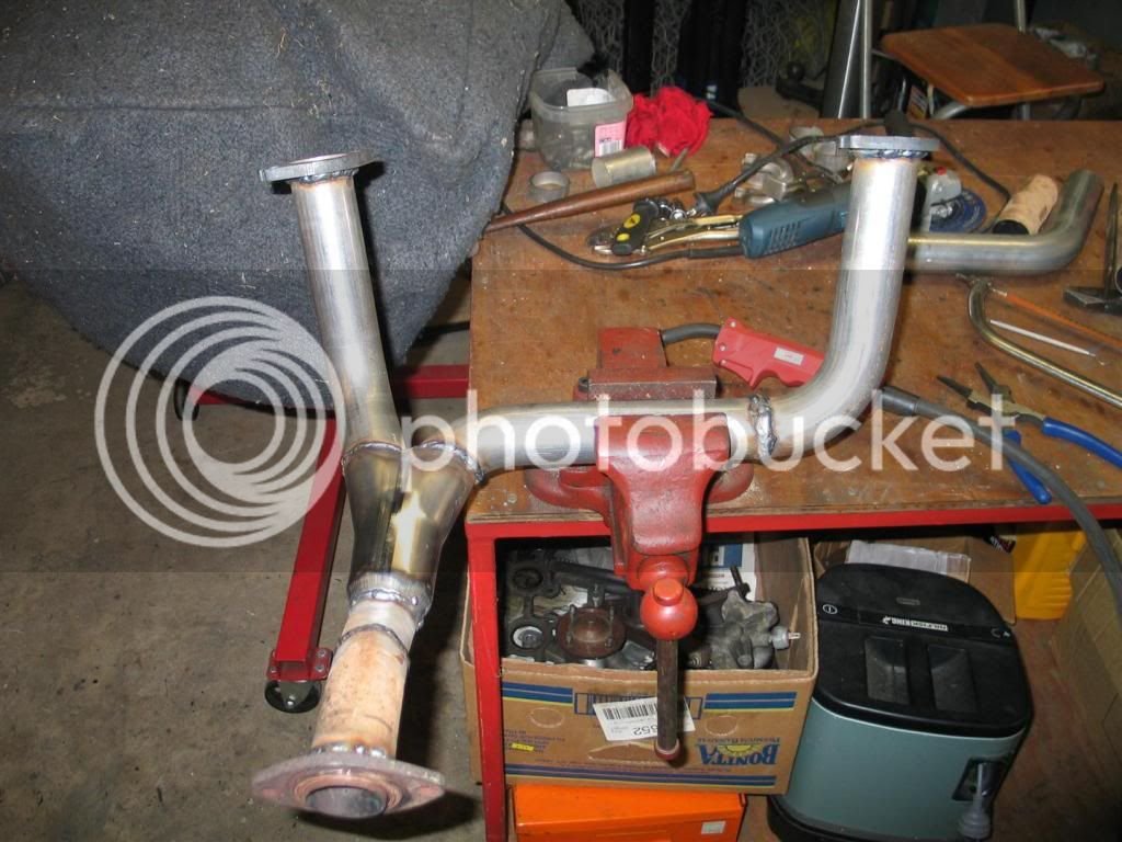

Exhaust done
Right hand header
Crossover pipe

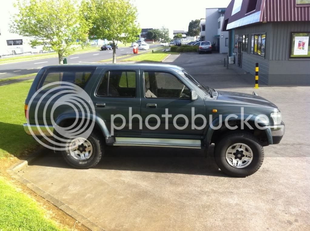

Truck Finished!
Project now finished and goes great. All fully certified, even the 2" body lift which requires certifying.
Now for sale on Trademe.
