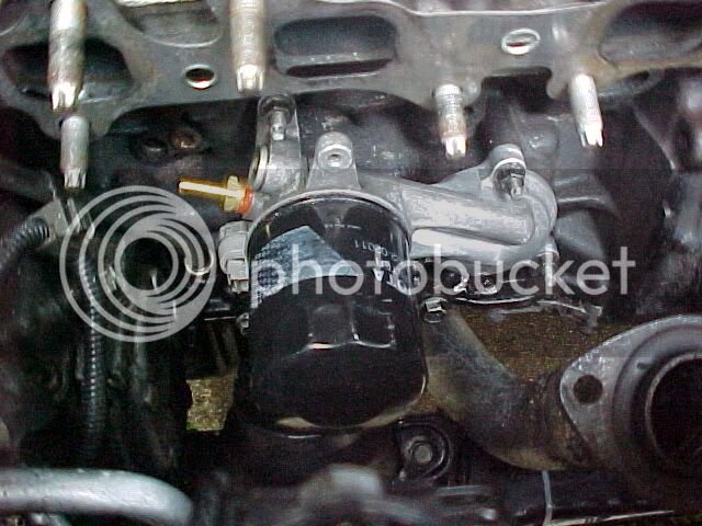

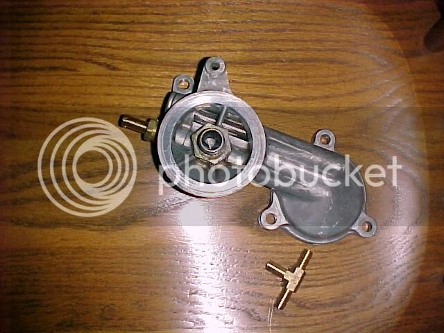

Dual water cooling the oil = kewl! Ya a stand off is the easiest way. Most Toyota blocks have an area of space around the oil filter, so routing lines is easier than from the side of a block (sometimes).
On the transverse v6's the front motor mount on some models is exactly where the oil filter goes, so Toyota puts an aluminum oil filter standoff. The ends of it are plugged & tapped, giving us 3 places to tap oil. =)
What I've been doing for the last good bit is cutting them in half with the sawzall, grinding the sharp edges off (sharp edges suck) then tapping them for whatever fittings. Basically free remote oil setup & then you really can tap as much oil as you want.
