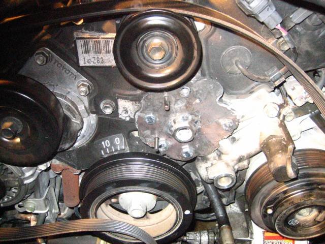

Anyway, i finished up today, i decided to weld a nut onto my plate then put a bolt to it.  I ran into one problem at the end though, i didnt weld my nut on straight! arggg..... when i first welded it, i tacked one side, then the other, just like you are supposed to in order to prevent heat distortion.  Well, when i was half way around the nut, i noticed that my second tack weld didnt penetrate the sheet metal at all, i didnt think anything of it at the time.... i was wrong...

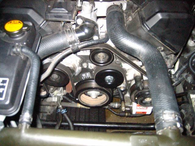

Mine looks a lot like yours steve! Now that i now the specs for where i want the pulley in reference to the plate, distance and up and down, back and forth, im toying with the idea of making myself a CNC aluminum one with countersunk screws and all... would anybody be interested in this when i make mine?  It will be non profit, ill do it as a favor.
