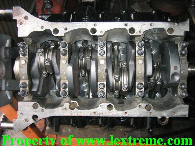

I'm just hankering after building the most bastard hard 2UZ block, I'm interested in knowing specially how TRD converted it to 6 bolt mains.....
I would love to convert it they way they did, give it a crank girdle with built in mains caps and grout the bottom of the block then just boost the hell out of it and see what breaks...
What do you reckon? 2000bhp maybe?

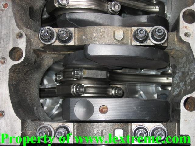

Here is the 4 bolt main conversion:
6 bolt main will be very hard. It was 4 bolt conversion:
http://www.turbomagazine.com/features/0210tur_import_drag_racing_toyota_celica/index.html
"The party started with a TRD custom-prepped 331 ci Toyota Tundra iForce V8 block. The block featured a reinforcing girdle and was converted from two-bolt mains to four-bolt mains in a most ingenious manner, ensuring rigidity. Robert Fulco of Fulco Race Engines was given the tall order of putting the engine together in a short amount of time. This buildup was much more than an "assemble and go" proposition. Time constraints and limited parts availability challenged Robert's considerable machining talents."
Here is what they used:
The core of the problem was compression ratio. The Tundra heads were trashed in favor of more performance-oriented Lexus GS400 heads that benefited from TRD's involvement in CART. This resulted in a static compression ratio of 10.06:1. Usually, a set of custom pistons and/or a thicker head gasket would solve the compression problem, but only a gasket was available. The gasket bought Robert 9cc of the 18ccs he would need to attain the target ratio of 8.0:1. The remaining 9cc would be hard earned indeed. The engine was designed to be bored and stroked from 4.7 liters of displacement to 5.3 liters. While Ross Racing Pistons could have made another set of custom slugs, time was against this method. The next logical option was to dish the existing Ross pistons.
On an engine dyno, the hybrid V8 was off the chain, generating a wicked 1,260 hp at its 20 psi low-boost setting. At the engine's highest competition boost of 35 psi, Turbonetics has calculated engine flywheel power with datalogging info to be a mind-altering 1600-plus (and we mean Plus) hp
