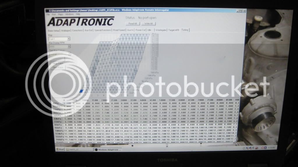

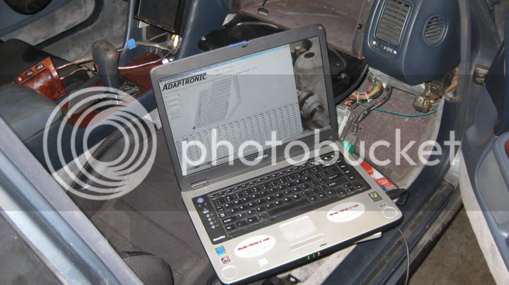

My Hybrid 4.7 is fully wired up and ready for it's first start. All wires soldered and my laptop is installed with the software and base map. I am having trouble getting a connection from the E420c to the laptop. I use a serial-to-USB cable and I get a message from Windows saying I need drivers for serial/USB connections but I keep thinking i'm going about this wrong. I load the software from the base map and I get pre-loaded specs for a supercharged 1uz and it seems pretty close but I keep seeing "no com port detected", even tho the box lights up like a x-mas tree when I put the ignition to "ON". My builder is old school and isn;t a computer know it all and told me I needed to be connected to the internet for a connection to be made, but I know thats bogus. Also, once the specs are entered into the software and saved, will the comp display real time as soon as I turn the car over?

Some of those Serial to USB converters haven't worked with the AEM ECU's, so it's probably a combination of the serial to USB converter, and XP.
You may have to try a few of these converters. The Radio Shack ones are supposed to work OK, as do the IO Gear ones, but stay away from the Belkin's.
Or find an old laptop with a true serial port.
This is coming from more than one AEM tuner, so it's probably fairly reliable.
Thanks Cribbj.
I almost went out and bought another cable just because I thought I threw the driver CD away... only to find it never came with one! I think I can figure it out as all USB is plug and play. I just need to dig into device manager a little more. I'll let ya know how it goes...
Are old laptops that have old school serial ports fast enough to run the WARI software? The softare was only a couple megabytes... I'm sure I can find an old one for under $100 and wont need to spend that much on cables, $35/each is high for such old tech, wonder why ECU's even use them? Why not USB 2 or firewire, much faster transfer speeds.
I still keep an old PIII Dell Inspiron that I bought in 2000 just for running the AEM tuning software. It's useless for anything else because it's so slow, but it does have a "real" serial port, and it runs the AEM software just fine.
When/if I upgrade my AEM and sell the old one, I'll throw the laptop in too!
That's what I wish I had, I managed to sort my issue out a few hours ago by installing serial-to-USB drivers. I got so stoked to see the box light up and see the comp load up. I find it hilarious that a cutting edge ECU uses an interface that was killed almost 10 years ago. I suppose it was engineered back then but c'mon guys! How hard can it be to upgrade to a USB II or firewire connection? I doubt the transfer speed is necessary but in all fairness I just spent $40 w/ tax for this convertor box. I'm all done whining tho, it does what it's supposed to :)

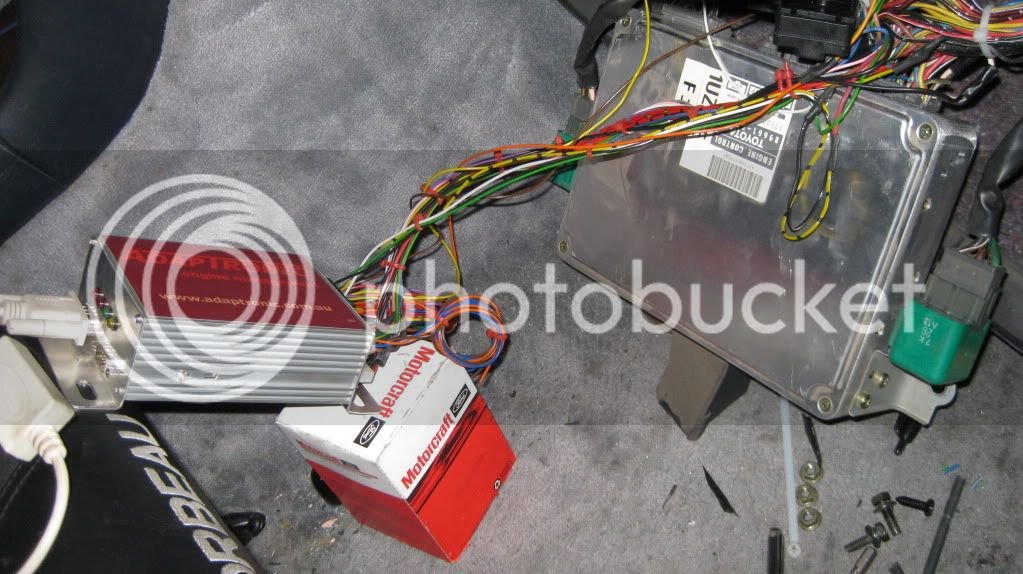

Ok getting fed up with the little tidbits that need to be sorted out to make this baby breath but I think I got the jist of it.

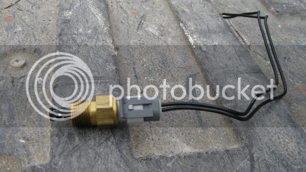

The car was not turning over because since I have my stock ECU linked to the adaptronic I need the stock one to still read the removed MAF sensor. My builder and I both missed the part where a 1k and 2k resistor was used in it's plug, so every time I try and fire it up it's getting fuel (I.E. mad fuel smell!) but no air to even it out. Now that the resistors are placed I needed a GM IAT (Inler Air Temp) sensor and a GM pigtail to suit. I went to NAPA and they had both of these items in stock, and if anyone is looking for the right numbers here ya go:
GM IAT Sensor #25036751
GM IAT Sensor Pigtail #121026

Tomorrow i'm fitting the IAT and the regulator is in the mail until Monday.
