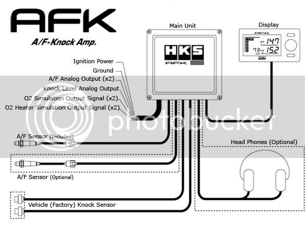

Since the autronic is sorta my plan B, I found another nice little doodad thats horribly over priced but sweet. The HKS or (HK$) AFK unit caught my eye. I know HKS is the rich boy brand but they also make some great products. This product is basically just a wideband solution with added knock support. Instead of the standard gauge it comes with a 4'' color screen that displays serparate readouts for each bank. It even has a headphone input for testing for knock and has an audible warning system if knock occurs. The unit costs $750 and more than that when if the 2nd sensor is used but if I land a small fortune i'm buyin' this baby! here's the layout:
Saw a GS rocking one of these and mounted his by capping off his driver front AC vent and it fit the space perfectly.
