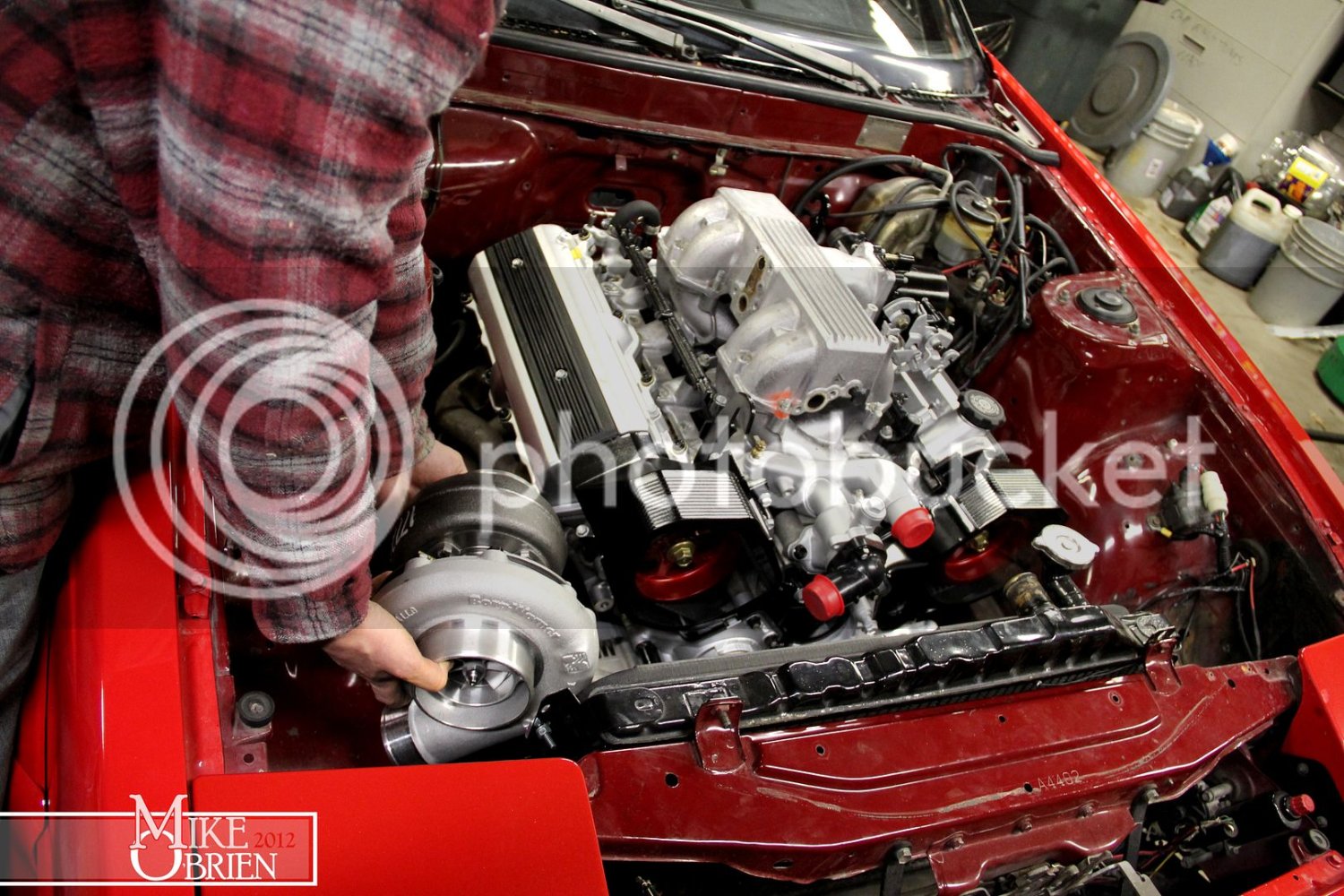

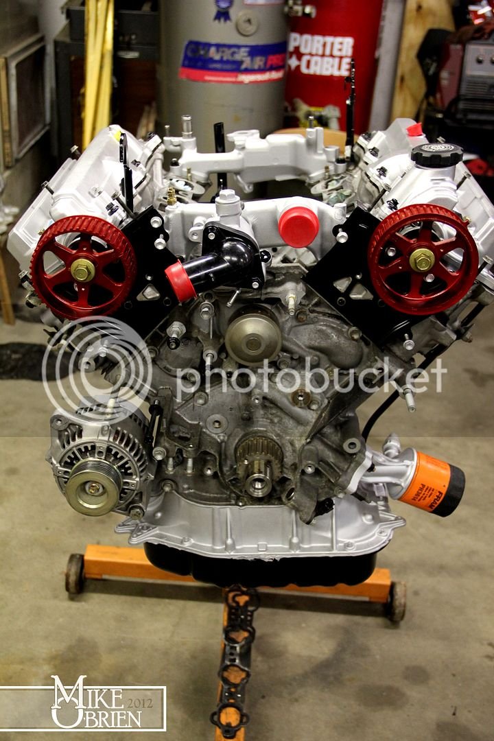

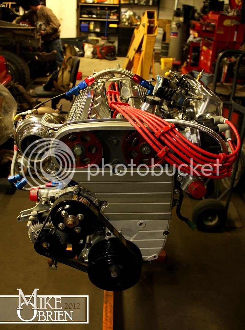

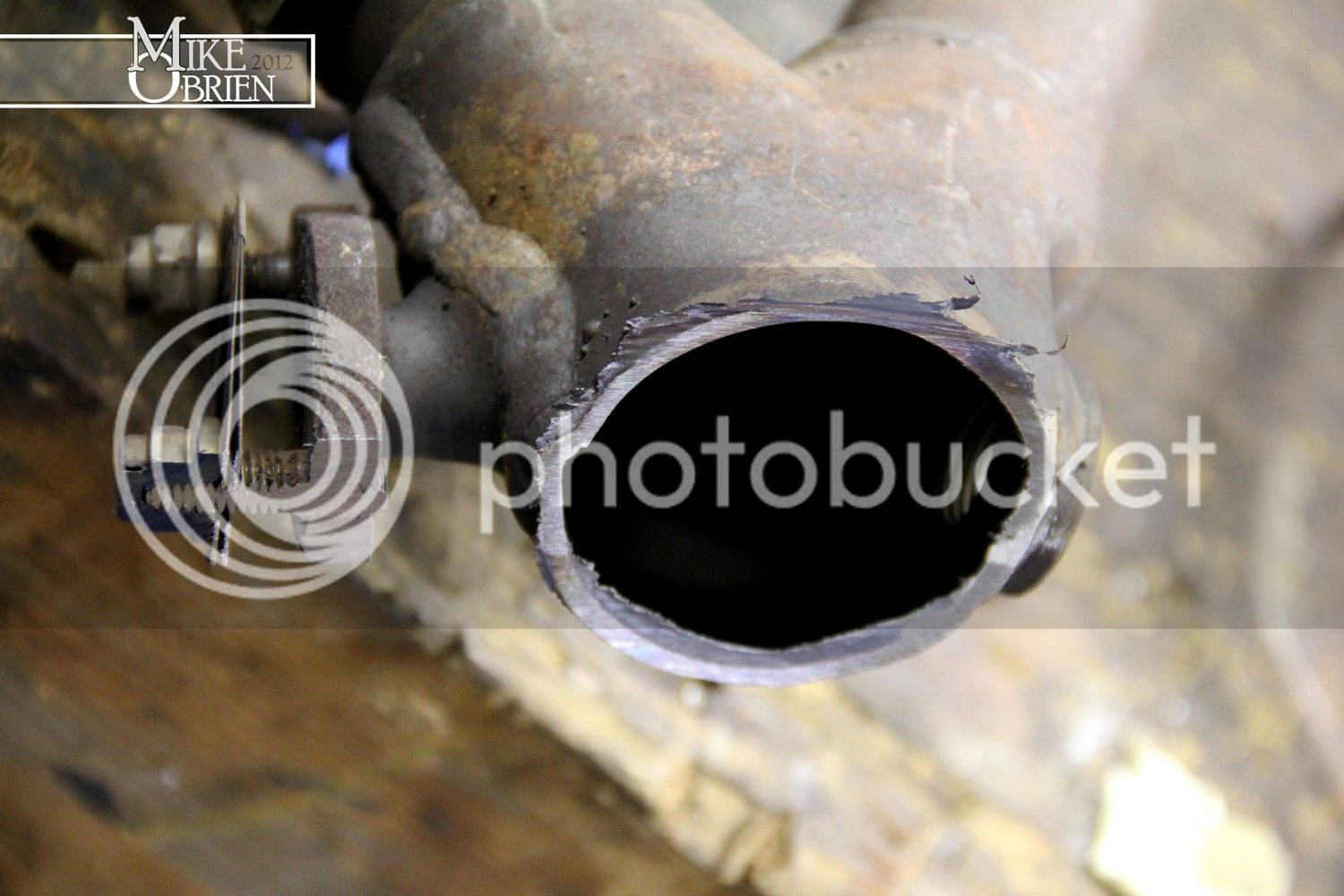

I pulled my old motor, which had alot of custom fab and parts done by myself:
![IMG_8488.jpg IMG_8488.jpg](https://www.lextreme.com/forums/data/attachments/20/20460-f0162acfe216581ad74e704c5b12d5b1.jpg?hash=8BYqz-IWWB)
![IMG_8453.jpg IMG_8453.jpg](https://www.lextreme.com/forums/data/attachments/20/20461-1193f0e77c69f0327a49daead3486616.jpg?hash=EZPw53xp8D)
I was running Megasquirt II with 7M 440cc injectors, ct461 (61mm) hybrid turbo, and tons of other goodies. It made good power and noises, but I felt the need for something with a more responsive torque curve and better parts availability.

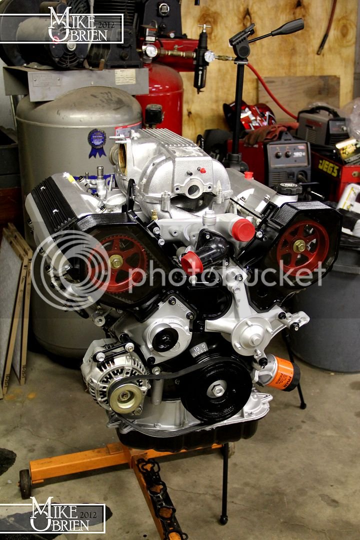

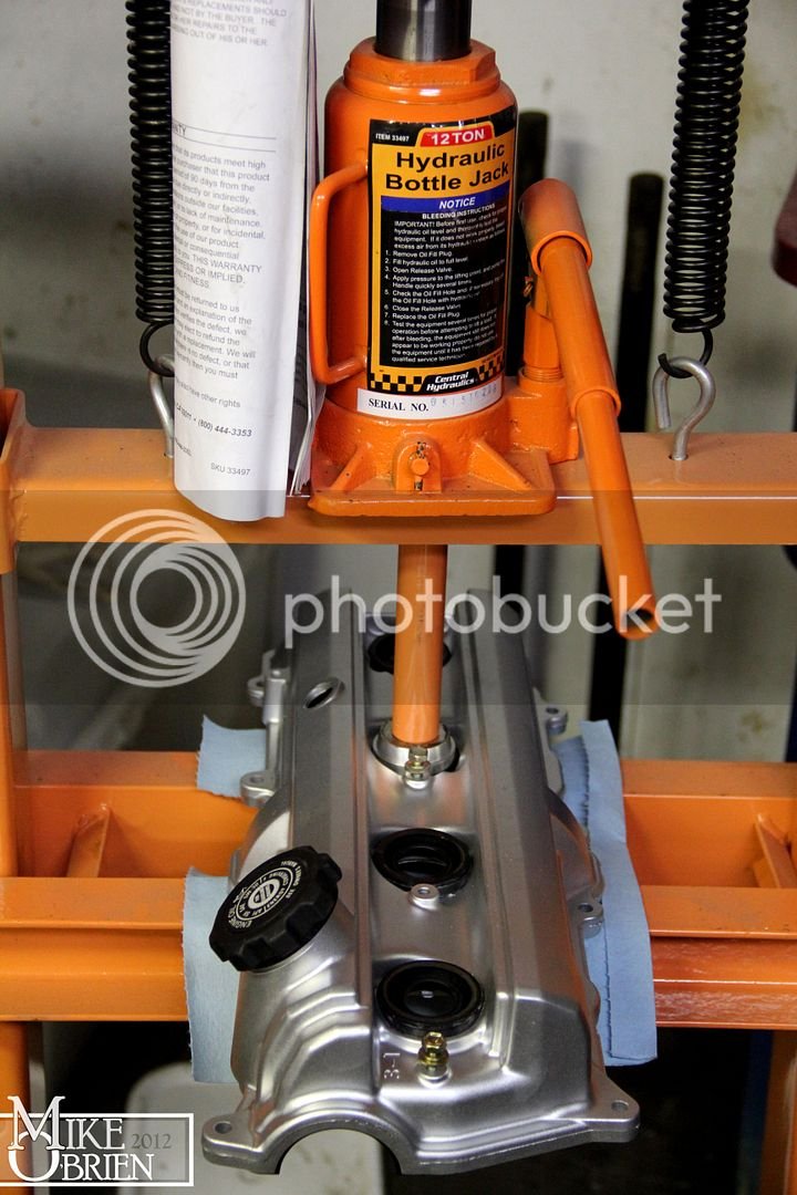

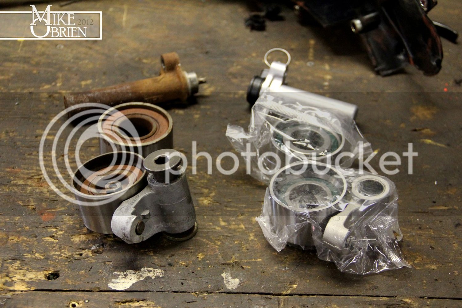

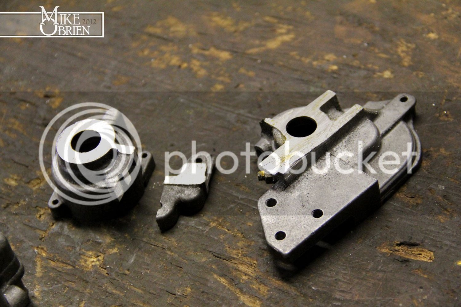

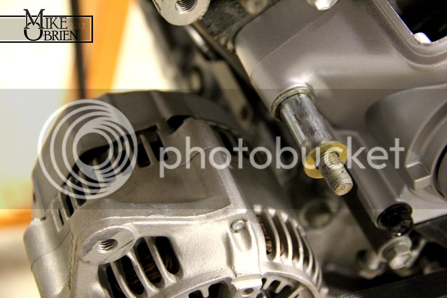

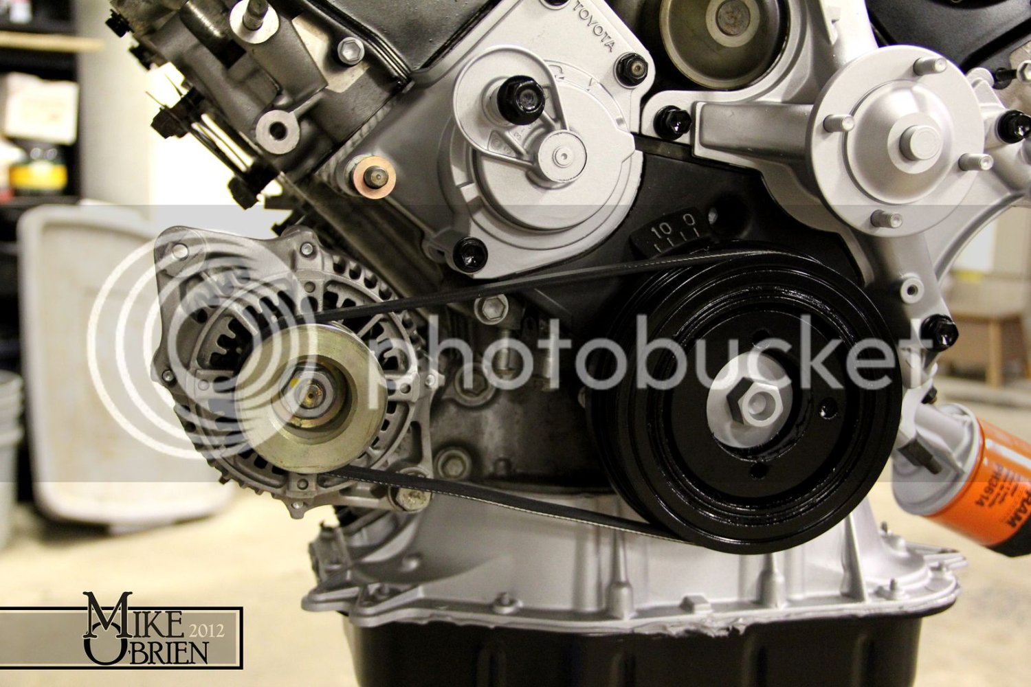

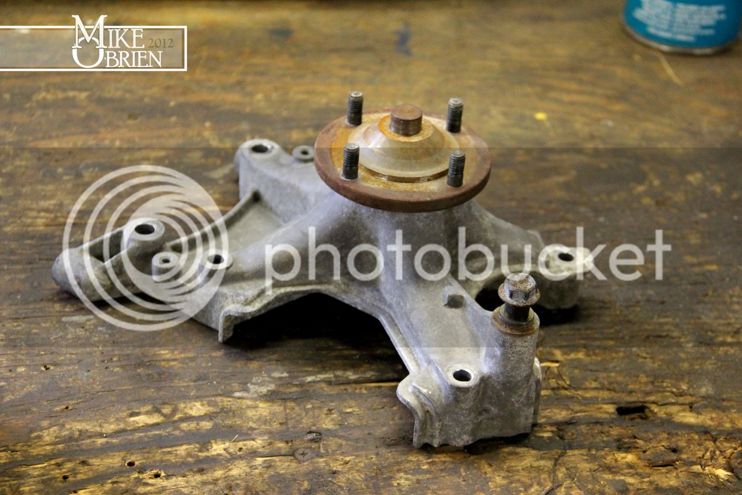

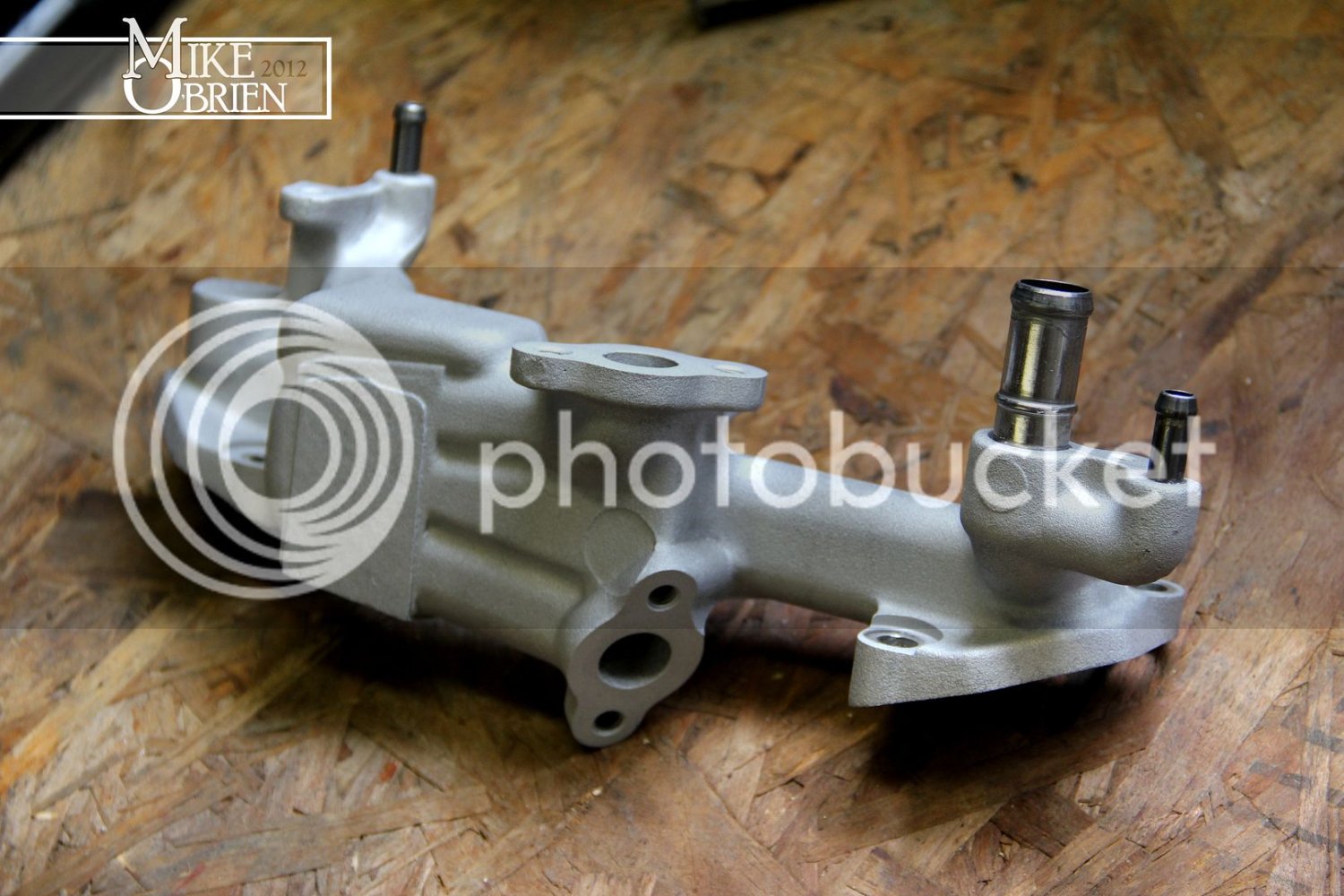

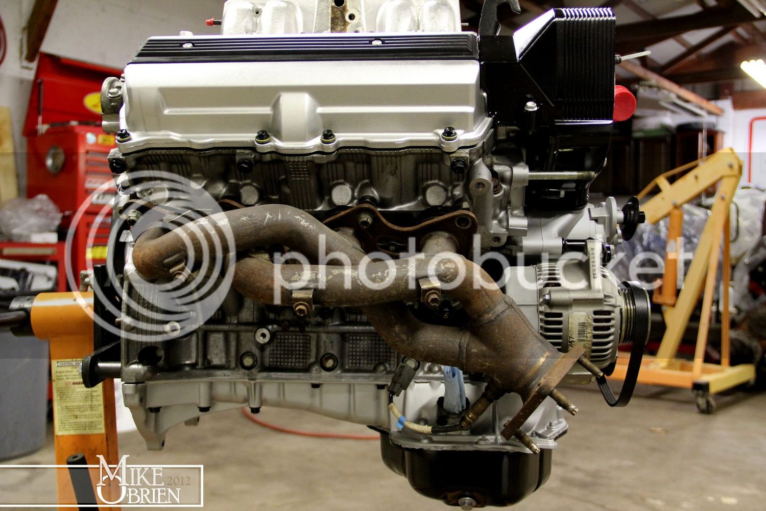

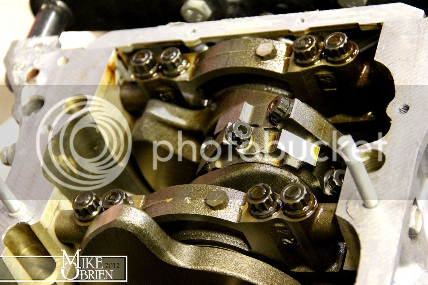

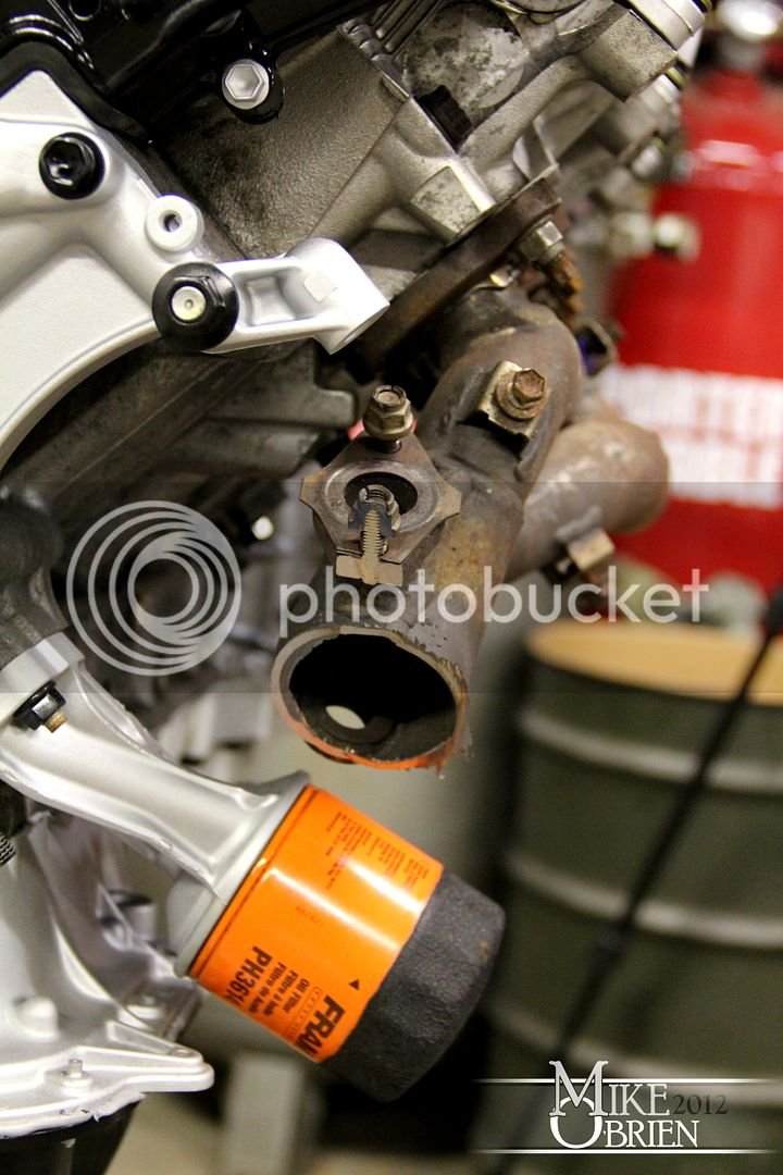

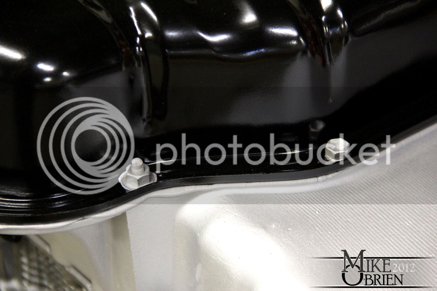

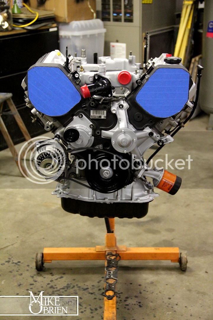

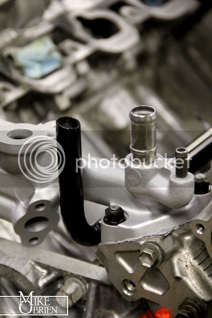

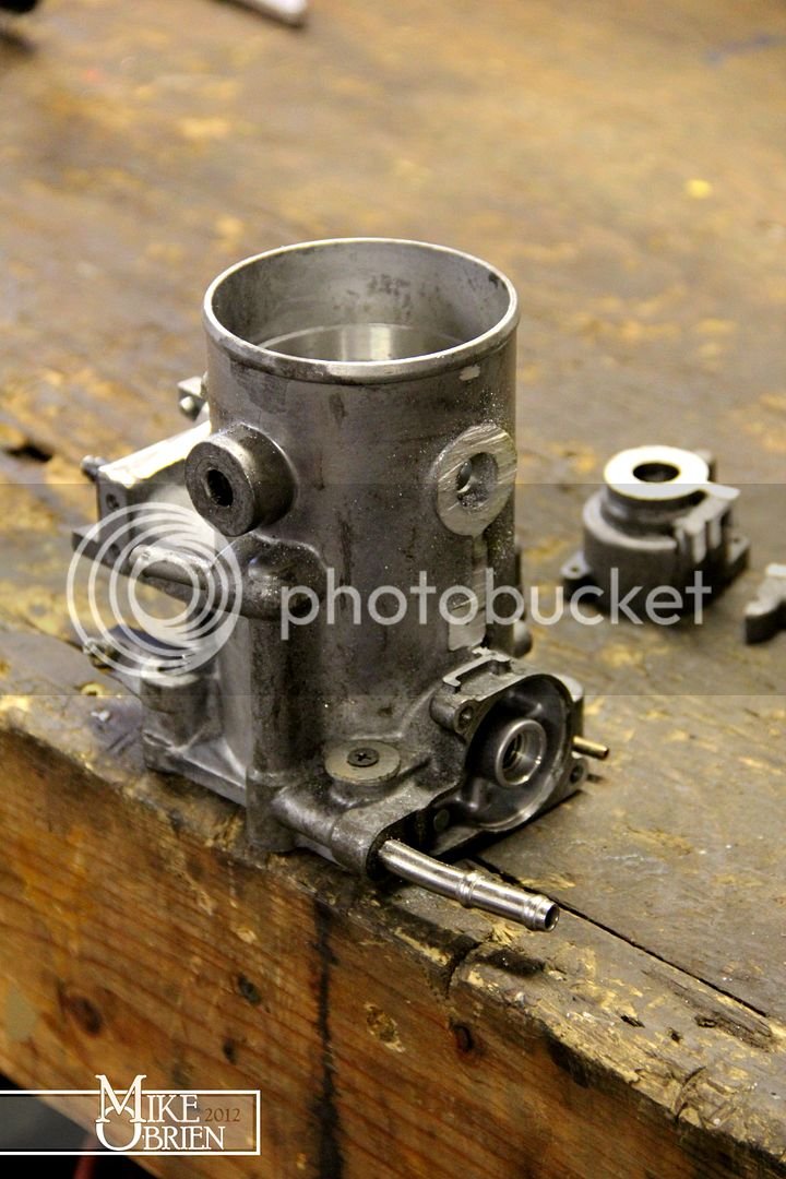

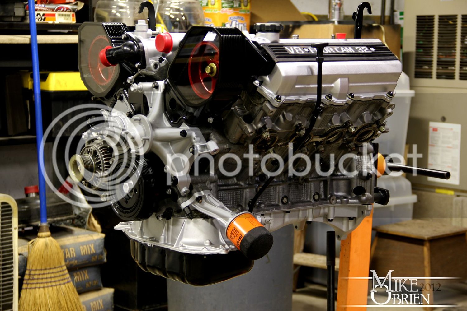

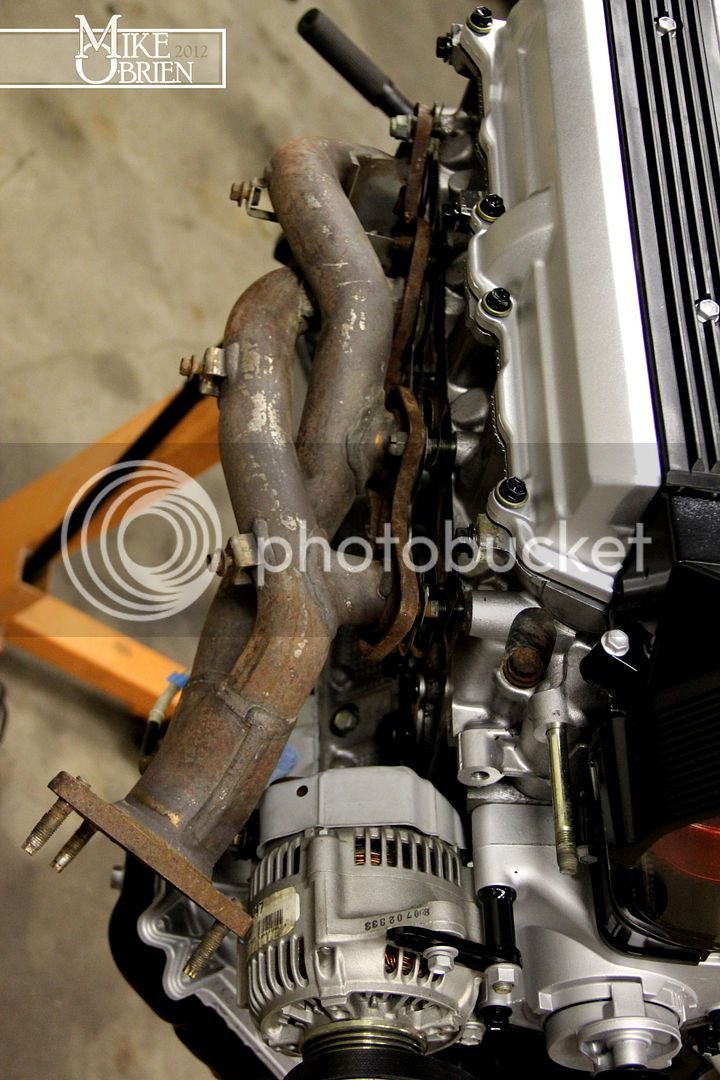

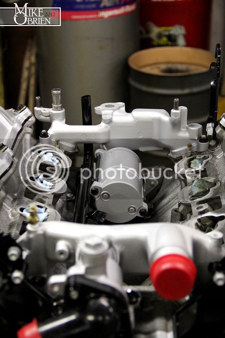

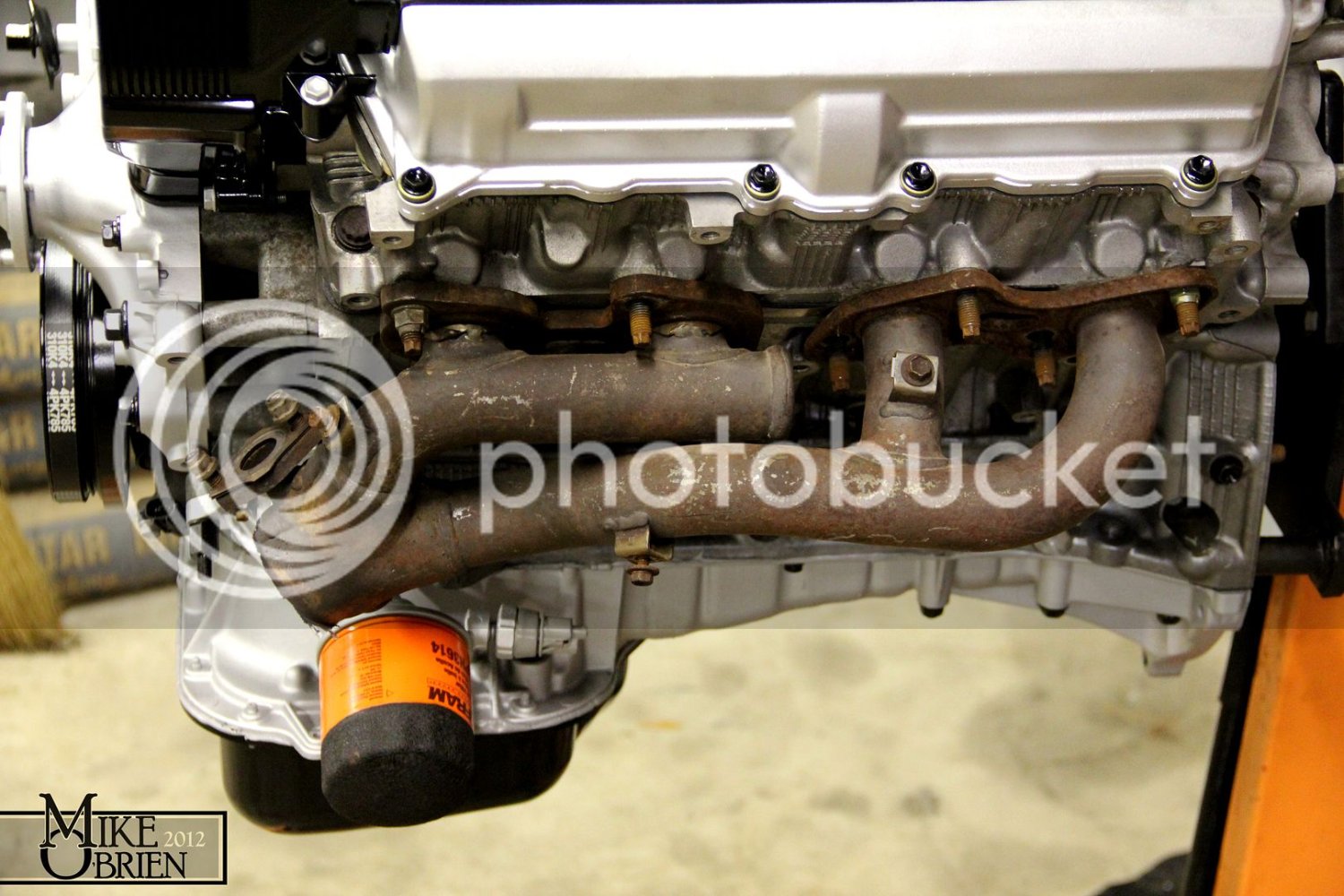

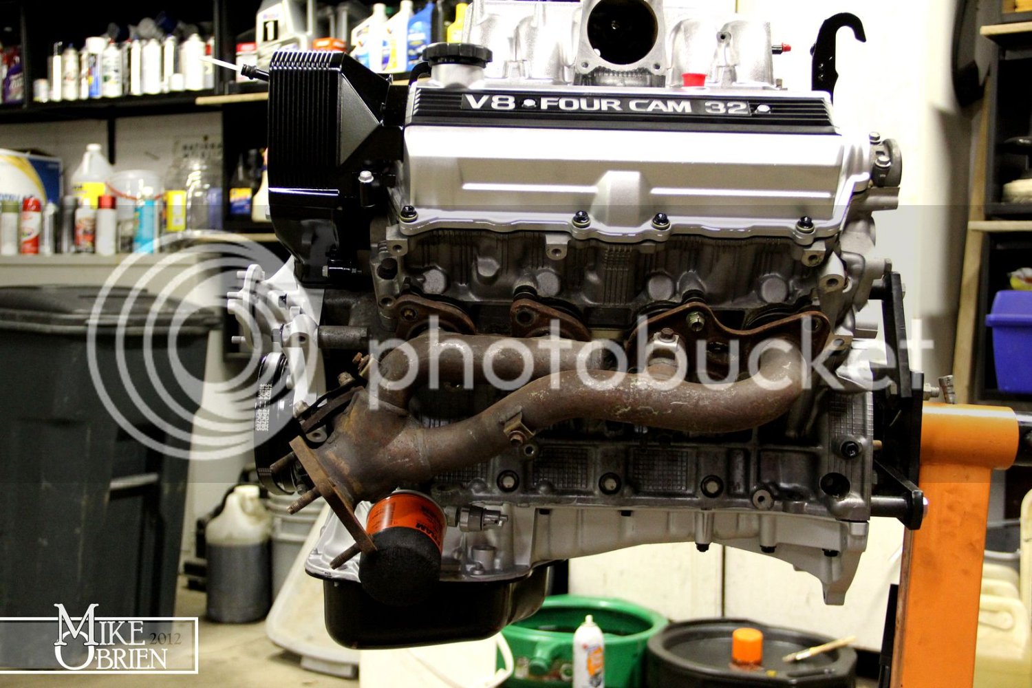

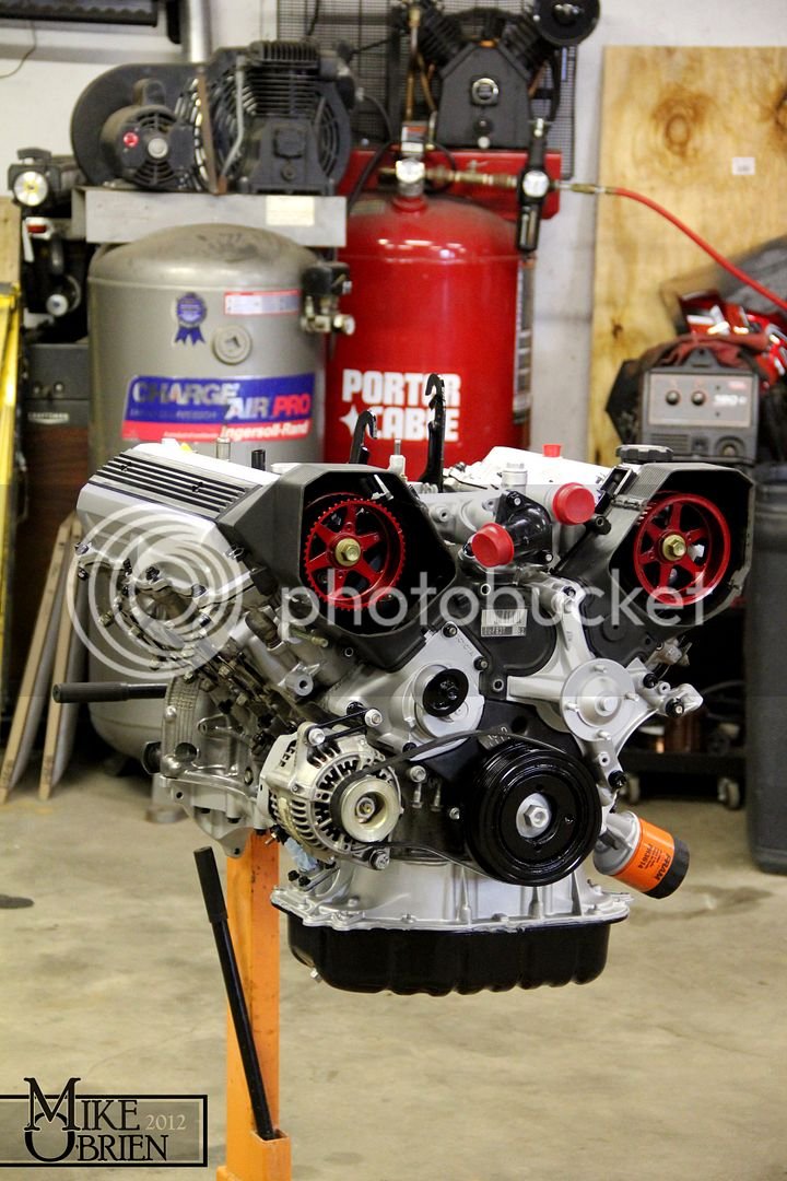

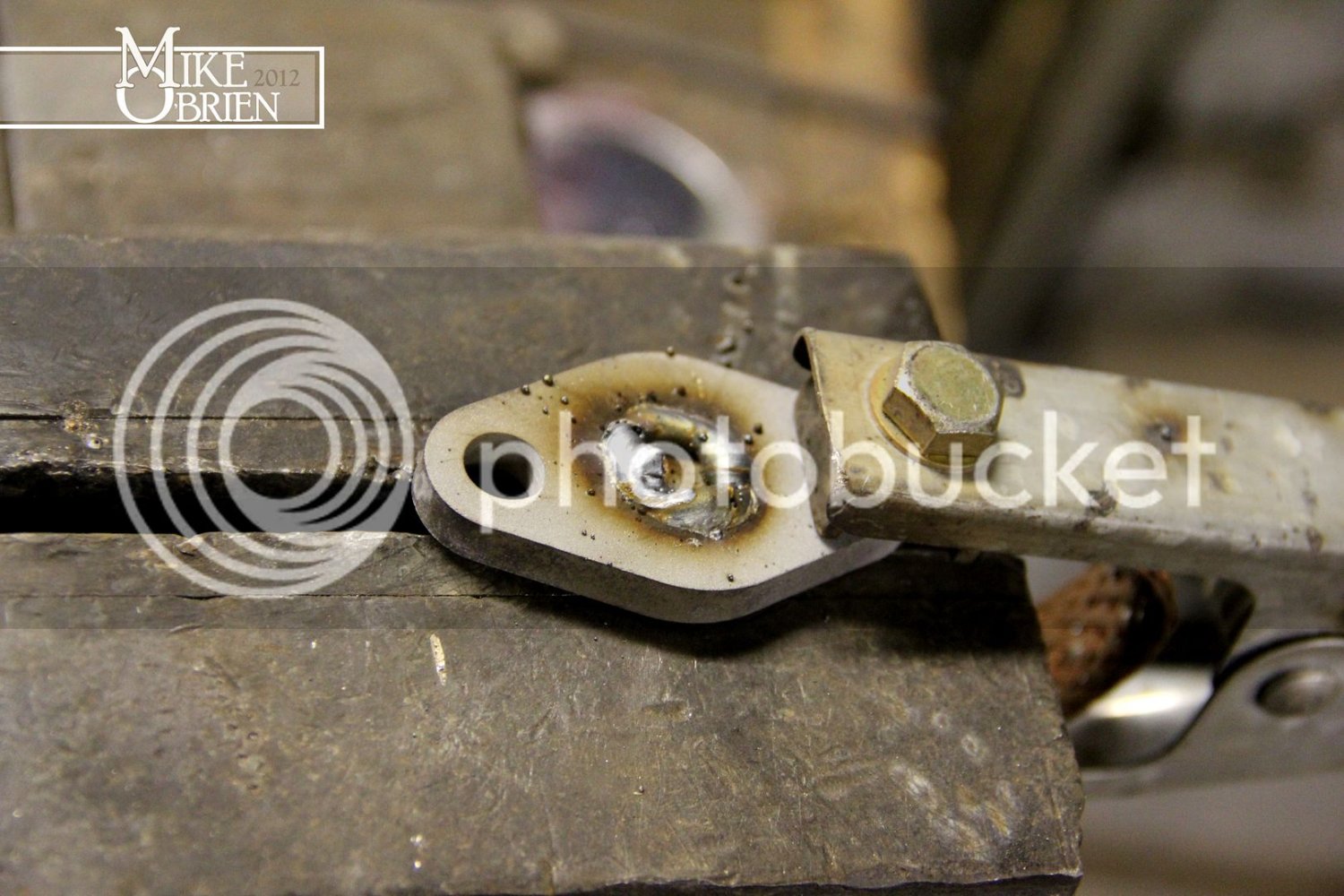

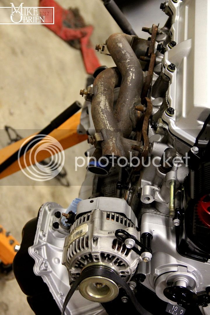

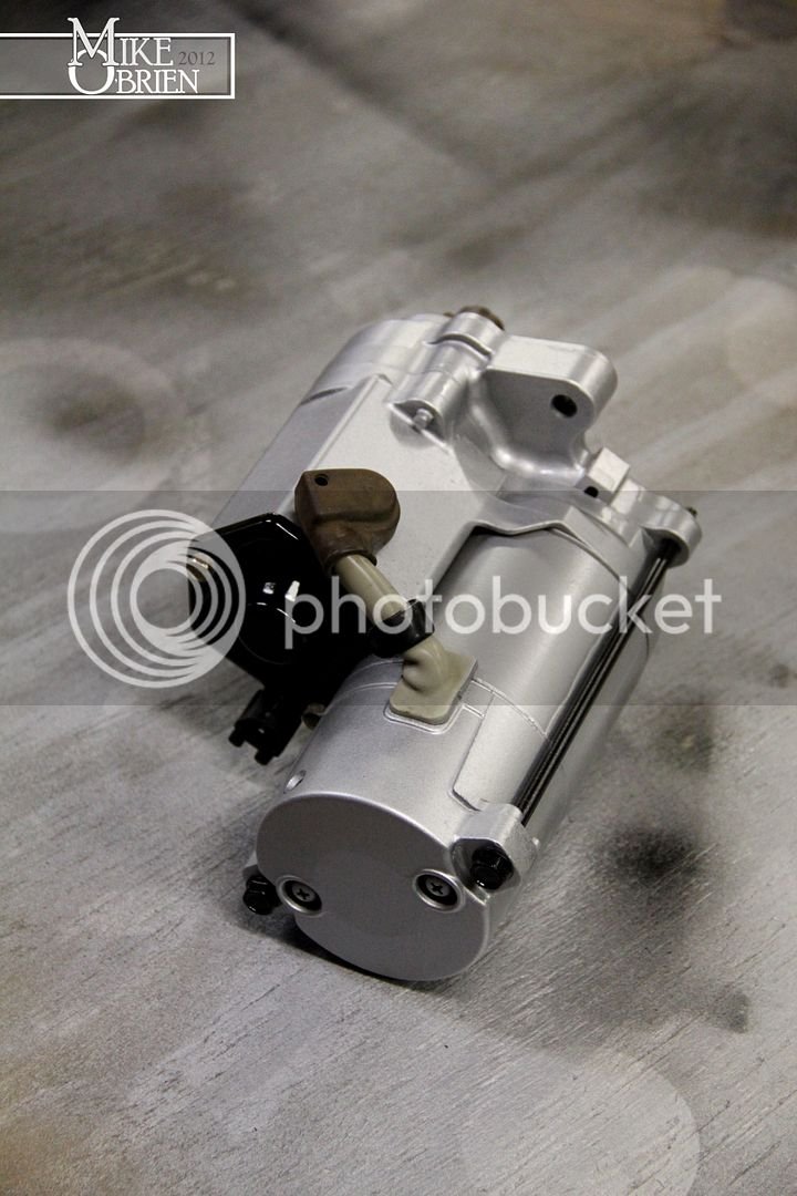

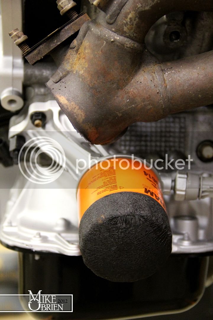

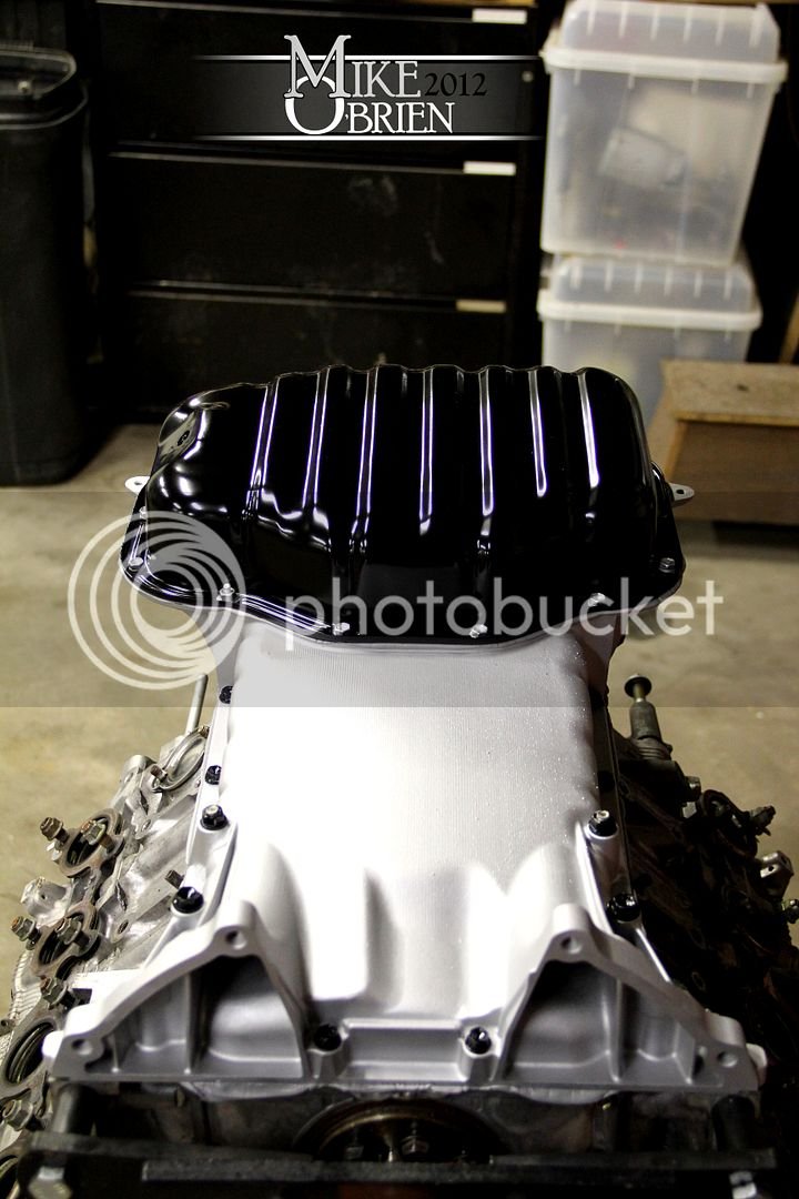

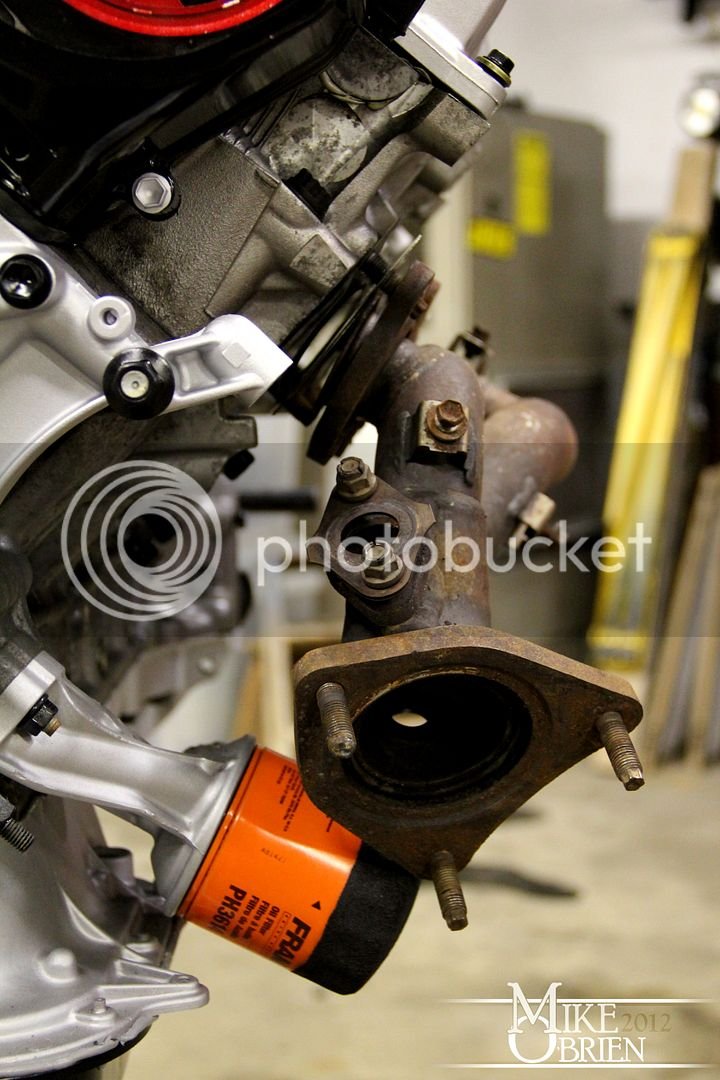

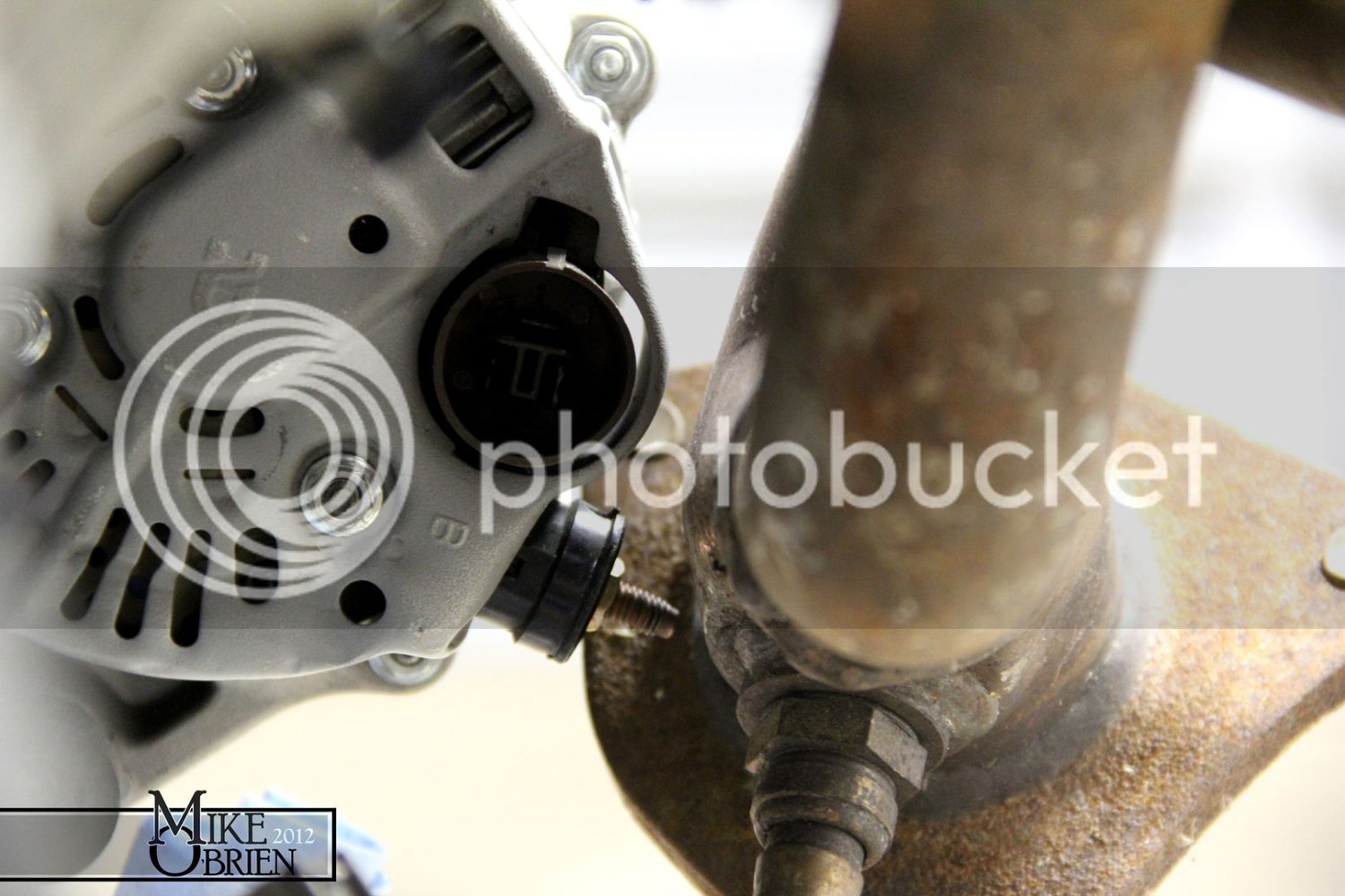

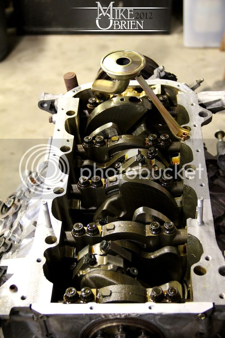

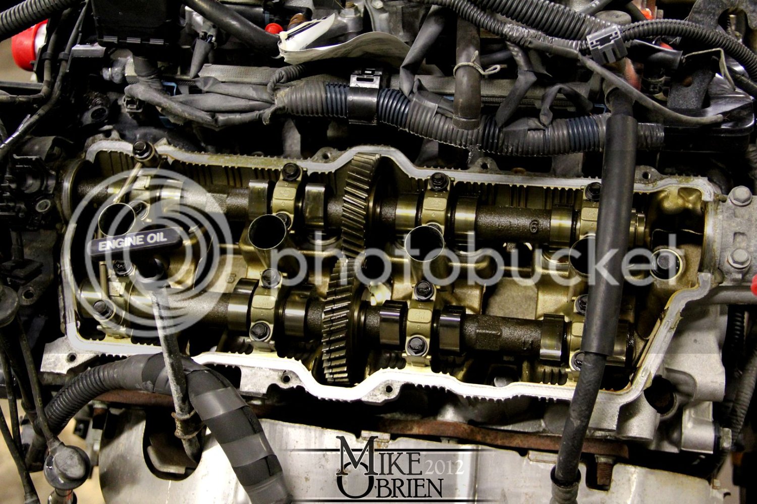

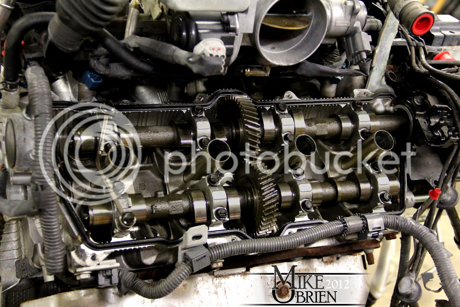

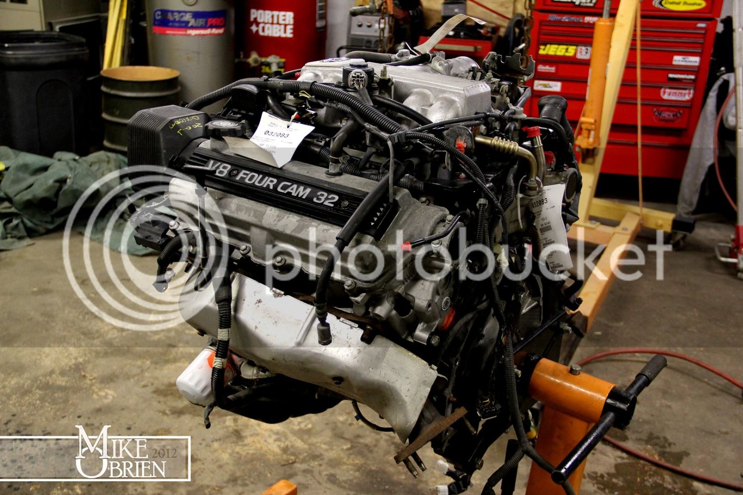

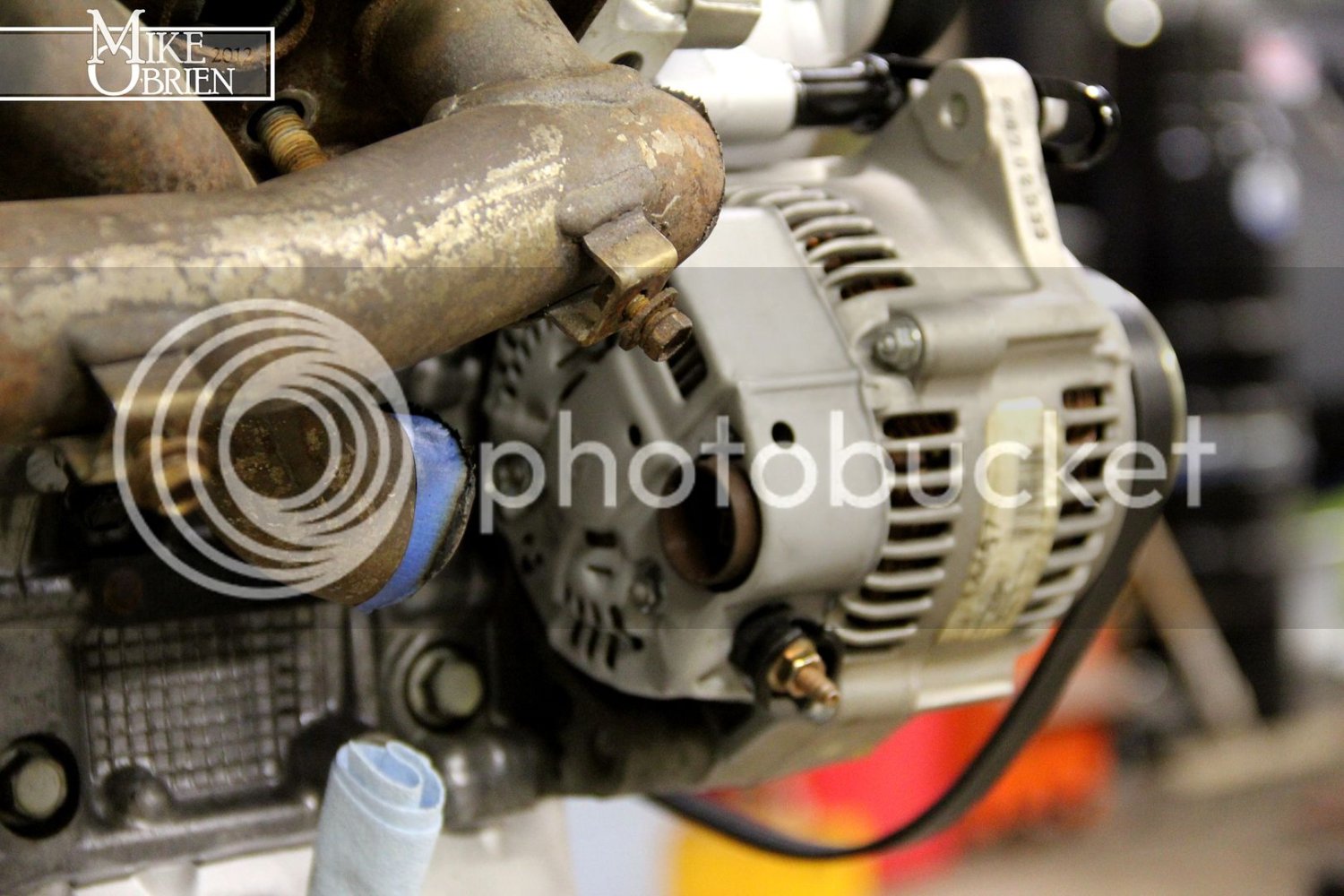

I recently purchased an 80K mile 1uzfe from a 95 LS400, and it is proving to be quite virgin upon inspection:
![IMG_8652.jpg IMG_8652.jpg](https://www.lextreme.com/forums/data/attachments/20/20462-b500ce8f66c11b97f7252f972c2c909a.jpg?hash=tQDOj2bBG5)
![IMG_8705.jpg IMG_8705.jpg](https://www.lextreme.com/forums/data/attachments/20/20463-5c79cd76a34aa1edc4ad1c0b81b03d8d.jpg?hash=XHnNdqNKoe)
![IMG_8718.jpg IMG_8718.jpg](https://www.lextreme.com/forums/data/attachments/20/20464-e2375b44a0800ada4a5c22a391adcc3a.jpg?hash=4jdbRKCACt)

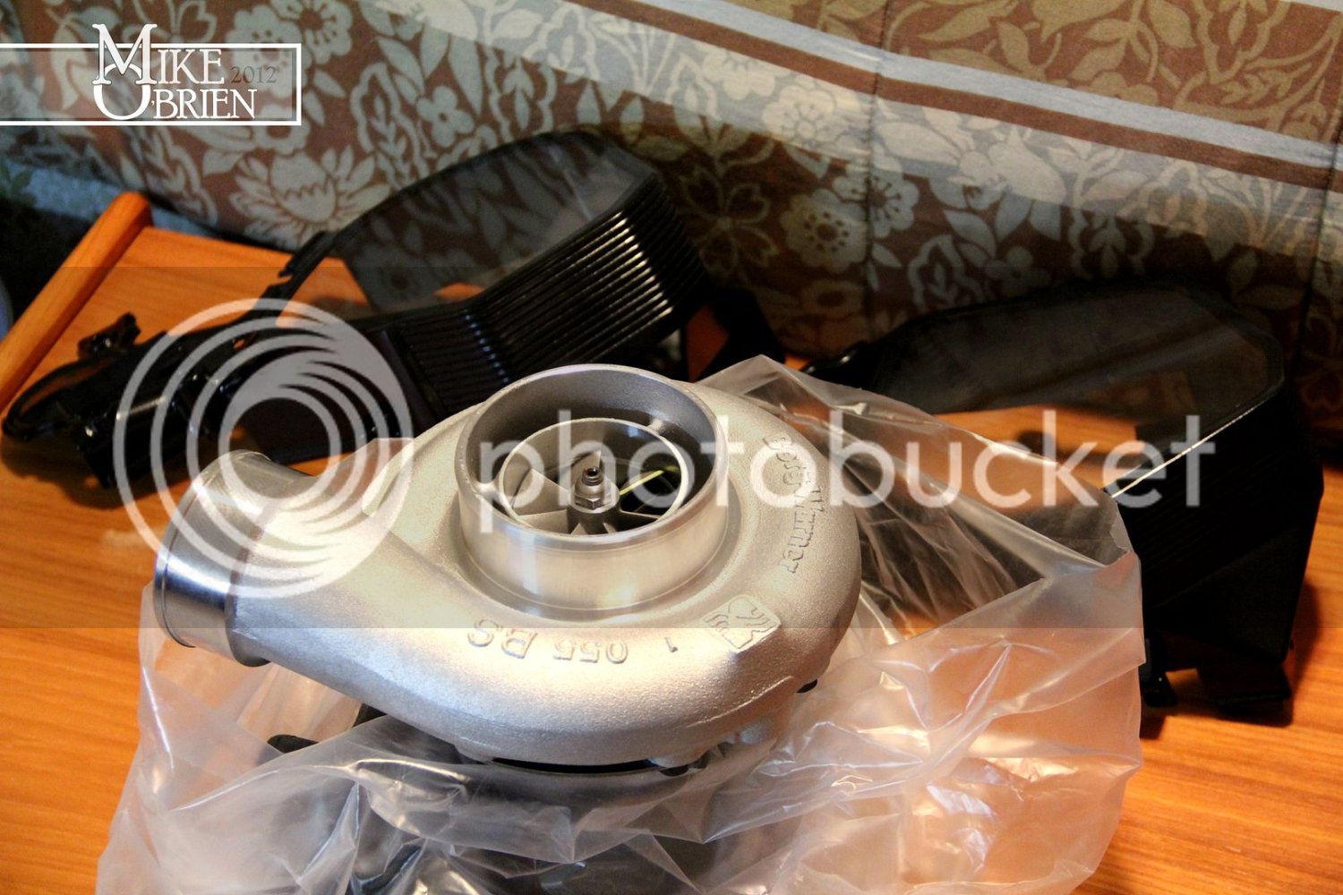

The plan is to go single turbo as of now. I am no stranger to standalones, wiring, or fab work (as you can see), so I look forward to the challenge. I was very happy with the Megasquirt II on my previous engine, so the plan is to continue to use it with EDIS-8 and a set of cleaned and balanced 440's. I am scouting for pre-95 rods, but will most likely fab the car up as is without touching the internals of the motor for now. I am looking for a decent low end response turbo, but something that will let me gently cruise without the need to be in boost at a mere touch of the throttle (to keep some economy). The current contender is a Borg Warner S300sx3 with a .91 divided housing, this should get me the response and power I want, even though a little low in the turbo's efficiency.
I am aiming for a modest 350-400 streetable HP. I am purchasing the full w58-1UZ rig from Quantum-Auto, and have mounts lined up to fit in my MA61 engine bay. Any more power, and I am not worried about the motor or trans hurting, but the suspension and chassis on the car. These cars weren't built to quadruple their original power levels!
