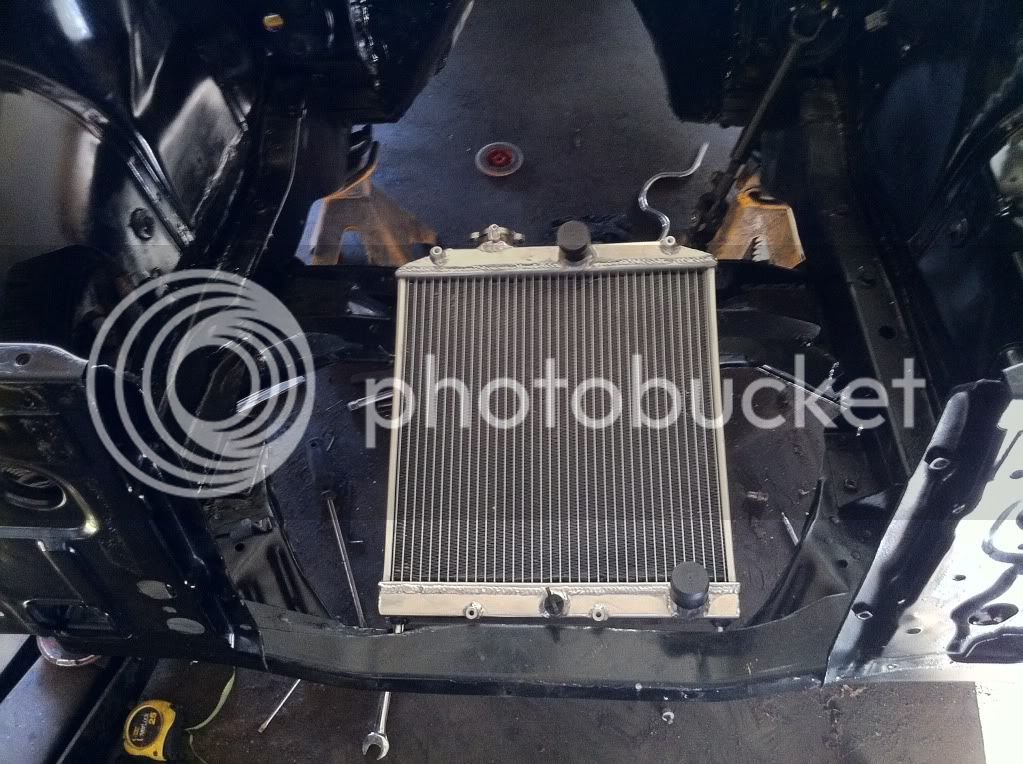

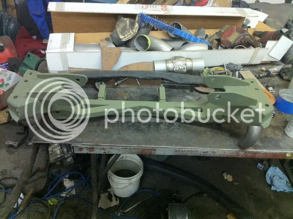

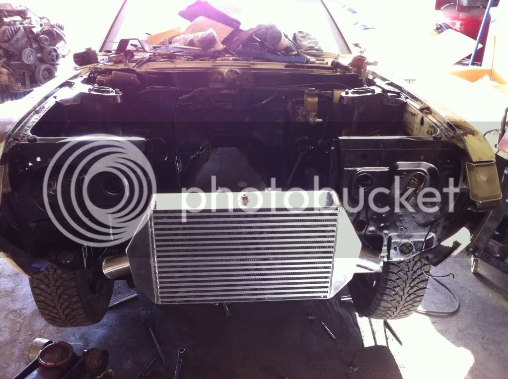

Plans? 9.0's 1/4mile
-Precision turbo ball bearing 6262 turbo
-1992 Crown 1UZFE
-Stock A340e trans running in full manual shift mode
-8 440cc 7mgte injectors, cleaned and balanced
-Megasquirt2 v3.0 modded to run all stock ignition system
-20gal Summit fuel cell, Surge tank, walbro 190lph pump feeding surge tank and Bosch 044 primary fuel pump
-All -AN fuel lines and fittings, -8 feed and -6 return

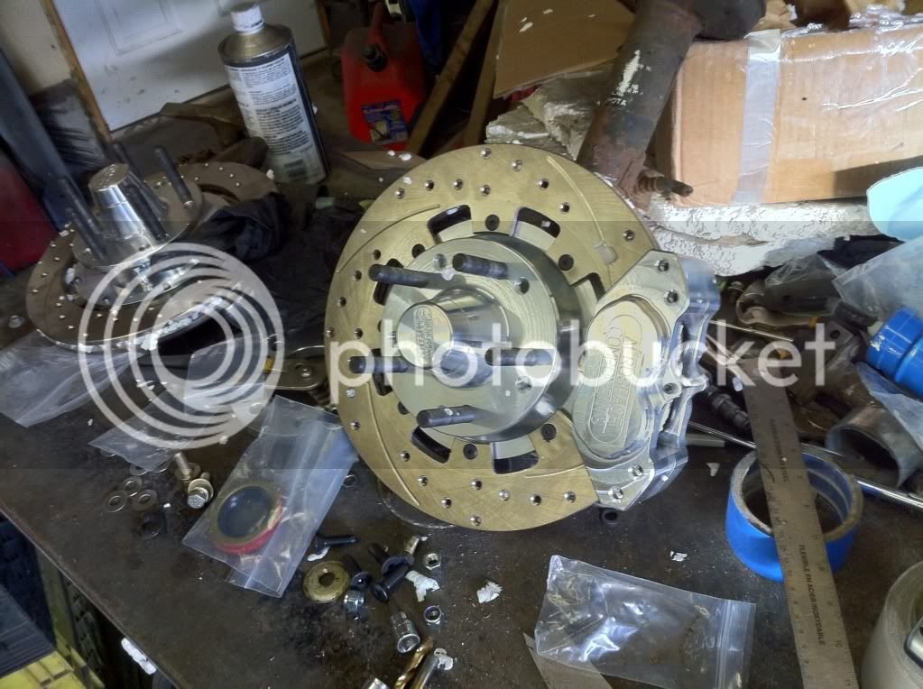

-89 Toyota 2wd 8" rear axle custom narrowed to fit
Had to rebuild some hood hinges
Turbo oil drain using the old lexus oil level sending unit
Gutted all the accessories and hydro-fan pumpetc, as this will only be running an alternator
