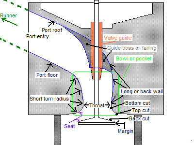

the bowl is in the chamber
As explaned here with pics..
The area just under the valve ..
The valve seat itself on an alloy head in this case..
http://www.popularhotrodding.com/en...ore/0602em_cylinder_head_porting/viewall.html
As in above link..
It's no secret that a great deal of flow typically lives in the port bowl, hiding under the valves and around the valve guides, just waiting to be harvested by the carbide. Reworking this area, accessible from the chamber side of the port, is referred to as pocket porting. There's a broad range of what one guy or the next will call a pocket-ported set of heads, but the idea here is to smooth-out or enlarge the bowl area and long side of the port adjacent to the valve guide boss, and even re-profile the guideboss itself. Don't go overboard when enlarging the bowl, however, or a flow separation at the seat will be the likely outcome.
i would just like to correct this...
i have no pictures with me on this computer to show, but will try get some next month
best and safest way to tidy up the heads,
short turn radius = sharp turn of port/ cyl head , before it reaches the backshide of the valve
long side = the port roof, up where the valve guide comes down through the top of the head
remove head
remove intake valves
stick ur finger in the hole, and feel the lump on the short turn radius, about 1 inch in...
use a die grinder and carefully smooth this lump down and blend it to floor surface , and valve seat
can use sandpaper on a finger to finish..
don't touch the long side at this stage
the short turn is more important, to get rid of the turbuance rolling off the lump

The bowl area I'm talking about is just under the valve..
Between seat and port area....

yer ok..
bowl area is out in the chamber ..
not under the valve... thats intake runner;)
Yes the port is almost square in this area..
Doesn't take much to make a big difference
especially with forced induction...
I think bowl is a term used to mix, lap, blend or smooth
anything..???
Like on pushrod engines where some unshrouding is done..
The area in green ...
anything..???
square?
yes, unshrouding is done in the bowl area... out in the chamber of the head....
