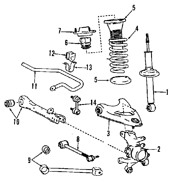

I already bought the Arnott front arms---I will buy the 4 lower bushings for the front, the 4 strut cushions for the front/rear, the 2 sway bar bushings and the 4 upper bushings for the rear control arms and 4 lower bushings for the lower rear arms
Did I miss anything? I think that should cover the whole suspension? Do I "soak" the bushings in Mobil 1 red synthetic or just put alot on when installing them?
