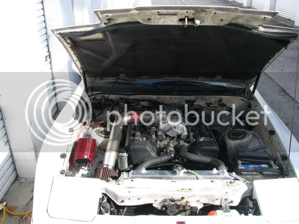

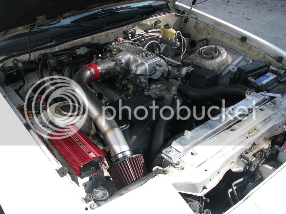

I have a 1990 Supra NA that I am doing the conversion on and I am wondering about the motor mounts. What motor mounts did you use? If you have a pic of them on the motor I cannot see them due to the restrictions on these computers.
this car belongs to me now, however the OP made the mounts himself. im not sur eon the design differences but i saw a set of 1uz mounts for a MK3 supra for sale for like $100 in Florida the other day. i believe they were on www.supraforums.com in the florida for sale section.
