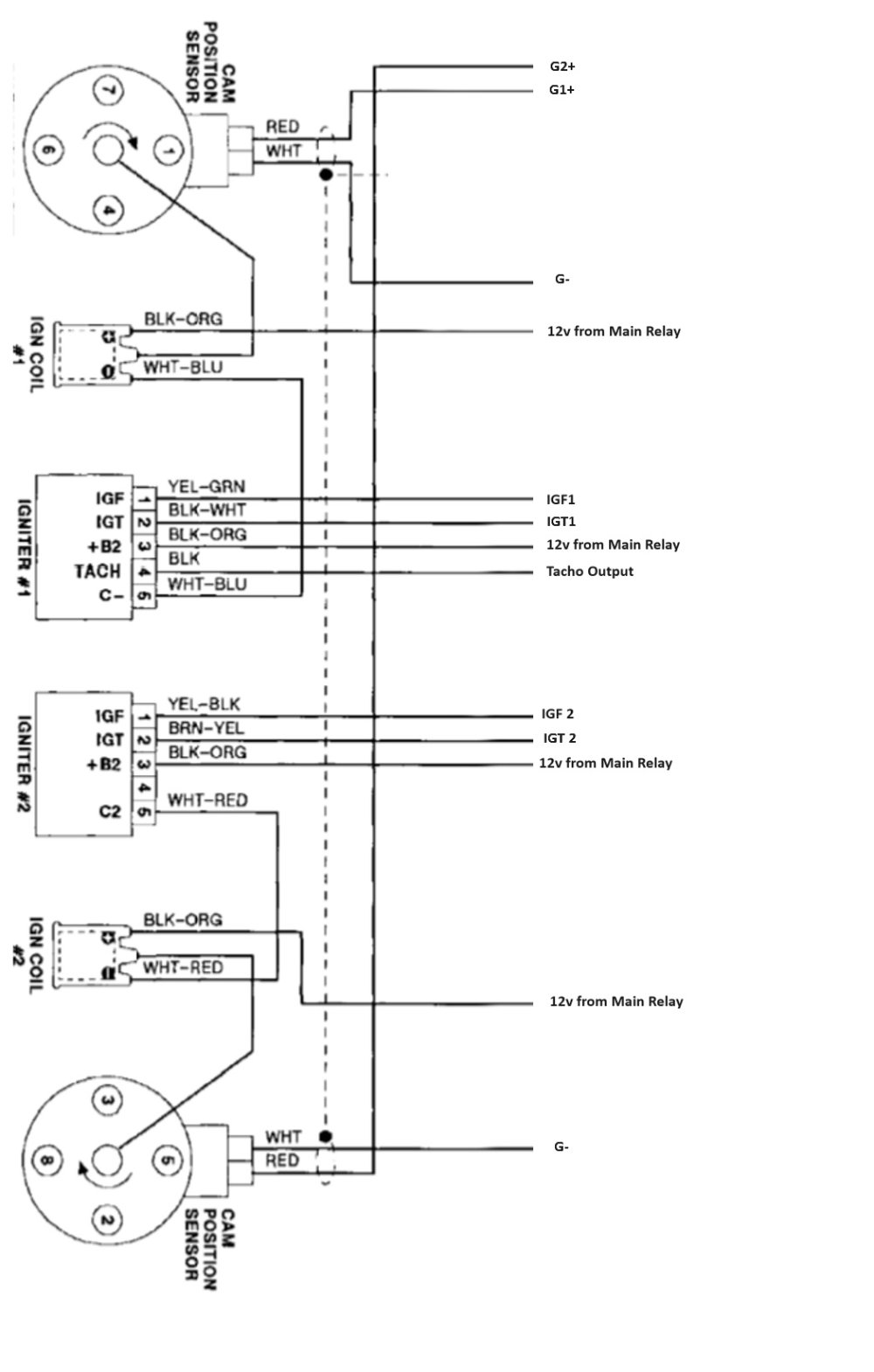

If the plugs are wet then it sounds like the ECU is turning on and getting reference from your cam/crank sensors. Double check the wiring from your igniters to the ECU.
@P Bateman
sorry ive been busy with school, but ive also verified all wires on ignitors: the 2 wires going to ecu have continuity, continuity going to coil, and 12v on middle wire using the casing as ground

Forgot to mention that ive tried starting fluid and it still doesnt start which is why i think its a spark/ignition problem
The ECU has to see spark before it will fire the injectors. It's a safety thing.
If it won't fire with starter fluid it's definitely spark.
Make sure the igniters are grounded to a good ground. Don't ask how I found out that was important.
Check if you have spark at the coil leads. This will let you know if the problem is before or after the coils.
Once the plugs are wet I've found the 1UZ doesn't like to start.
After you sort through the wiring I would suggest checking for spark with a plug lead removed and a plug well grounded.
Then I would either clean and dry the plugs or fit new ones.
