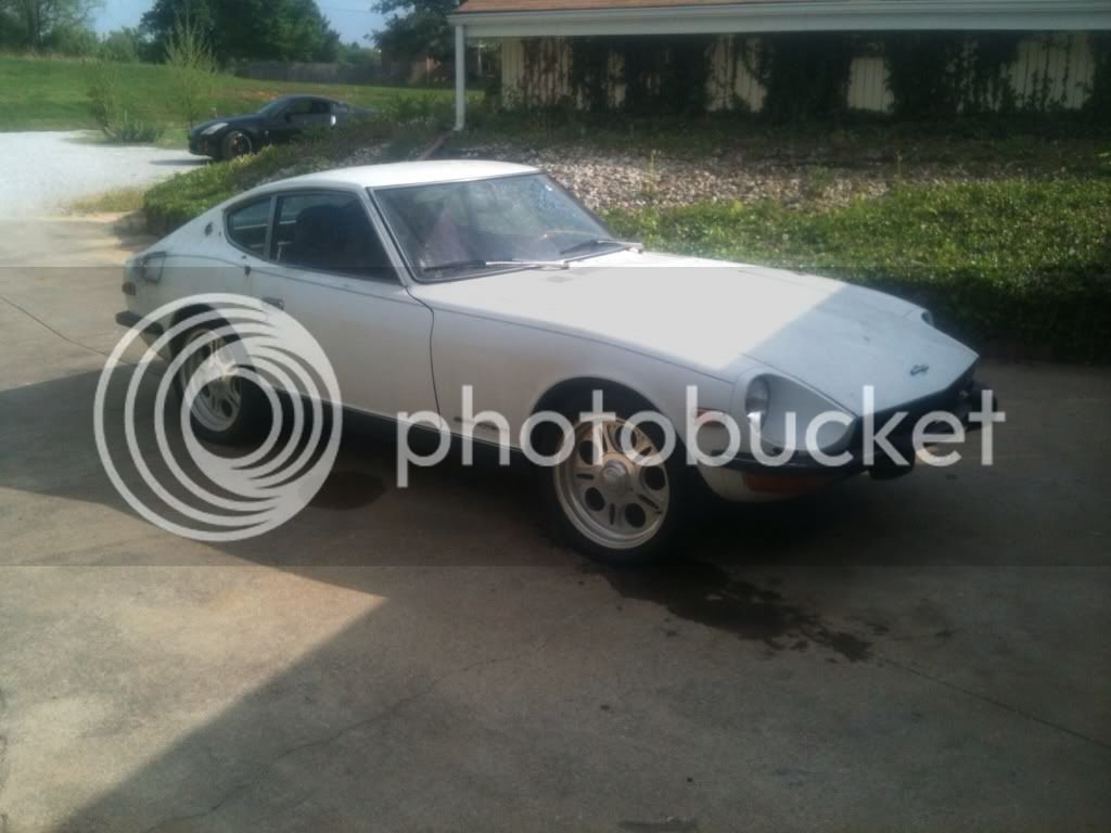

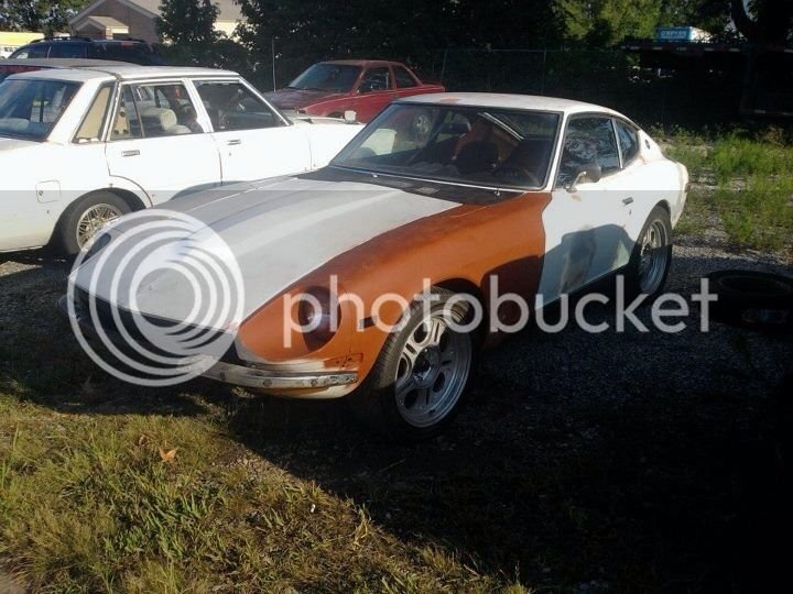

A few years later after toying with the 350z. A once in a life time opportunity found me. A buddy of mine asked me to go look at a 240 with him. I assumed it was a 240sx simply because that's the sort of crowd I run around with. When we get to the location of the car. I was awe struck by a 1972 240z covered in dust. My friends intention was to daily drive the S30. So first thing first was to see if it would start. according to the owner, it never failed to fire up. Except this time. My buddy ended up telling the guy he didnt want it if it wouldn't start. I of course asked him how much he wanted for it. The guy told me 500!!! I looked over it all again. I only had 400 to my name. I told him that's all I had but I really wanted it. He told me that he needed to move the car soon because the landlord wouldnt let him have so many vehicles. (he was already at 6 cars on his land.) So I picked up the little 1972 240z for 400 even.

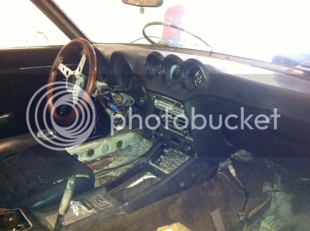

I immediately got to work on getting the car running. It was all too difficult it just needed an ignition switch and carb cleaning.

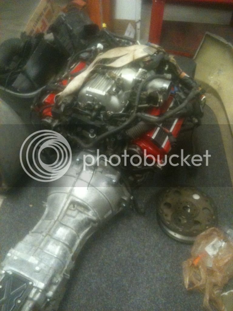

I found a ready to run 1UZ for 400 in a local city, with wiring harness and swap mounts for a mk3 supra.

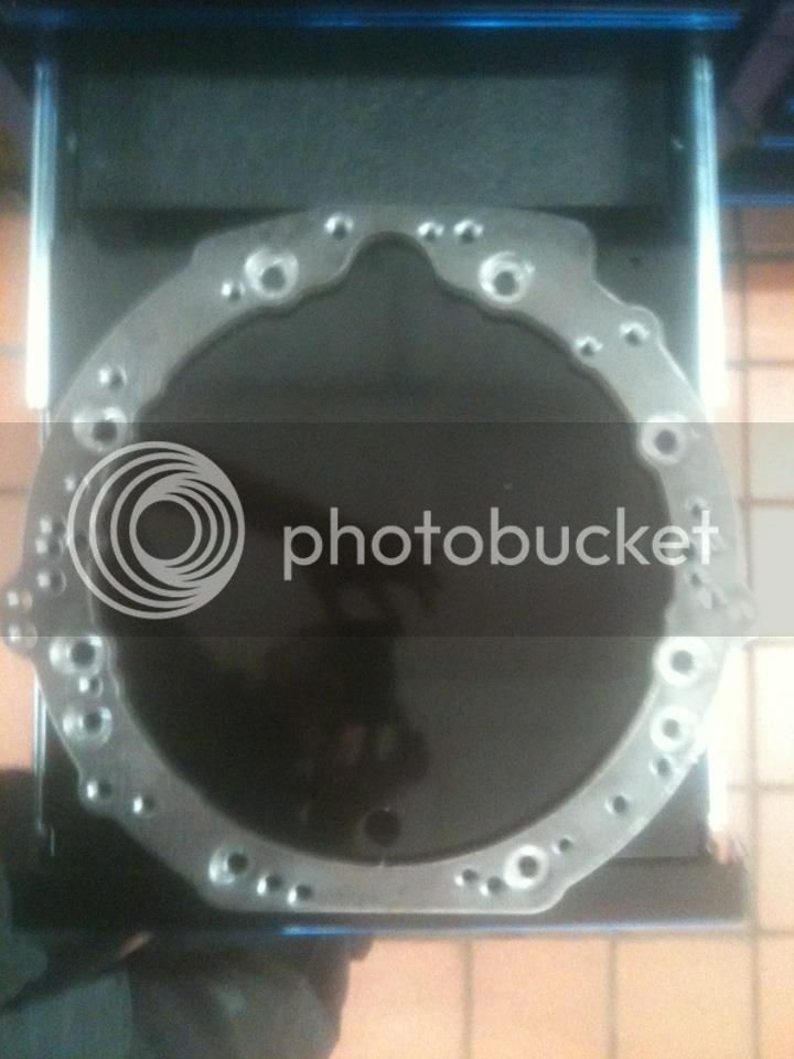

I did some research and found that there was an adaptation kit to mate a 1uz and 350z six speed.

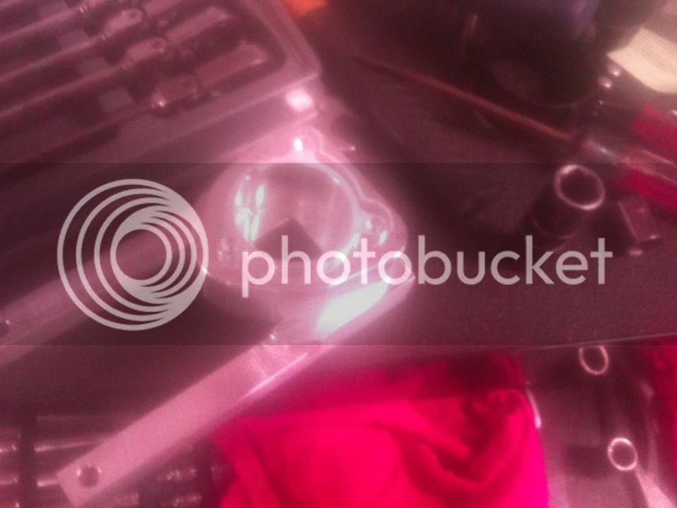

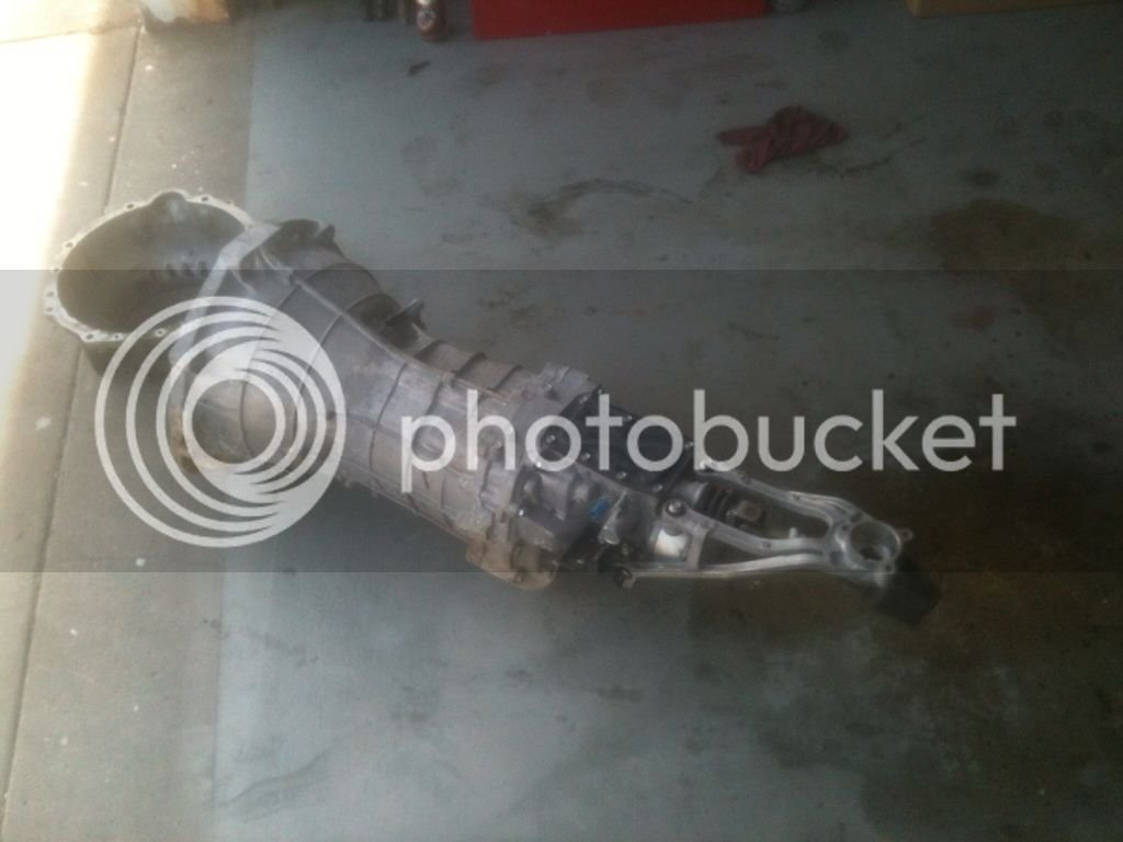

I also picked up this gym from a friend who works at the nissan dealership in town.

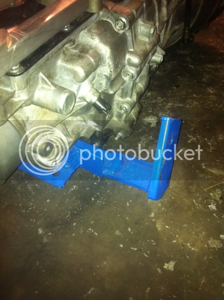

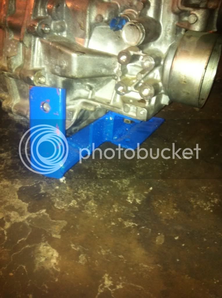

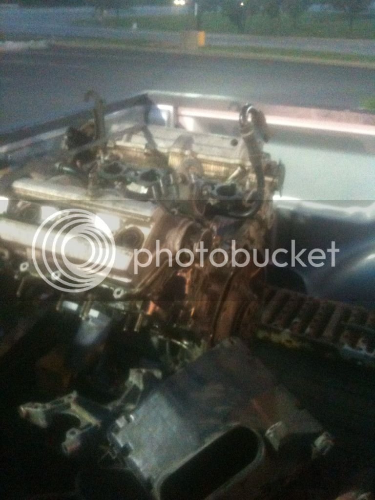

With the MK3 supra swap mounts the 1uz BOLTS IN.

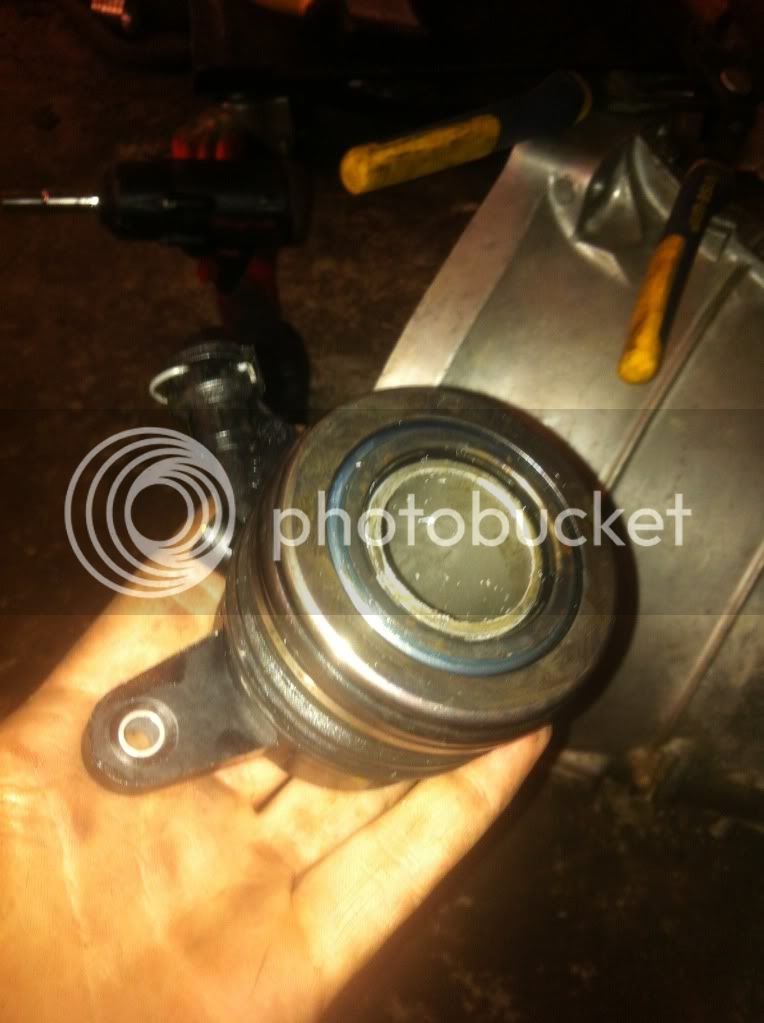

transmission adaptor plate.

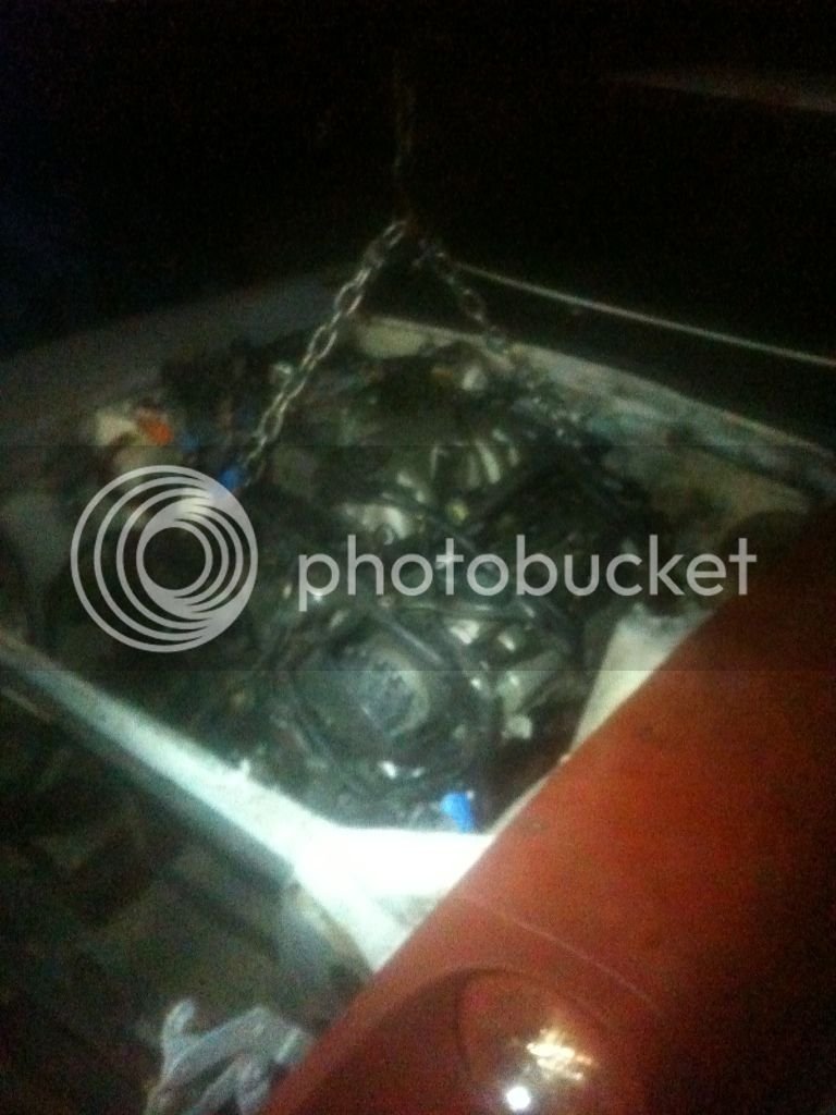

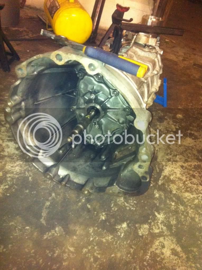

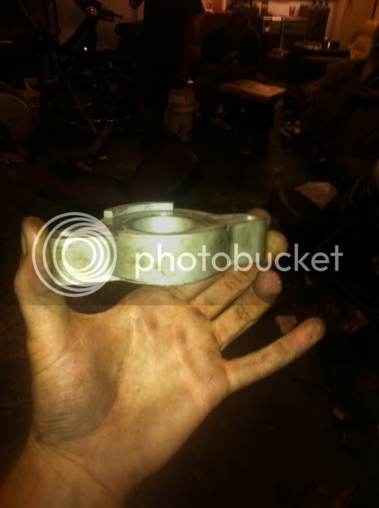

test fit with motor and trans.
ACT stage 3
