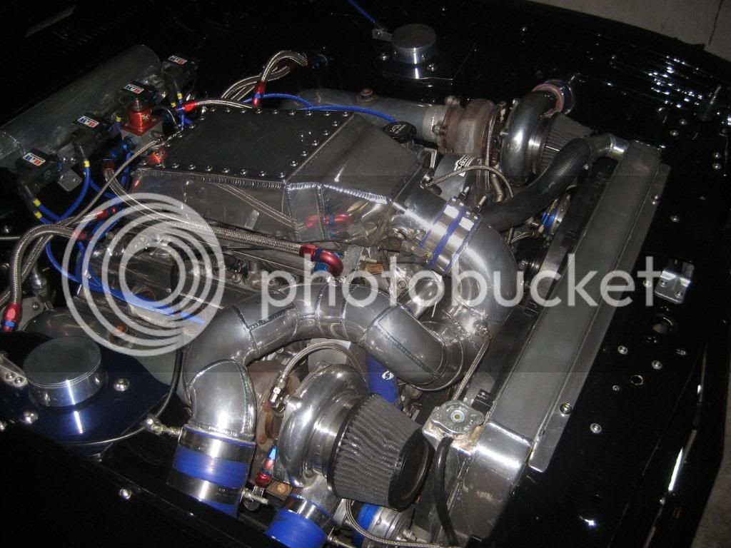

the manifold we kept the bottom manifold, port matched it to the heads and just made a custom plenum. alot of 1UZ experts say the bottom manifold limits power to around 5500rpm, we feel that may be true with NA applications but not on forced induction. the power figures don't add up that would mean we are making 1050hp@5500rpm we rev to 8000rpm, cams are supposed to make power up to 7500rpm if we made power all the way up to there it would be making 1200+hp on 25-26psi those figures u would expect to see on an exotic fuelled high comp engine not on an engine like ours. so don't be afraid to use the bottom manifold. here is a picture of what ours looks like, we are looking to run a similar style again just a little smaller
Bosch indy blues are good injectors we run the same, with E85 u should be fine, methanol u might be pushing it a bit as u have to double the fuel u use, whereas E85 is only around 30% more.
top one, richmond / richwood blower manifold
aka aerpc, and periano's
bullet manifold on the bottom

what about an elbow straight into the manifold? being drag only, has anyone tried that with a UZ? what do the Gullotto's run? i haven't seen pictures of the engine since the Zoom article years ago.

std top manifold ?
the soarer is still the same...
like Campo's mustang and alot of other US racers. similar to this, it's one Northmead Auto are doing at the moment

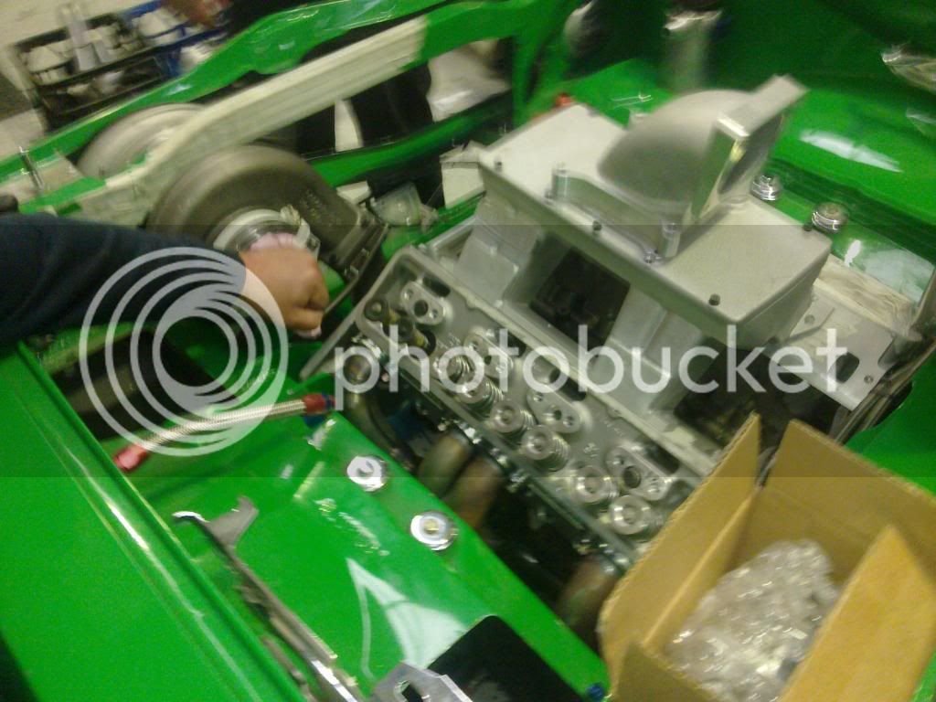

front view of box plenum
lexus will be simular to this sbc...
but with cast lexus aftermarket lower intake

FoPar...Is the lower inlet as per Lexus or are the flange plates used only with more upright inlet ?? The std lower inlet drop down to "near" 90* from head...

We are making our own inlet.. We'll see how we go..

this is the box plenum , i'm using on the richmond manifold base...
A good way to go. I prefer the Bullet manifold but with a few hours porting the Richwood one scrubs up OK.
Despite Fopars advice, i made an approx extra 50rwkw from just ditching the lower manifold with no other changes...it hurts the power curve no question...n/a or FI ;)
