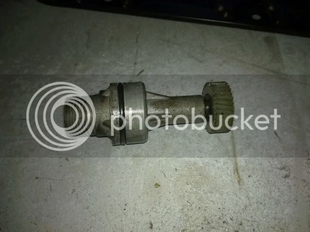

i could machine up a new hosing to mate the auto's speedo sensor to the w58 drive, but an oem part would be better
take a pic of the gbox where the sensor is supposed to go
ive got about 10 diff speed sensors in my box at work
one should be able to fit
i have 2nd hand an d new sensors that will screw onto that thread on the speedo drive
do u want 2nd hand or new and what speedo are u running int he dash

anyway i can test an sc400 sensor and supply u one to suit
but remember it might not be 100% accurate
u might have to play with the gear in yr speedo drive depending what diff u r running
so it might be afew % out due to the fact the sc400 might have had a different ratio diff to yours

sensors i have are 50 bucks
