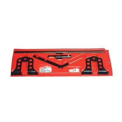

Something like this?
Matco and Snapon sell them,I'm sure it's available somewhere else for a lot less (probably OTC brand)
I like ozvenom's custom tool,2 valvesprings at a time.
