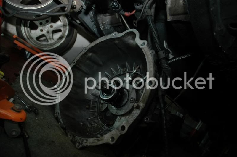

The problem iv run into is purely the clutch hydraulics! I bought a pedal and master cylinder from toyota and fitted them all but from the moment i tried to bleed the system it wanted no part in being a manual.
The fluid was coming through the bleed nipple with each pump as normal but there is absolutly no feel behind the pedal, it keeps dropping to the floor and has to be pulled back up. I tried bleeding it for over a hour the other day with no avail!
Can someone please give me some info as to what could be causing this? I thought it was the master cylinder seals, so i checked those and they 'rebin lint condition. Iv also checked for leaks around the lines and found nothing! The next stage would have to be remove the box again to check the slave so im trying to check everything elae before that has to happen!
Any help would be greatly apreciated!
