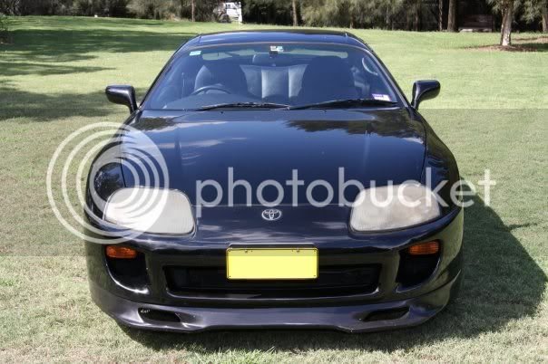

I decided i liked the look of a black wingless supra. Sourcing one isn't hard, plenty are around. Figuring it would be more cost effective not to buy a twin turbo, I picked up this non turbo/5 speed recently.
