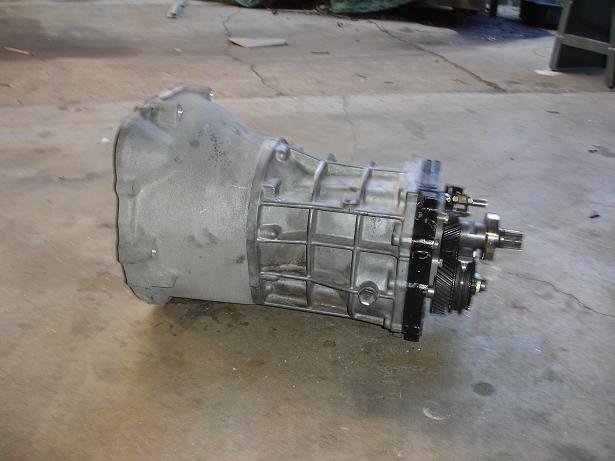

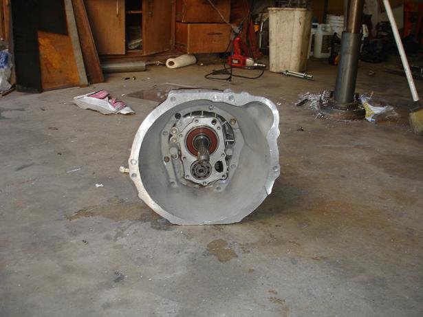

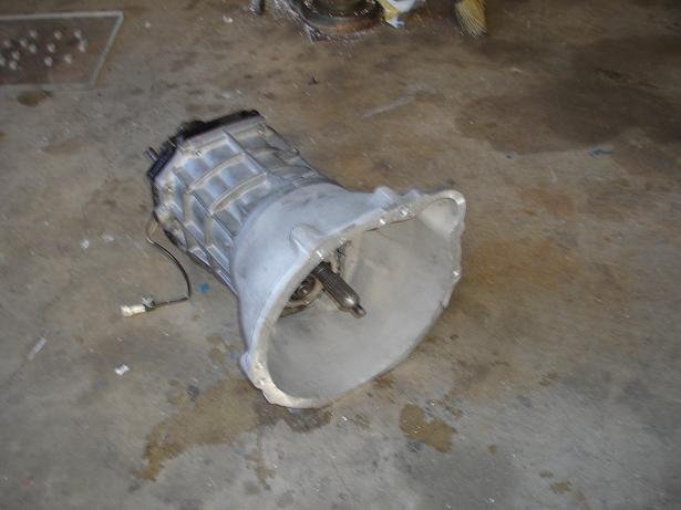

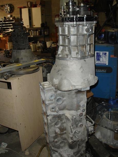

here are the latest pics of the bellhousings. I have to add some material to areas around some of the bolt holes. I did not account for shrinkage...but now I know. I should have these finished up by the end of the day ready for powdercoating.
