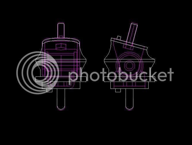

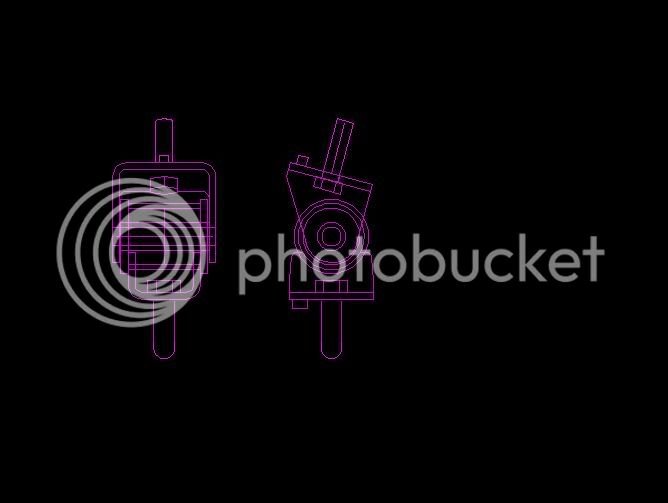

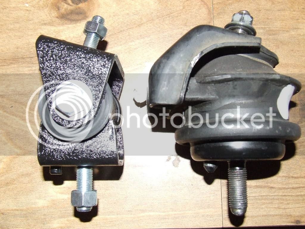

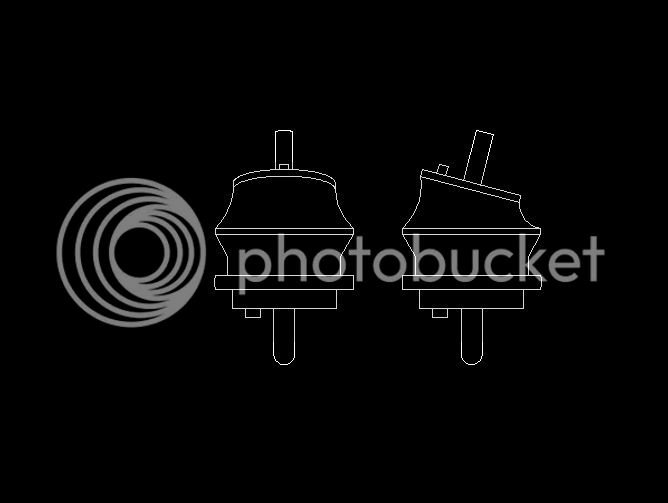

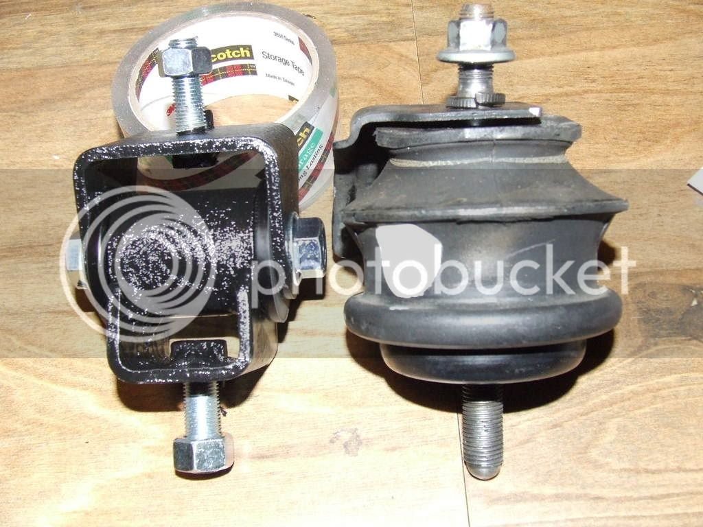

Here are some drawings of the mounts I am currently making. I have opted to use larger Urethene Mounts. I selected the 1.5" dia working surface, I will use the Energy Suspension Black due to it is self lubricating but otherwise has all the same properties as the red.
Here is a stock mount
Her is what I am making, These should be a 100% stock bolt in. Note you have to offset the upper stud to keep it all in line with how the stock are.
Here is a drawing of them layed over each other. I wanted to keep the mount in the size restraints of the stocker. I will Keep you posted on how they turn out.

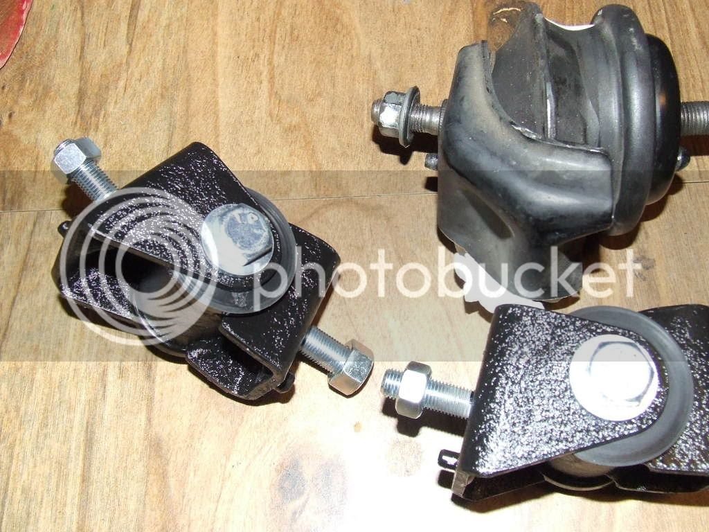

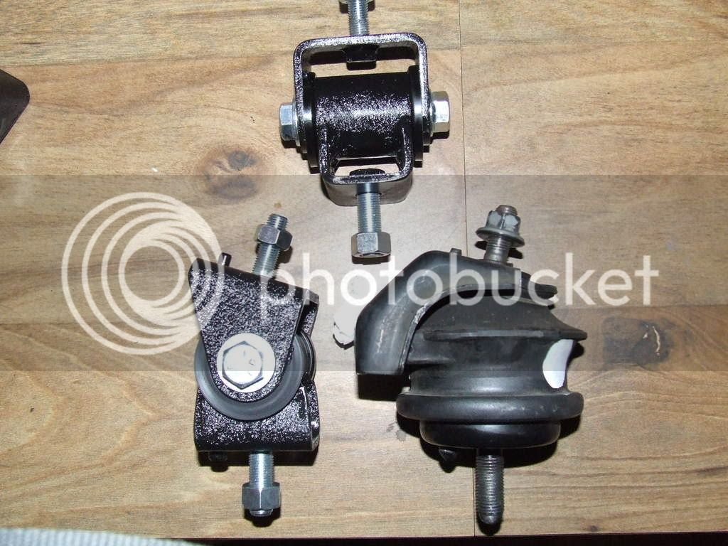

Hilux Urathane Engine Mounts
Hey Guys,
Recently had these put together. Have only driven the car a few times (no exhaust yet), but the engine vib seems to be marginal...
