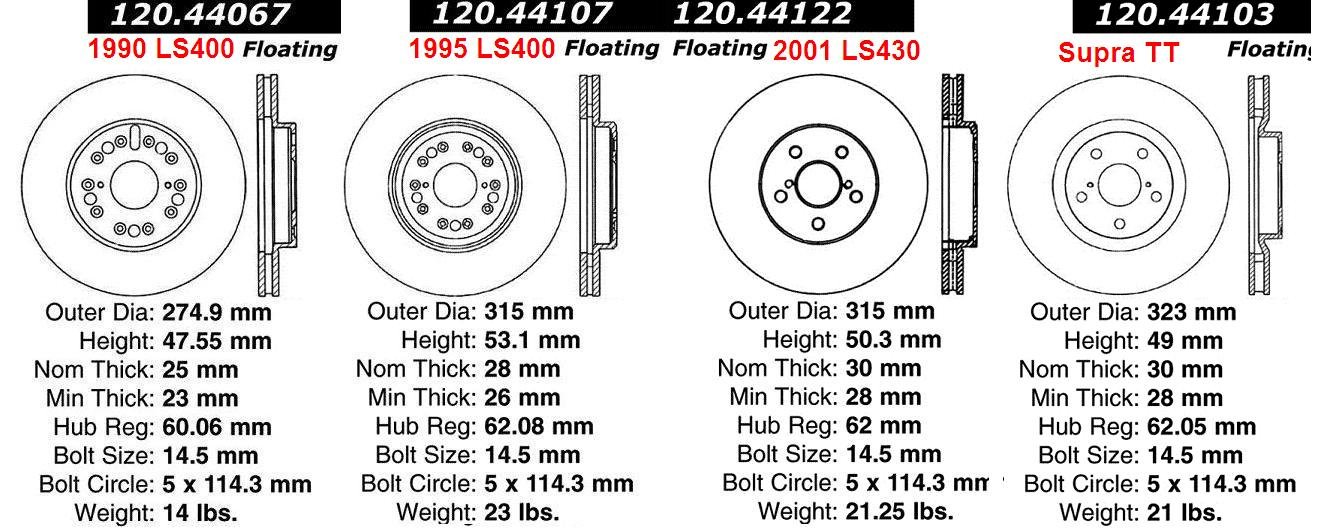

So I found a couple references to TT rotors working with '95 LS400 calipers. Is that true? Found one reference saying no, but wanted to check if anyone has actually tried.
http://www.lextreme.com/forums/showthread.php?t=8194
![Rotors.jpg Rotors.jpg](https://www.lextreme.com/forums/data/attachments/21/21287-f5d9bf1bb7c9c4ad33548cb6475e7b47.jpg?hash=9dm_G7fJxK)
Its 8mm in diameter, 4.1mm in height, and 2mm in nominal thickness.
Thinking about trying some 2 pieces rotors on the race car, and I know they make some for the Supra, but doubt it for the LS400.
