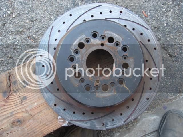

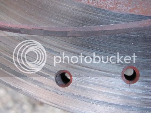

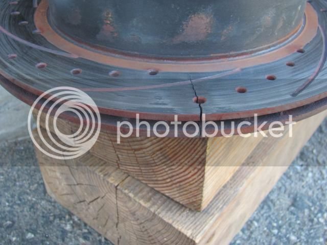

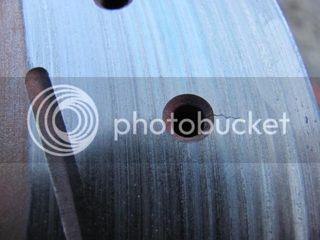

This happened at my last driving event at the Streets of Willow, on Aug. 16. I got these rotors off ebay years ago, and they lasted almost 5000 street miles and a couple of previous driving events with no issues.
I was driving REALLY hard this time, and they got REALLY hot. Oddly, the other rotor didn't crack at all. This one has four major cracks and several small ones on the outside, but only ONE on the inside I think it was because this one was on the upwind side of the car as I had it parked in the pits.
And these were crack free before the event--I check them all the time. Anyway, cross drilled is probably OK for the street, but not for the track.
