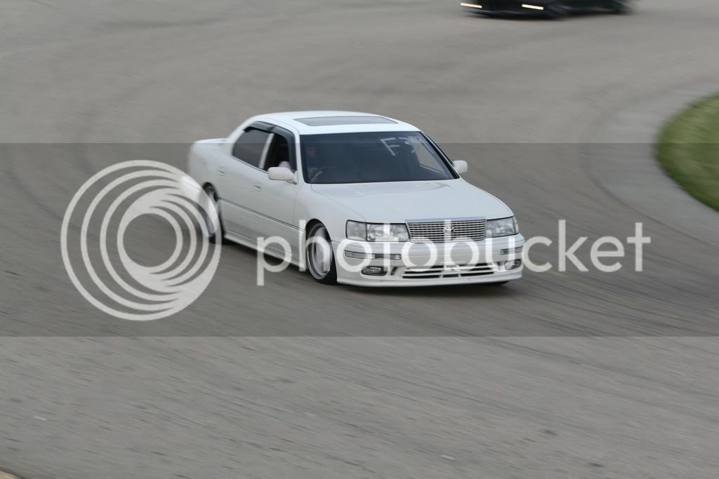

Unfortunately there is no video, but here is a pic to proove they're not all show...
No Worries Armed,
very nice shot! I love seeing people really pushing the LS. If your cool with not having an all-out stereo, you can take out another 25+lb through removing thre sound deadening thats underneath the carpeting. Also, a full exhaust when done right can shed a solid 45lb as well. I know you mentioned seats on the way.. this is the biggest source of dead weight. I had corbeau seats in my LS and after weighing everything I noticed about 85lb saved over stock. Also, the windhsield washer bottle is around 25lb when full of wiper fluid. Project looks good.

wow ok those tires look tiny on those rims in the photo! mine runs 18x9 all round with 275/35 rubber (Nitto Invo's)
