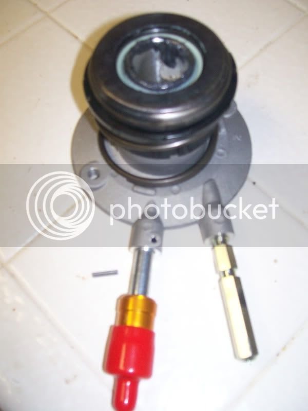

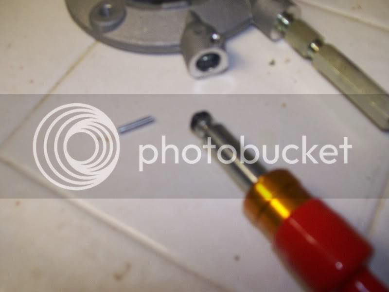

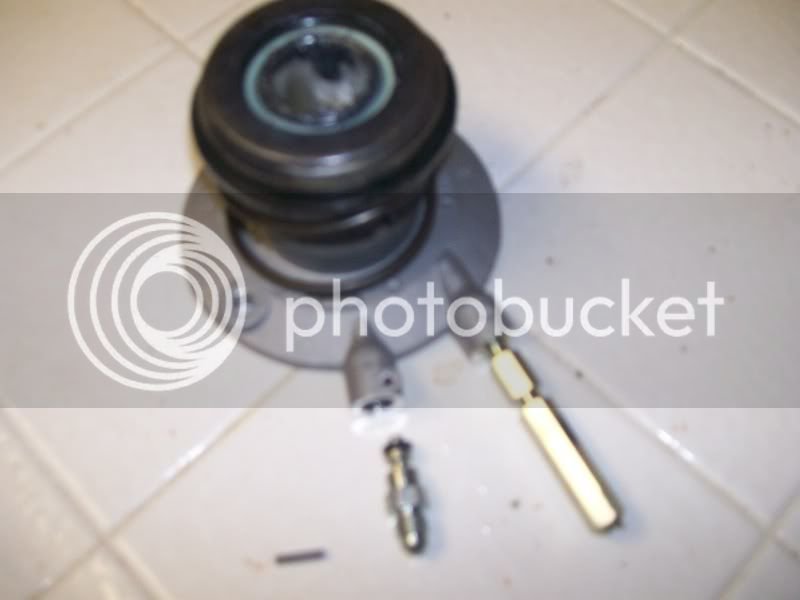

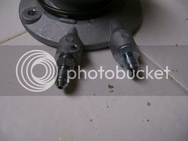

First off here's the t56 throwout bearing
On the left hand side it has a slip fitting that is retained by a roll pin
remove the roll pin and the big orange gm fitting slides right out.
Go ahead and toss this piece as it's useless for this swap.

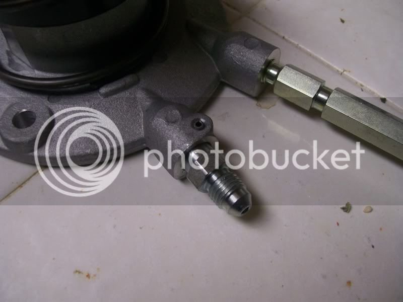

now use the slip fitting that came with the kit and slide it into the t56 throwout bearing.
Then replace the roll pin.

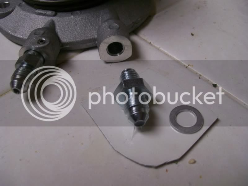

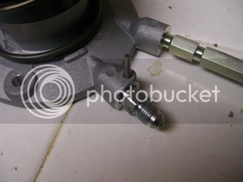

now remove the fitting on the other side and replace with the fitting that's shrink wrapped to a piece of cardboard with a crush washer and be sure to use the crush washer or else IT WILL LEAK!!!
Now you're done with setting up the t56 bearing for use with the braided steel clutch lines.
