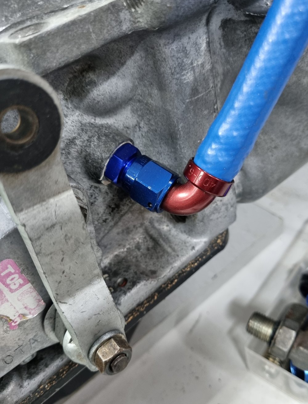

ivan129 BlownZX Mar 14, 2024 #1 Does any one know the thread of the metal adaptors that screw into the side of an A340E? They look like they a close to being M14 x 1.5 but a die doesn't seem to fit on the thread. I'm wanting to replace them with AN6 adaptor fittings. Thanks

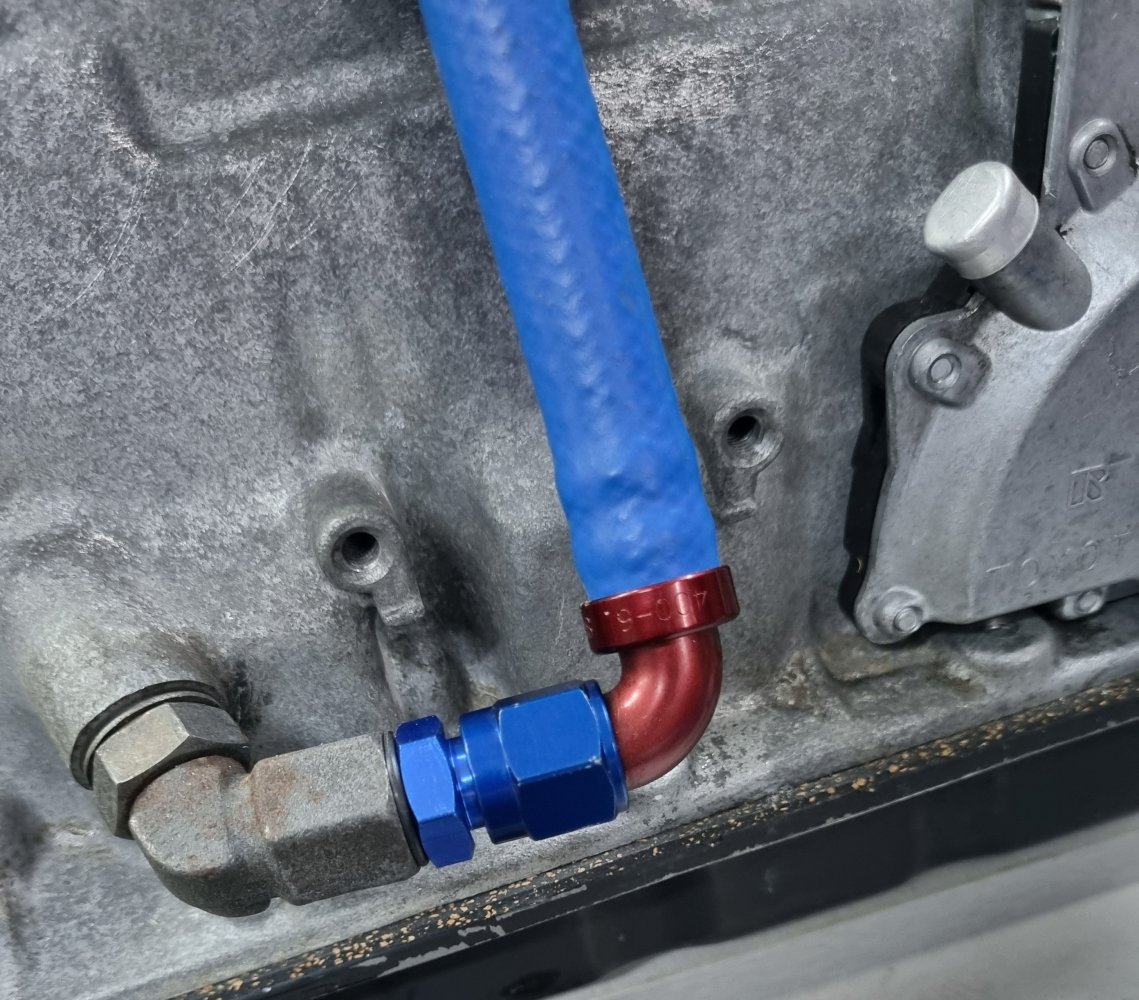

ivan129 BlownZX Mar 25, 2024 #2 Bought some AN6 fittings today and can can confirm the threads are M14x1.5. Allows me to tuck the fittings in nice and close to the box.

ivan129 BlownZX Mar 28, 2024 #4 Allows for a closer fit Attachments trans_AN6.jpg 1.9 MB · Views: 2 trans_AN6_1.jpg 1.4 MB · Views: 2
