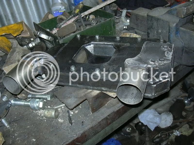

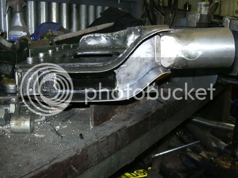

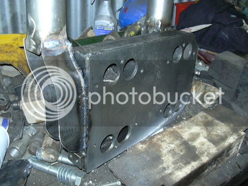

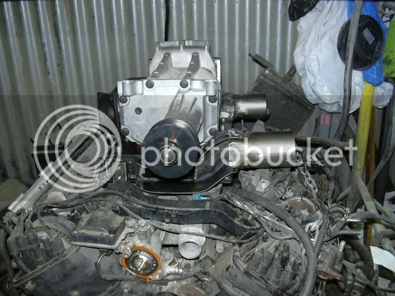

I wouldn't plate it in chrome or similar as you can't get at the inside to enure the chrome will hang on.
Wouldn't be a good look for it to flake off and pass through the engine.
The more I think about the better galvanising looks. Zinc and alloy sounds better than steel and alloy from a corrossion stand point.
