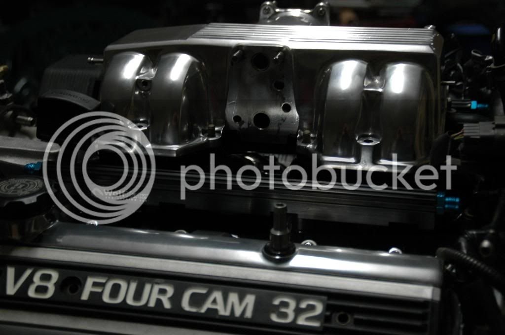

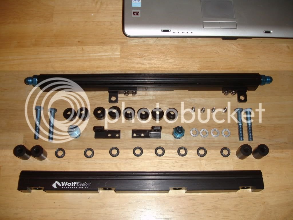

Fellas, understand how easily this WolfKatz system bolts up...We had it installed in less than an hour. They mount right to the stock system, and everything fits in place. Remember, I do not sell this stuff, I just decided to buy it and install it because of its ease of installation and its beauty...Plus, Garrett is anal about desiging it for both excellent function and aesthetics...
  1. First oil the O rings, then fit them onto the black injector funnels and place and push them into the stock ports on the loweer manifold.
  2. Oil the O rings on top of the injectors and then push them into each injector port on each rail (The rails come assembled with the mounting brackets and the AN fittings already in place).
  3. Mount the rails and injector assembly, and place each injector into the its corresponding injector funnel and push straight down firmly.
  4. Take the supplied spacers plus an additional 1/4" spacer and place them with the supplied washers onto the supplied mounting bolt and secure them. Torque them to spec.
  5. Make sure the injectors are turned outward, and connect the injector clips.
  6. Done!!
It is literally that easy...Now the other way...Buy some rail stock, and some aluminum plate, and make sure you have the machining equipment available and start fabricating...Hmmm...An hour later and WTF, *&%$#*&^%...LOL, I think you get the picture...It can be done, butit will be a whole lot harder...and lots more time...
