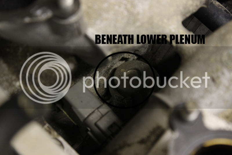

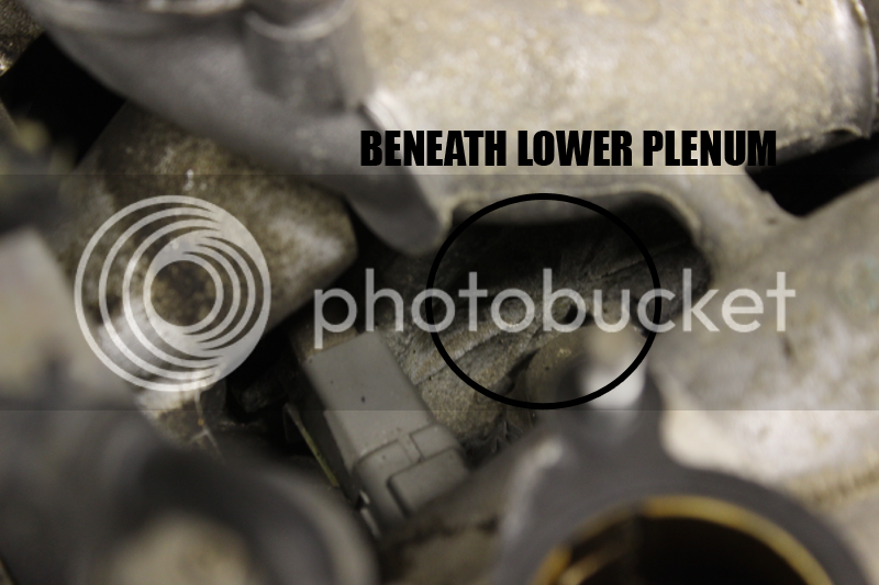

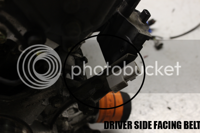

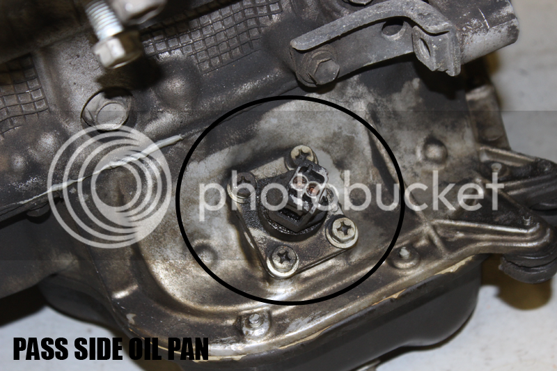

1.)What is this sensor?

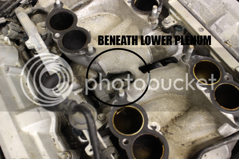

2.)What is this sensor or is it fluid or vacuum related?

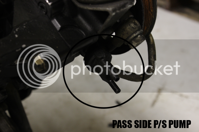

3.)What is this sensor?

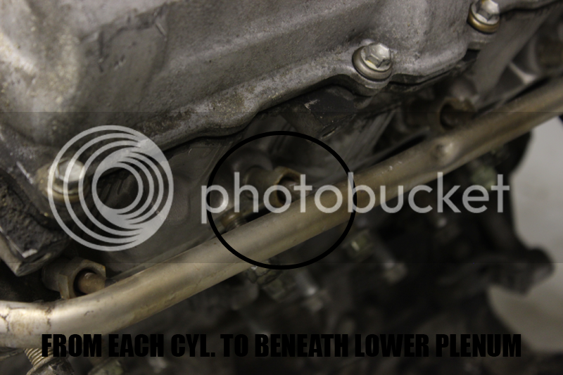

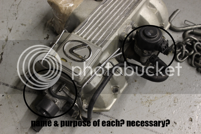

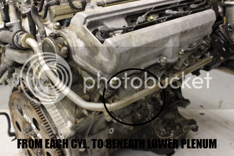

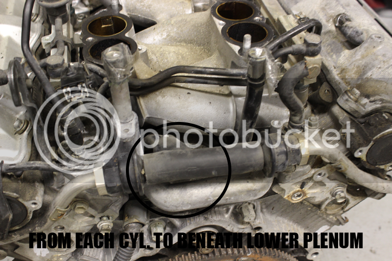

4.)This entire system I just simply have no idea what it is; it has some sort of plug going to each cylinder into metal tubing going down under the lower plenum into what looks like some sort of pump or something? I dont see it present on a lot of peoples pictures of their 1uz's and cant find any information on it.

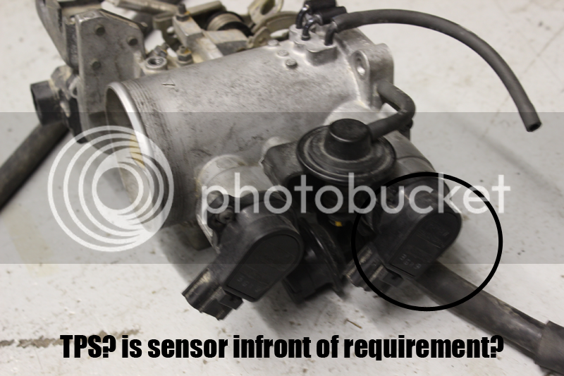

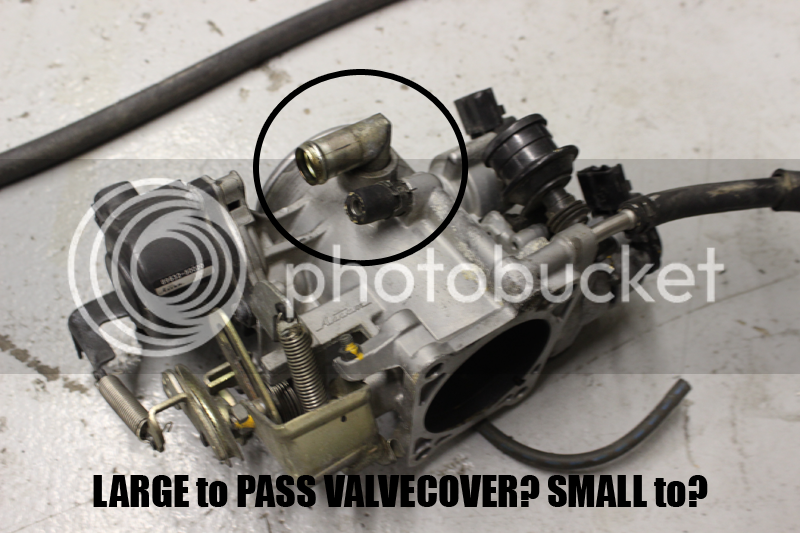

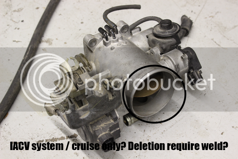

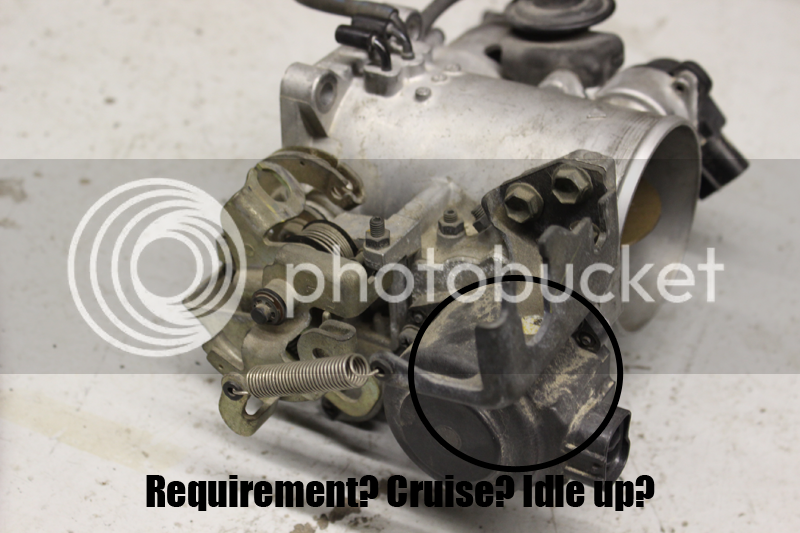

5.)Trying to figure out what all this junk on the throttle body is and hoping its similar to nissan where all I should need is the actual throttle butterfly and the TPS; here's the questions on each picture:
6.)
7.)
8.)
9.) Lastly, I see on one diagram that the driver side center of the upper plenum is the EGR valve and the front item is the 'ISC Valve'; is this a sort of IACV and does it serve any other purpose besides that? I'd like to delete all of this and adjust idle via the throttle set screw. I am aware that cold starts will be rough and etc, but as I said originally this engine should be warm before driven regardless. Seems like the front unit has a coolant passage though?

the sensor in the oil pan is the oil level sensor otherwise known as the first place you get an oil leak.
the next one is the power steer idle up valve
then coil condenser / suppressor
next 6 photos are egr / air injection
then the small hose on the TB is the water heating circuit (run a hose from thermostat housing to the rear water bridge)
Yes thats the TPS the other butterfly thats run off the motor is for traction control and has it's own TPS, ignore it
last photo is EGR on the side and the front is the ISCV (idle speed control valve)
