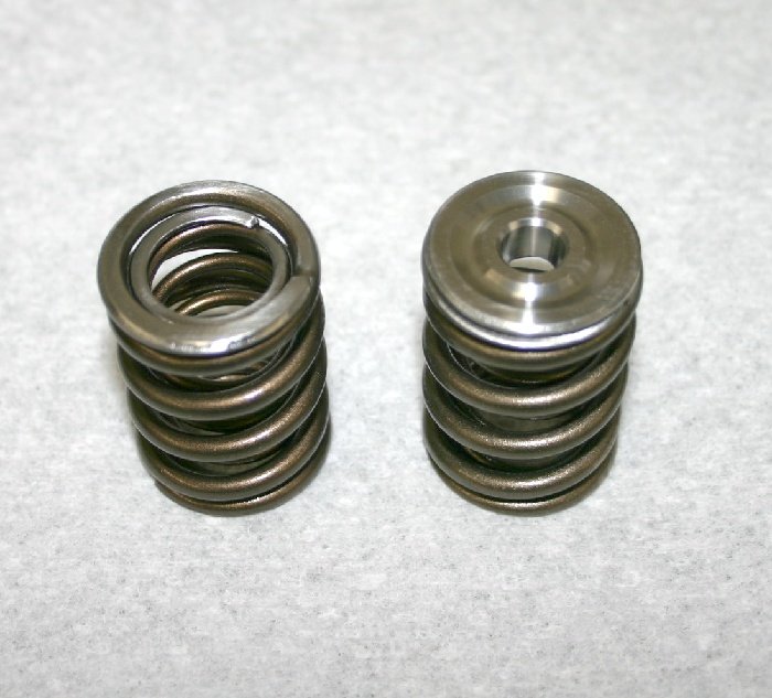

Here is just ONE of the hundreds if not thousands of points of detail. He polishes the valve springs where they meet the keepers. This reduces friction and therefore heat and fatigue.

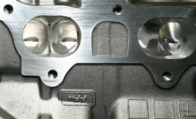

Here he shows the exhaust ports after EXTENSIVE work including welding to change the shape and then CNC porting. Even so he offers the picture to show there are still areas that he does NOT touch!!! Hogging out a port is NOT the way to make the best port. Understanding the goal and understanding the port is critical.

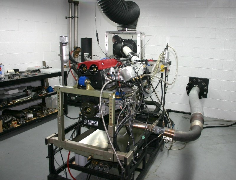

Engine in the Endyn dyno room. Notice the attention to detail everywhere. Notice the intake air is actually from a controlled sealed chamber that measures the density/pressure, temperature and humidity of the air before it gets to the engine. All important to know when developing and comparing data.
