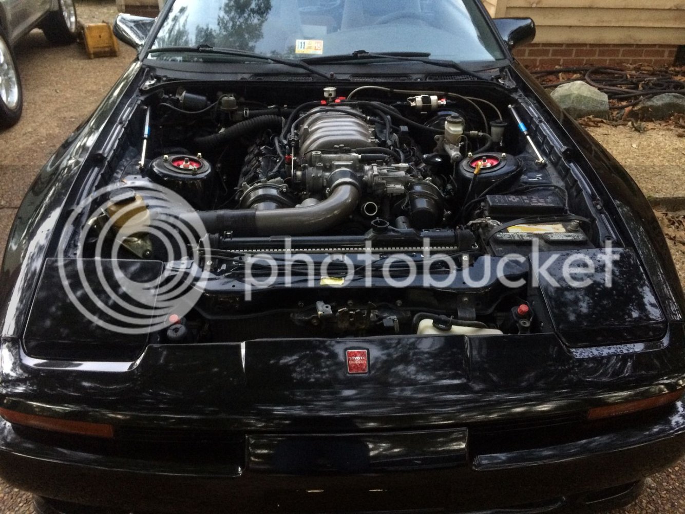

I'm running a 3uz in my 90 supra.
My exhaust is 2.5" pipe with an x-pipe right after the trans. Then it transitions to a y-pipe just before the differential and a single pipe up to the 2.5" free flowing magnaflow muffler. Sounds really good but just a little raspy around 5k rpm. Might install two resonators just before the x-pipe.
