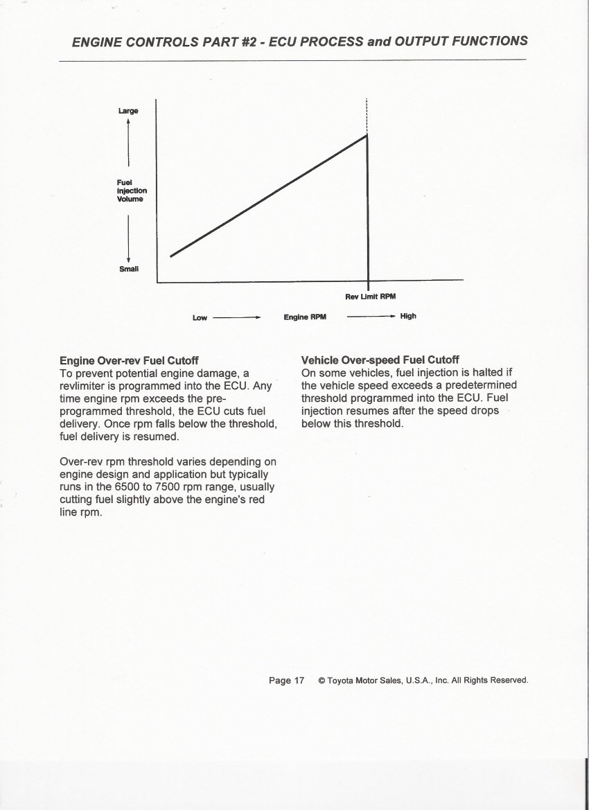

AFA defeating the stock systems to trick it into working? I don't think it's possible without some sort of reprogramming on most ECUs. If they ahve a hard rpm limit programmed in - that's it. EX: 7000rpm = 7000rpm no matter what you do!![Smile :) :)](https://cdn.jsdelivr.net/joypixels/assets/8.0/png/unicode/64/1f642.png)
