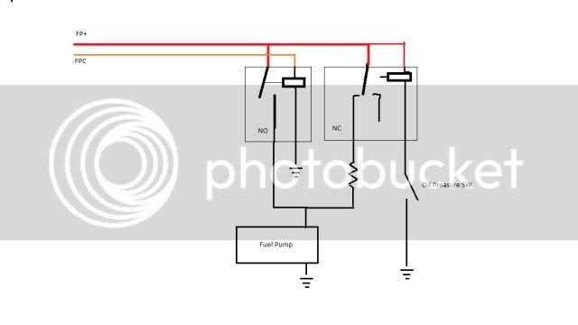

hi guys,
i have hooked up my fuel pump using a relay driven by the fpc wire from the ecu
Its a solid state relay that will activate with an input of 3-32V.
the engine will start and idle for a few seconds, then start to die, then pickup, then die...
Anyone have any ideas what the DI and FPC wires do? or how to wire this up so it works?
when i measured them before i connected the relay it looked like the fpc wire went to 12v on cranking then dropped to 4v, but i might be wrong.
Thanks
