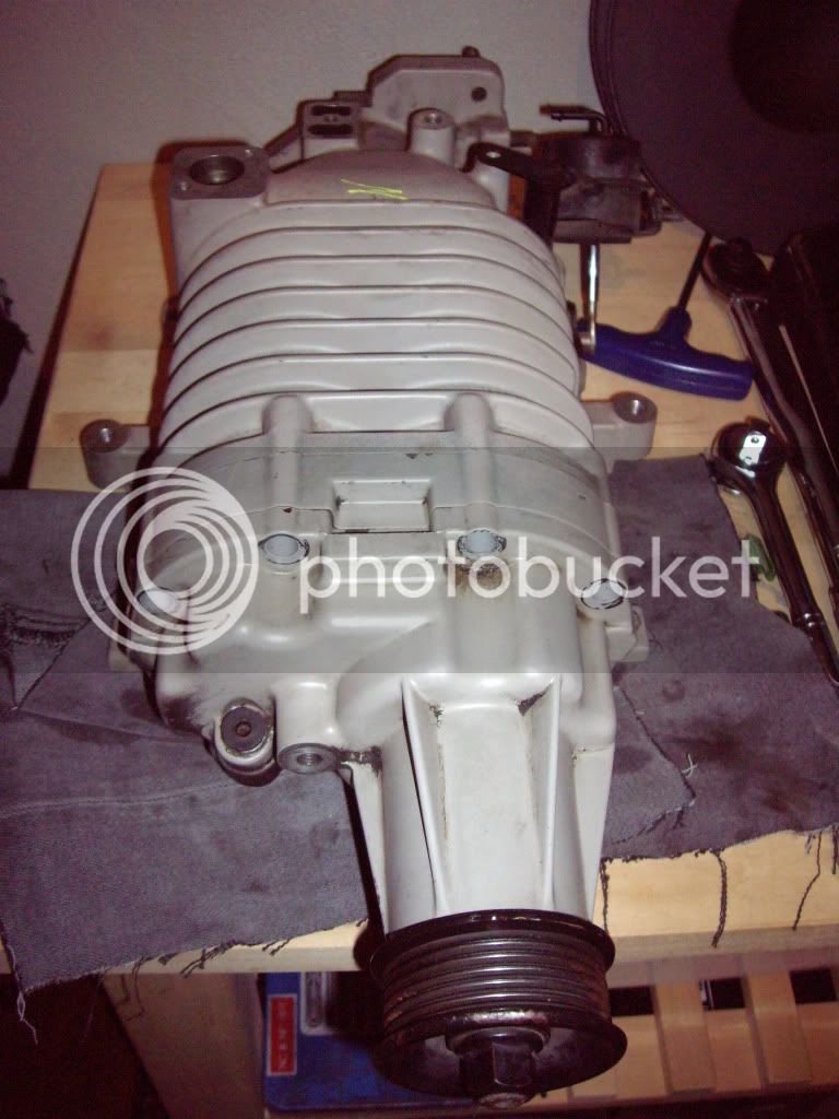

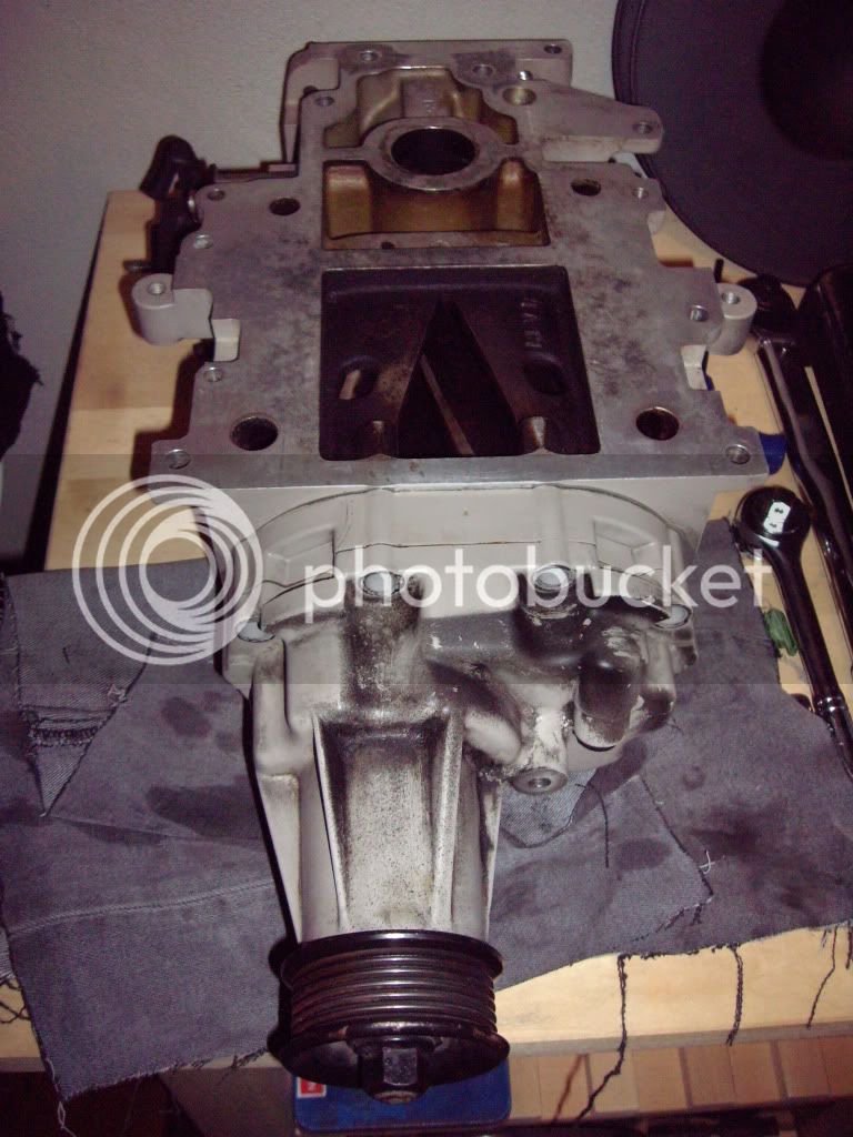

On a side note I did pick up a supercharger. A friend had this sitting in his garage so i offered $80 for it. On first glance I was sure it was an M90 but now I'm second guessing that its an M62. Thoughts anyone?
nice little blower for a honda engine but waaay to small for a UZ. Like stated above, even the m90 is struggling to meet your numbers. If you check craigslist daily, I can almost guarantee you'll find an m112. 400bhp is totally doable at 8psi with cams and a rising rate.

If your willing to fabricate, the m90 should't cost much at all. Your right about the LS400 centri blowers, there is about an inch in from radiator to blower inlet so intakes are impossible. I originally had my LS with this setup and later transferred everything to my SC and now I have a 4" intake versus a screen hah.
Is your m90 a side inlet or top inlet? If you can snag a side inlet, you can work around the stock hood but if its not a concern, pop that baby out hehe.
