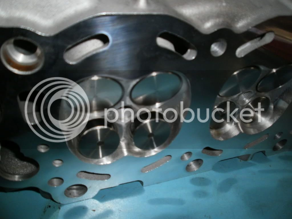

Finally have heads back from being assembled with 2mm O/S 1JGTE stainless steel valves, shimless buckets, Brian Crower 2J valve springs..
![celica024.jpg celica024.jpg](https://www.lextreme.com/forums/data/attachments/19/19535-2f87c269edd8f094f435d9950624bdd6.jpg?hash=L4fCae3Y8J)

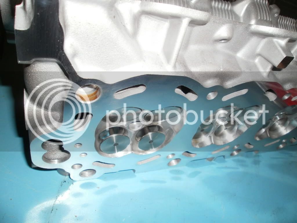

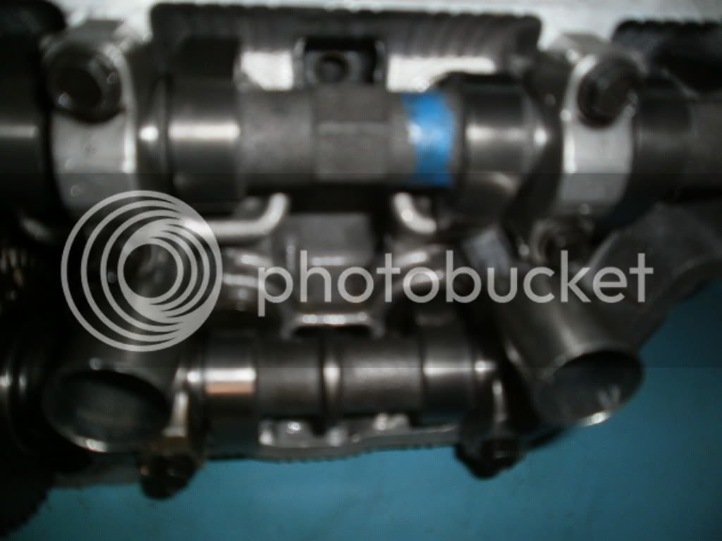

Just under 10 mm lift..Yes heads are CNC machined..

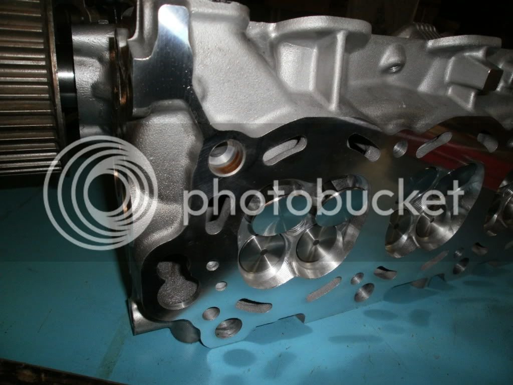

![celica026.jpg celica026.jpg](https://www.lextreme.com/forums/data/attachments/19/19537-0692a199a4be9418dbc6f73ac8a6fb71.jpg?hash=BpKhmaS-lB)
Cannot see the expense or parts here...120Lb seat. Should be good for 25Lb boost..
