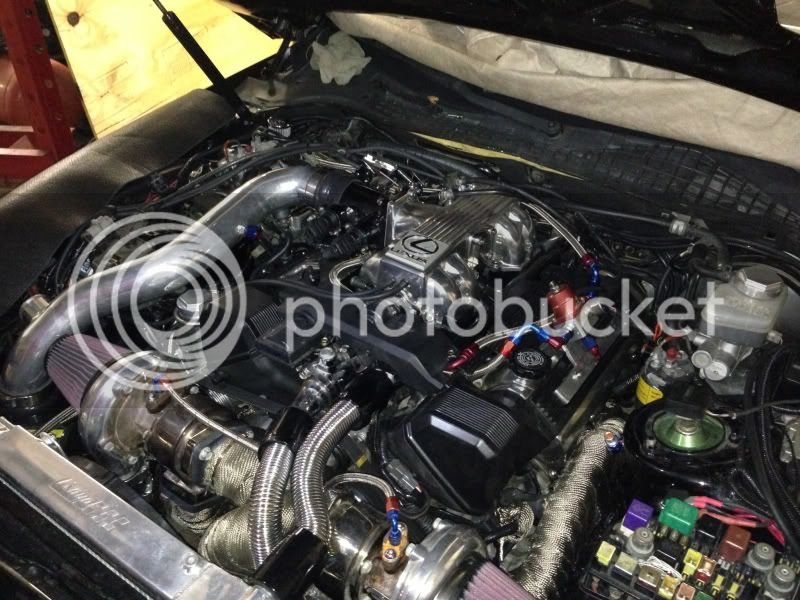

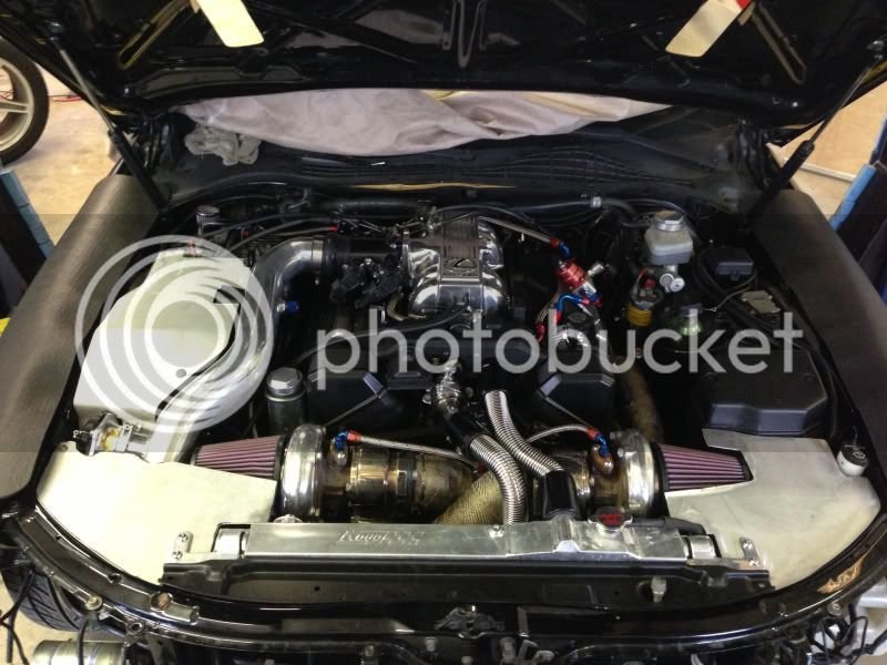

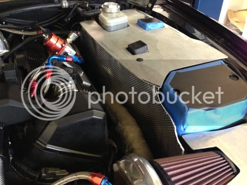

This is without the stock covers, and with DEI high heat wrap over the spark plug wires. Notice the injector leads on both sides as well as the area around the IACV.
now with trimmed engine mounts which will be coated for final product.

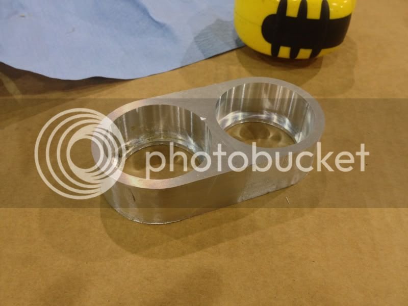

New billet cup being machined for dual Denso Supra TT fuel pumps.

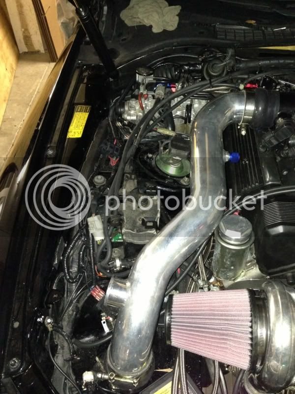

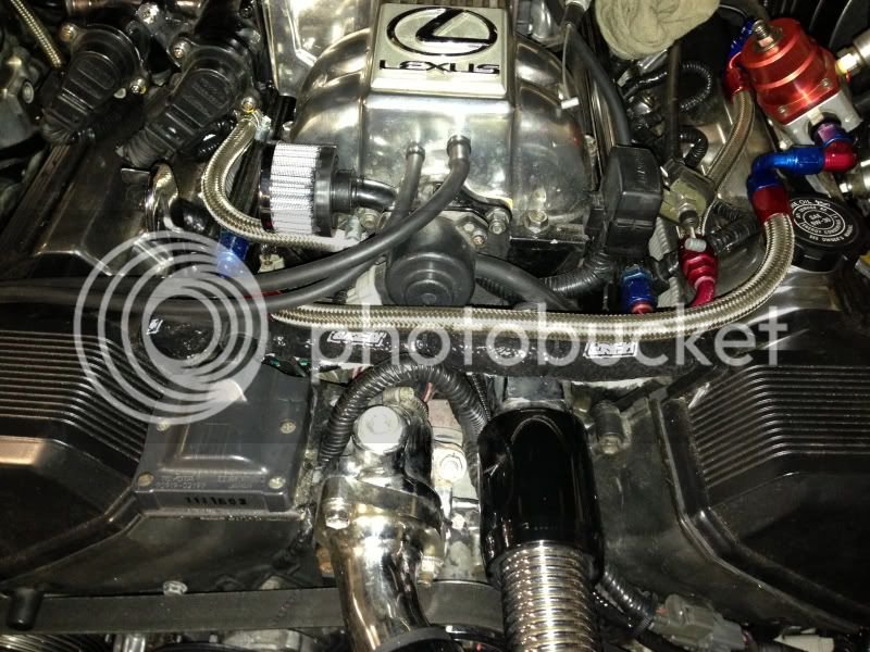

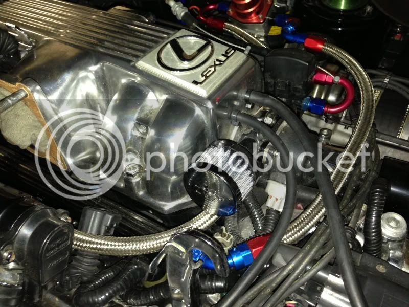

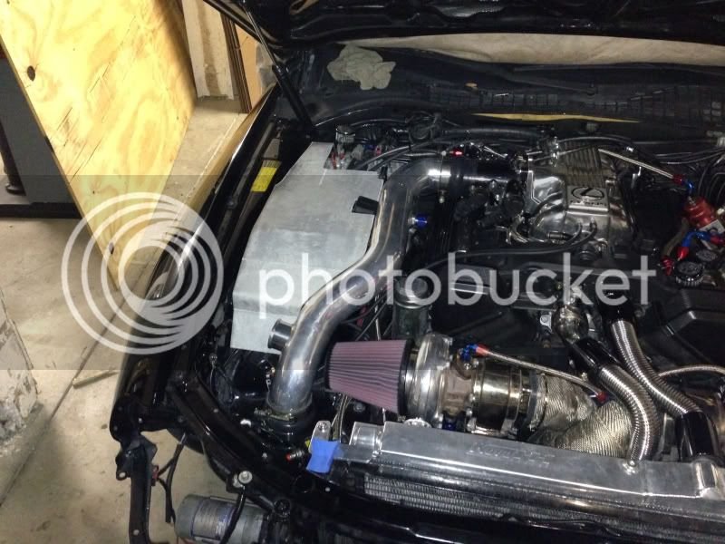

New K&N filter for IACV. Notice the unwrapped and uncovered spark plug wires.
Notice the whole area in front of the IACV with the covers in place.
Notice K&N filter in far back for oil catch can.

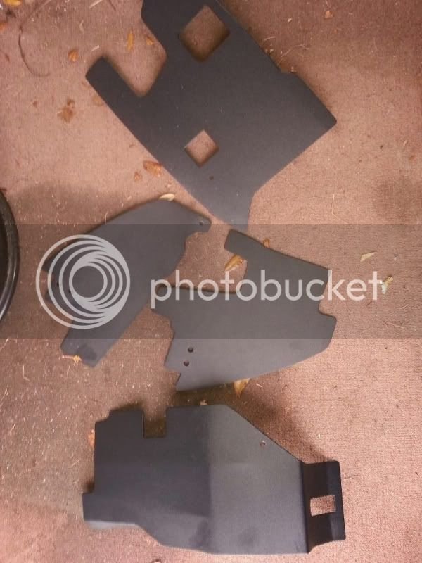

First cover being fabricated.
2 more covers now fabricated. Almost completed with engine covers.

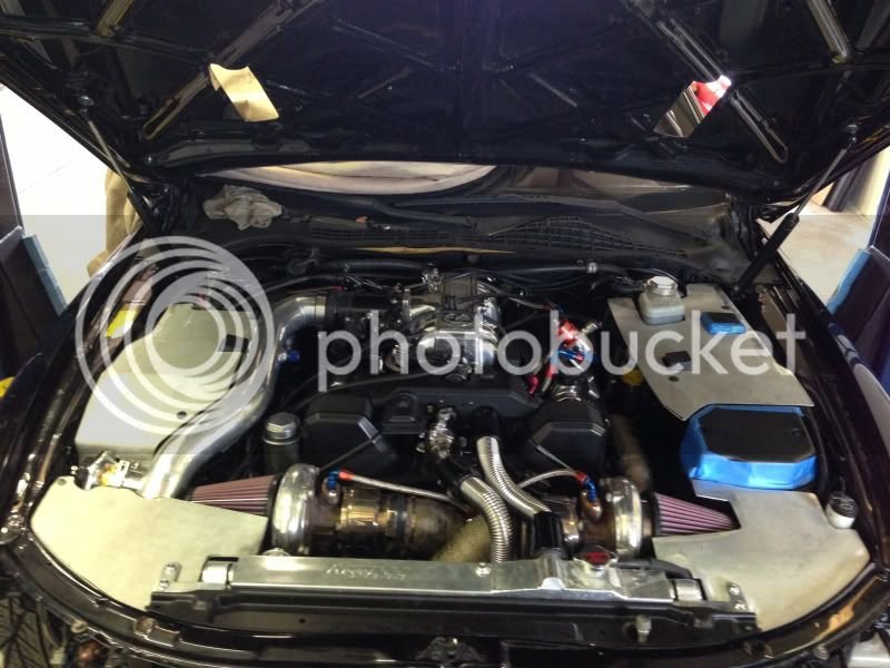

A few more updates with Pics
A few more updates (Pics), cutting to the wire for the show...
All 4 engine covers now fabricated and test fitted:
Powder Coated (Bad lighting and some shadows showing):
DEI High Temp Heat shielding:
Turbo shields as SS and will be polished:
Coil Pack and leads shielded:

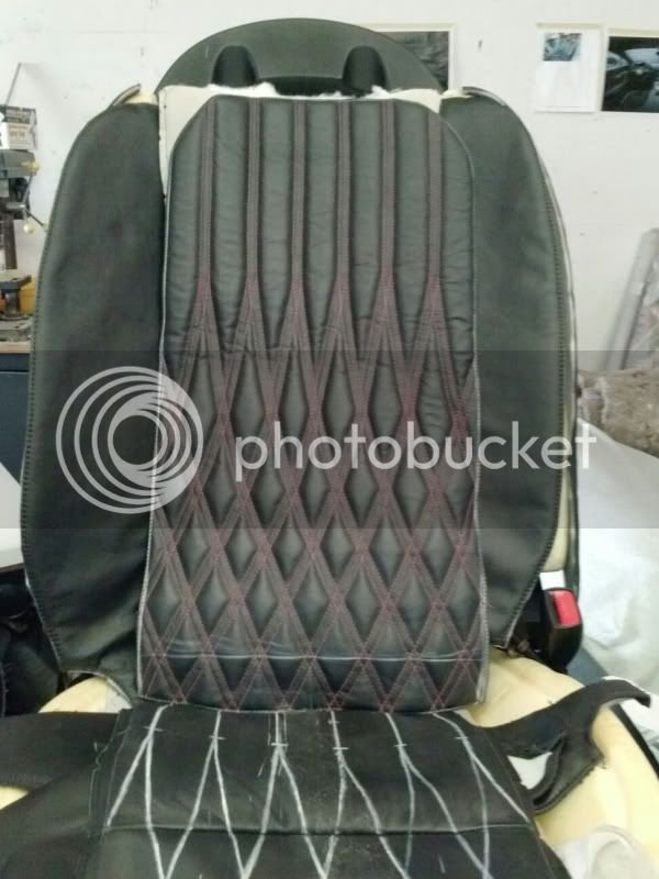

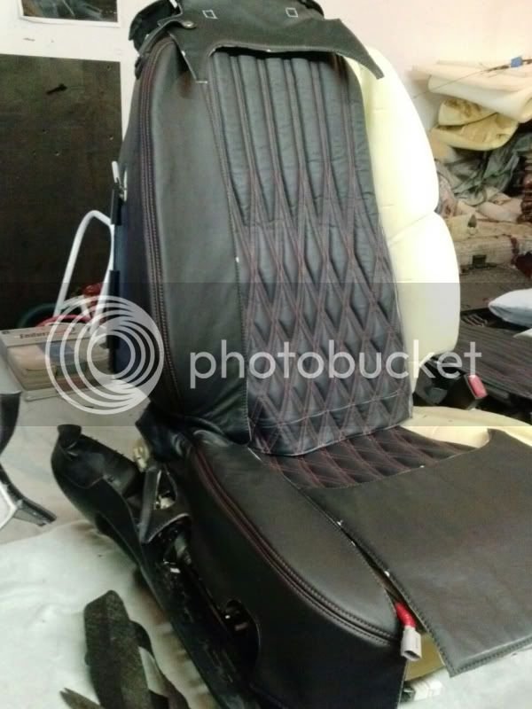

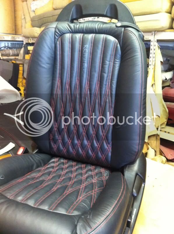

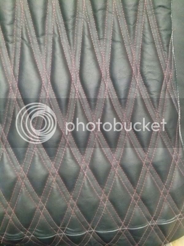

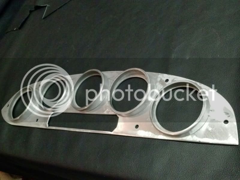

Here are a few pics of the new leather and pattern, SC430 seat cushions being modded and gauge pod being reworked. Note the grain and quality of the leather...I will have enough left over to do another SC. Side bolsters on SC430 seats will be one piece, not two, as in original design from Lexus...
Pattern:

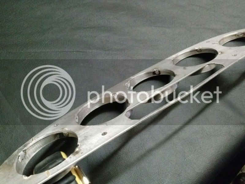

Pod faceplate will be 3 dimensional and not flat. No wood, Satin Black finish. This is the base, the sides of each aluminum ring are being built up and contoured:
Welded on the rings:

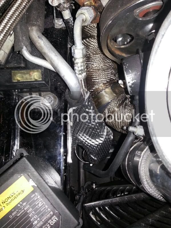

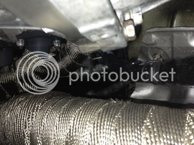

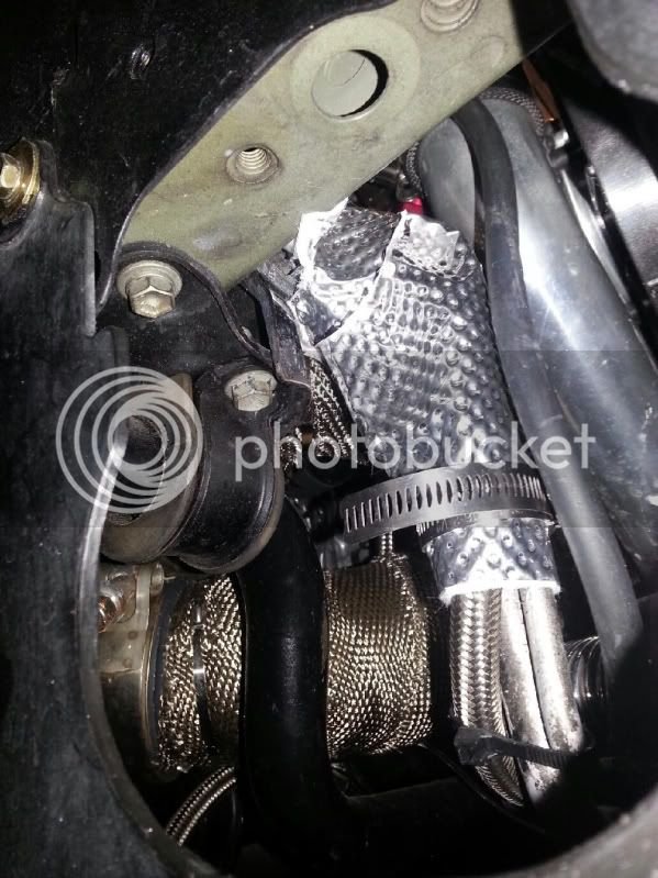

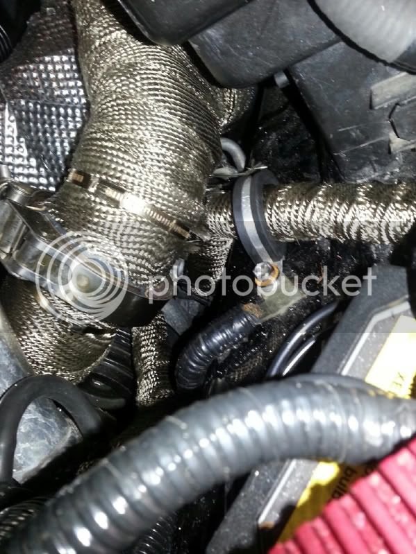

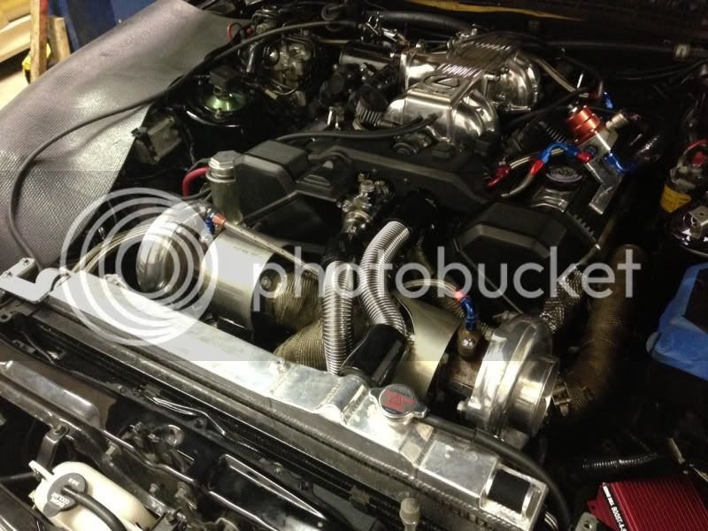

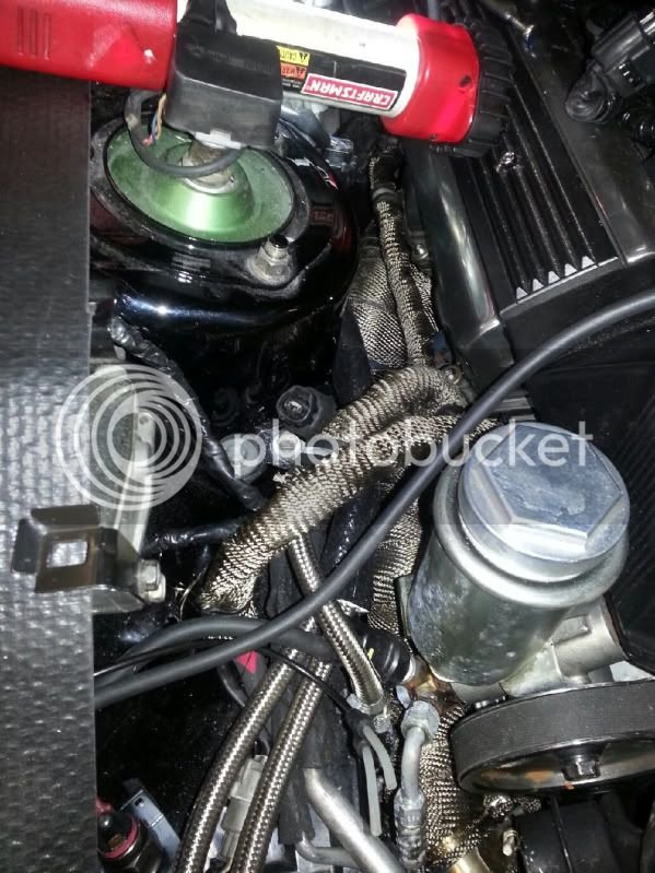

Heat Shielding Pics
More heat shielding...The front mounted turbos create massive heat, so the car has been carefully gone through and had the SS braided hoses to the transmission and the fuel return replaced with new ones, re-routed and wrapped and shielded for added protection. Should be no issues at all now...
the problem your going to face is the heat can't escape, a mate had a single turbo L98 6ltr supra and after an unrelated incident when it all got pulled down all the wires (Tefzel!) where starting to melt behind heat shields and firesleeve.
the only way i have seen front mount turbo v8's work well is when all lines are hard lines and anything plastic is moved out of the engine bay.
example:
http://www.nelsonracingengines.com/the-gallerry/NRE-Twin-Turbo-LSX.html
Ceramic coat hot parts, some shielding and have elect wires at least 100mm away.. That crinkle cover conduit doesn't stand any heat, just cable tie critical area..
Is there any kind of turbo blanket underneath the metal heat shields? Adding a blanket in between would contain even more of the heat.
The best mod I ever did to drop underhood temps was adding a true drop vent hood (seibon TS-II) for the SC. The vents are placed directly above the turbos and allows more cross flow (and reduces front end lift). I never had turbo heat to worry about (centri blower) but adding the hood alone dropped temps enough to where you could leave your hand on the blower w/o burning hands. Previously, your hand would catch fire it due to the heat soak. You could also see massive heat waves rush out of the hood at stop lights. The 2 vents at the rear of the hood definently help but maybe they are to far away? Its too bad you are not near Davids area as I could have let you try my Seibon hood (sold my SC, hood is just sitting) but it sold it last week. Car looks beautiful BTW.
example:
Thanks for the link. That is why I vented the hood. Will vent it even more if I need to. Rerouted plastics much farther away...
All hot parts are double ceramic coated...hopefully, the critical stuff is now far enough away...
Yes, turbo blanket going under hood. Will vent hood more if necessary.

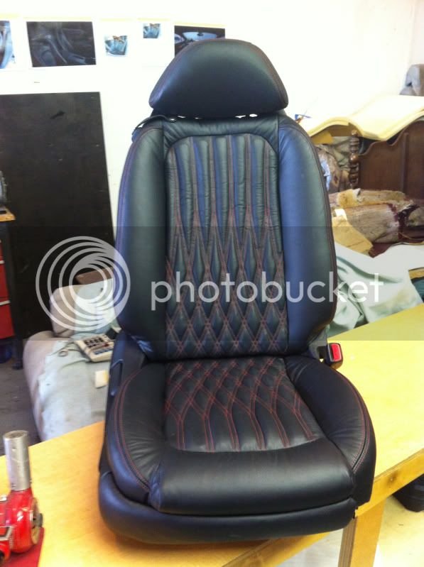

The SBN (Spring Break Nationals) are nearly upon us...This Saturday. I have to roll the car in between 1 pm and 6 pm. A lot to finish...it will go down to the wire. Late nights coming up, especially this Thursday evening. The front seats should be complete as they were being final fitted yesterday afternoon...They were getting the wrinkles out. The rear set covers were already cut, stitched and ready for installation. They also were working on the front and rear door panels and the center console...the whole thing should come together nicely and flow well...
Front seats (Wrinkles still have to be removed:

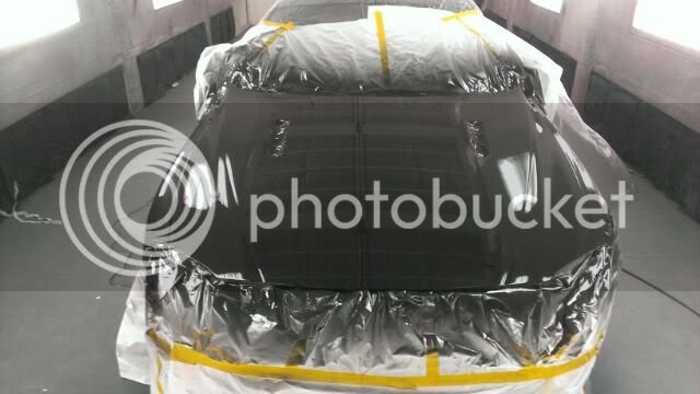

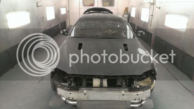

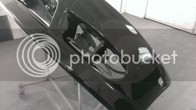

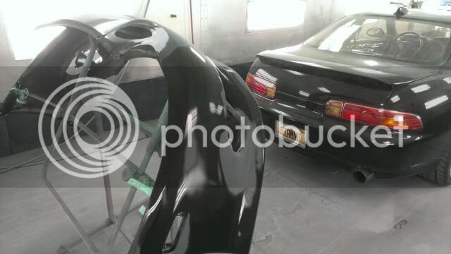

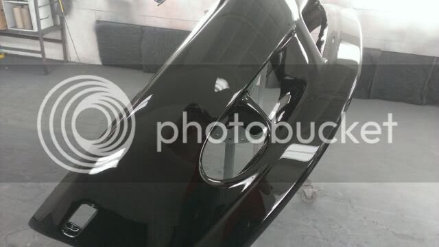

The car was in the paint booth yesterday for final paint repair to it. Final sand, buff and glaze to be done on Tuesday and Wednesday.
In booth:
Once completed with the paint shop, back to Raw Brokerage on Wednesday afternoon for final mechanical and engine bay work...The final and Big Tune by Darin will have to come after the SBN as there is no time to get it done before.

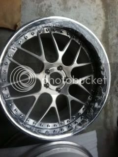

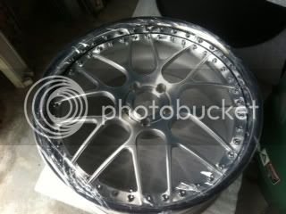

360 Forged Mesh 8 Wheels
Wheels are made and shipping out tomorrow...Here are some low res pics...
20x11 rear:
20x9 Front:

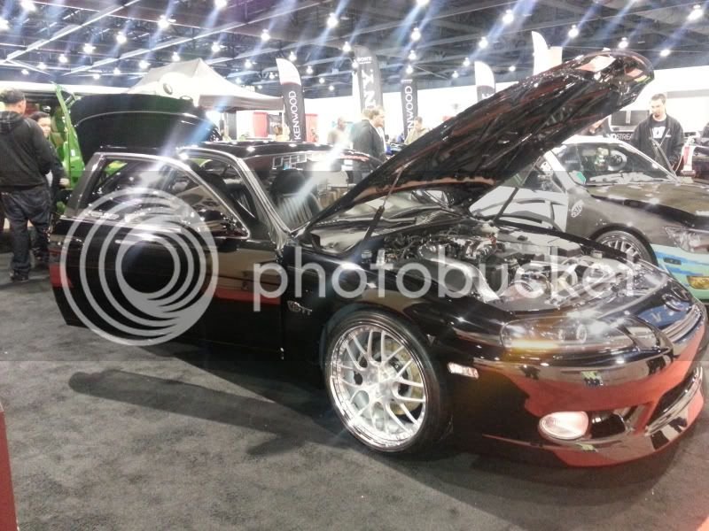

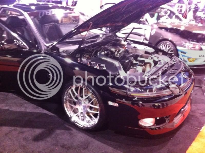

Hey gang, my first official show. I haven't been judged yet, but whatever happens, I am excited to be there and to anticipate. It was a huge amount of work and effort by many fine people...To the guys at Raw Brokerage, thanks to Dan Osypian, Fernando, Sean and Ricky. Special thanks to Dan for working late many nights to get my car done. He barely got sleep or family time for the last few weeks. To Fernando, great to get to know such a great guy...He stayed up all night with me on Thursday to get the car completed. I could not have. Finished without him.
To the guys at Car-O-Van, awesome work! You guys are not a simple insurance shop, but an awesome custom shop with a can do attitude. Special thanks to Chris, Sam, Manny, and "giggles". They worked tirelessly to ensure my paint and body work was completed on time. I would recommend them for any level of paint and body work needed.
Thanks also to Alian Bandamo at 360 Forged for the awesome work on my wheels and getting them finished in time. The wheels look sick!
Here are a few pics. Also, this thread is about to be finished after so many years and posts...Thanks CL and CL member for supporting my efforts to get this project to this point. I will get a clean and proper Dyno tune soon and ps that up. I will start a new reveal thread with high quality pics, but for now, enjoy these...:)
