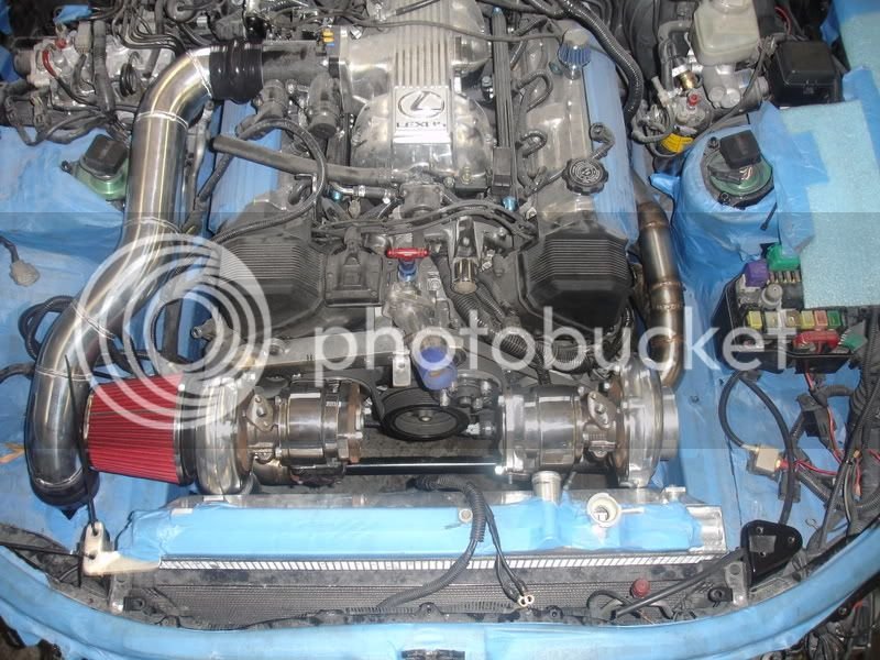

Well guys, I know some of you have been wondering what is happening. I did have to remove my car from the last shop, and all of my parts. But let us not talk about that for now. My project is continuing, and I will get it done, God willing...smile.gif

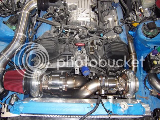

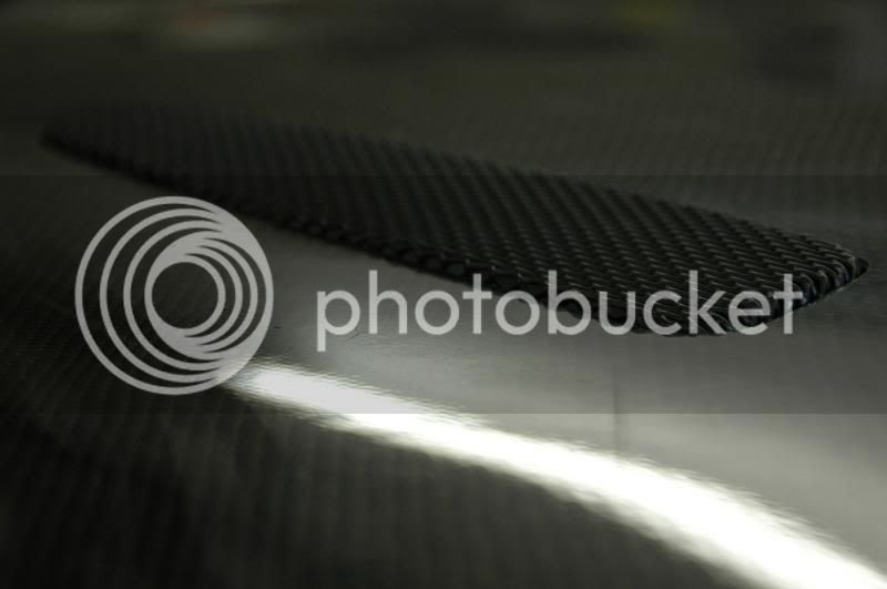

Here is one pic to let you know that it is continuing:
Much more to come, soon. I will keep you updated. Mike did a phenomenal job up to this point on my car. Once it is finished, I will let you all know who the fabricator is that is finishing my car, as well as the painter. Both are absolutely top notch.

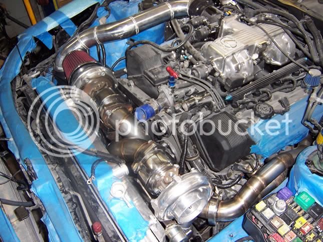

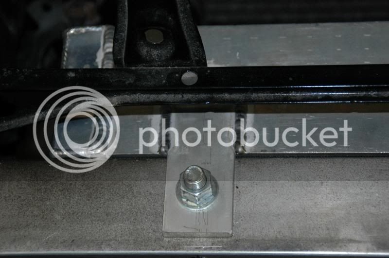

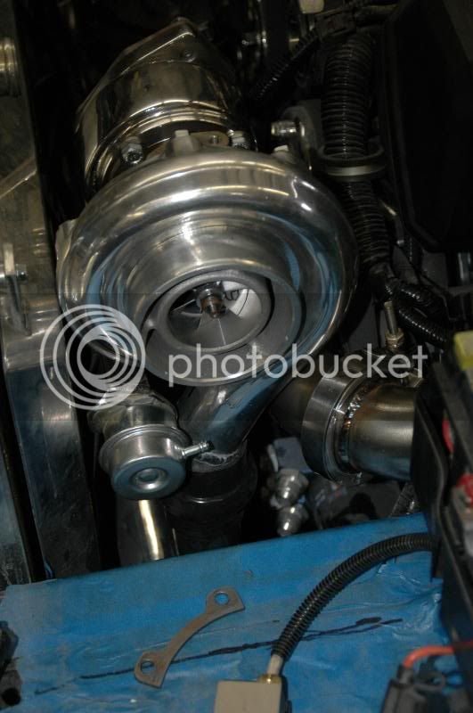

A few more:

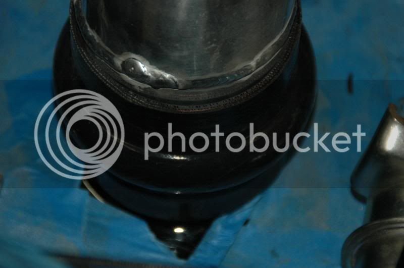

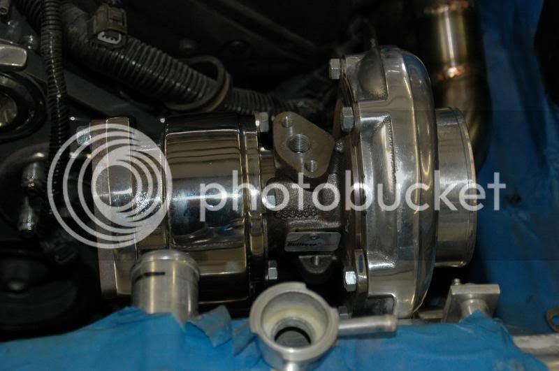

Bullseye Power BW Turbo close up, polished SS Turbine housing
Relocated the actuator and the arm to fit in the limited space

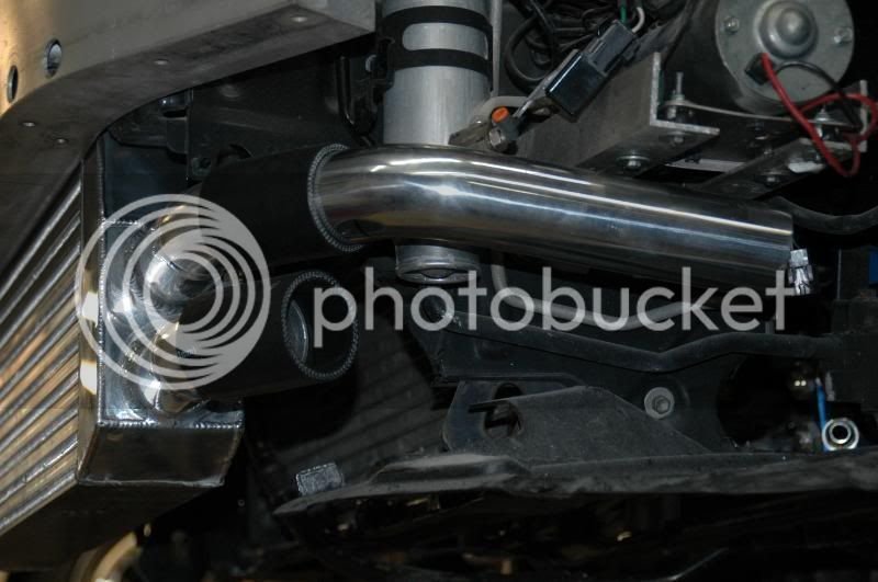

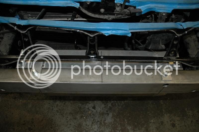

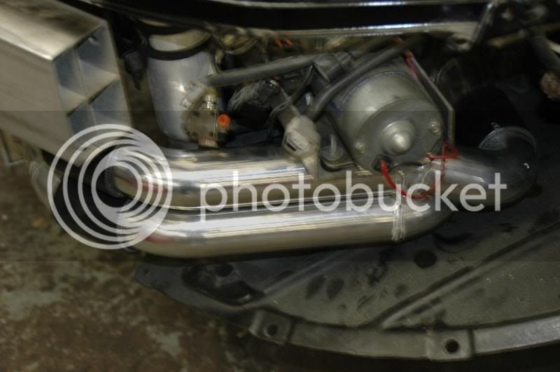

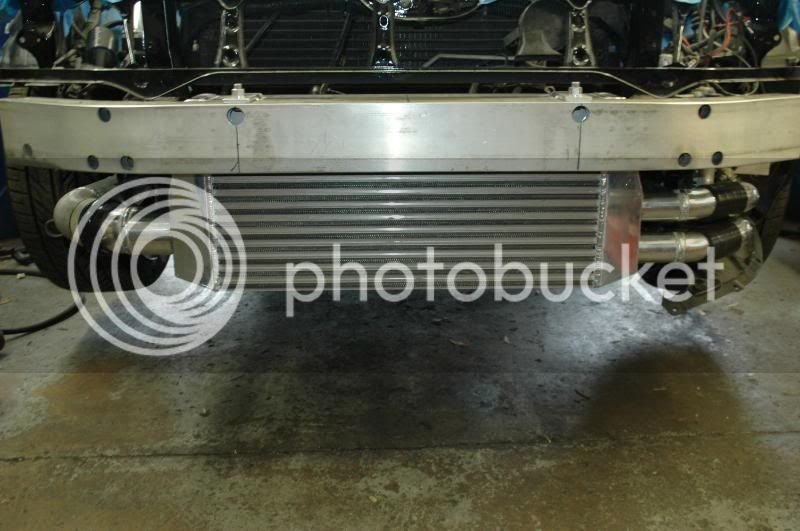

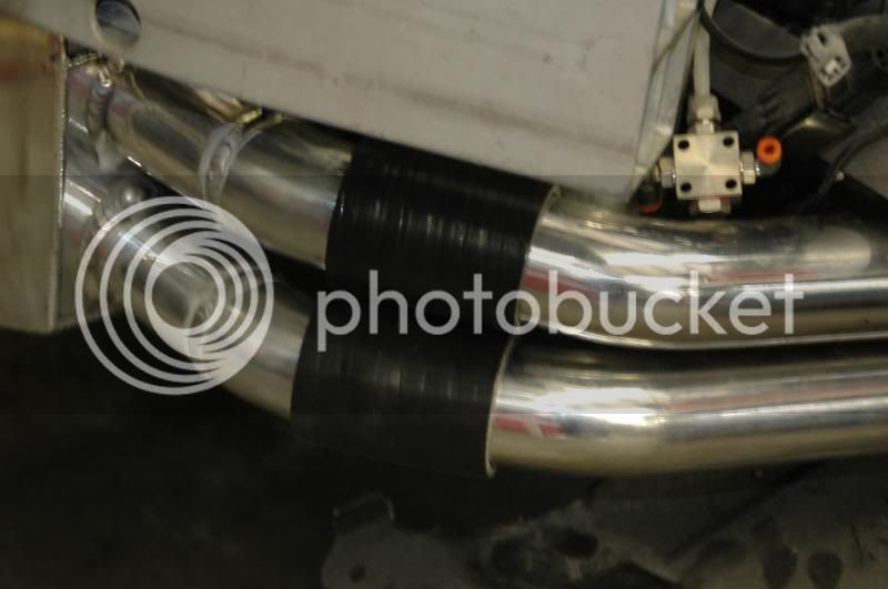

I thought you forgot that your project is still going on. LOL. For the intercooler on the outlet size (the intake size), I think it would be better for the wall angles to be rounded and smooth rather than its current sharp and boxy angles. I'm afraid its current shape will create air turbulence more than usual, and its velocity will be slower. This drawing is what I believe will create smoother and faster air flow.

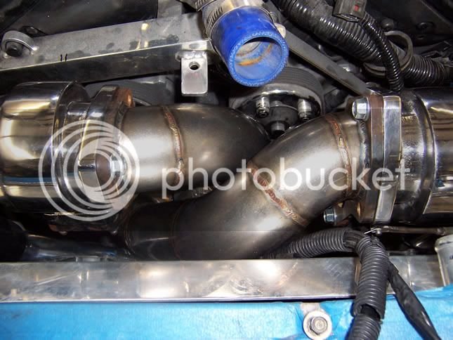

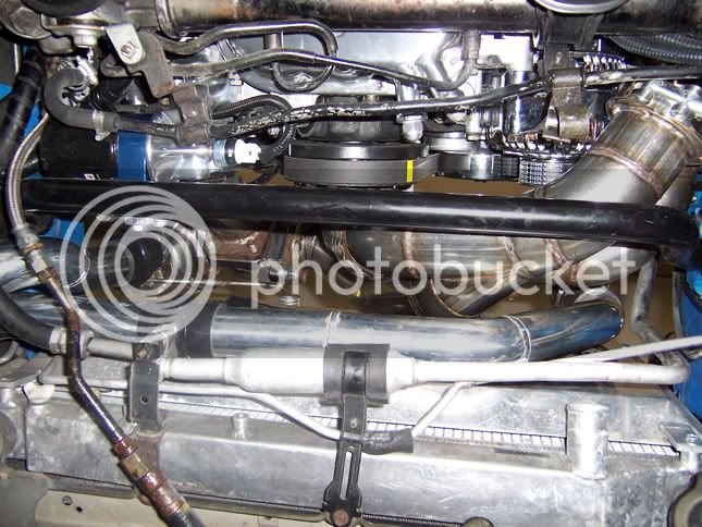

Continued progress, I expect to have all the plumbing completed by the end of this week...For real... :)

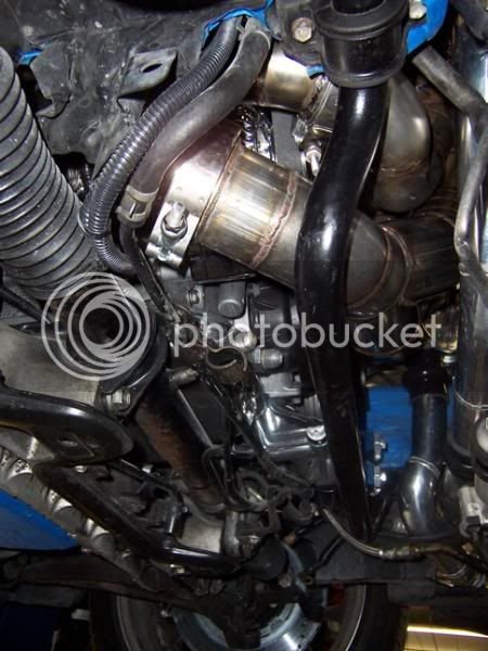

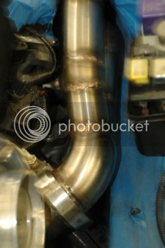

Downpipe completed:
More to come...
