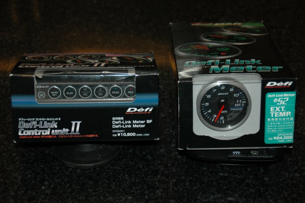

Decided to pull out the stops on the gauges...Installing all DEFI gauges except for the AEM Wideband. Total of 4 Defi's and 1 AEM. Custom place for the other two locations...Watch and see...biggrin.gif
Defi Link Control Unit II and EGT Gauge
EGT Gauge

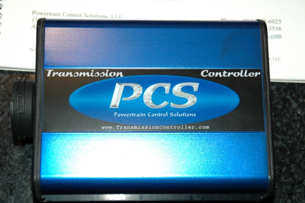

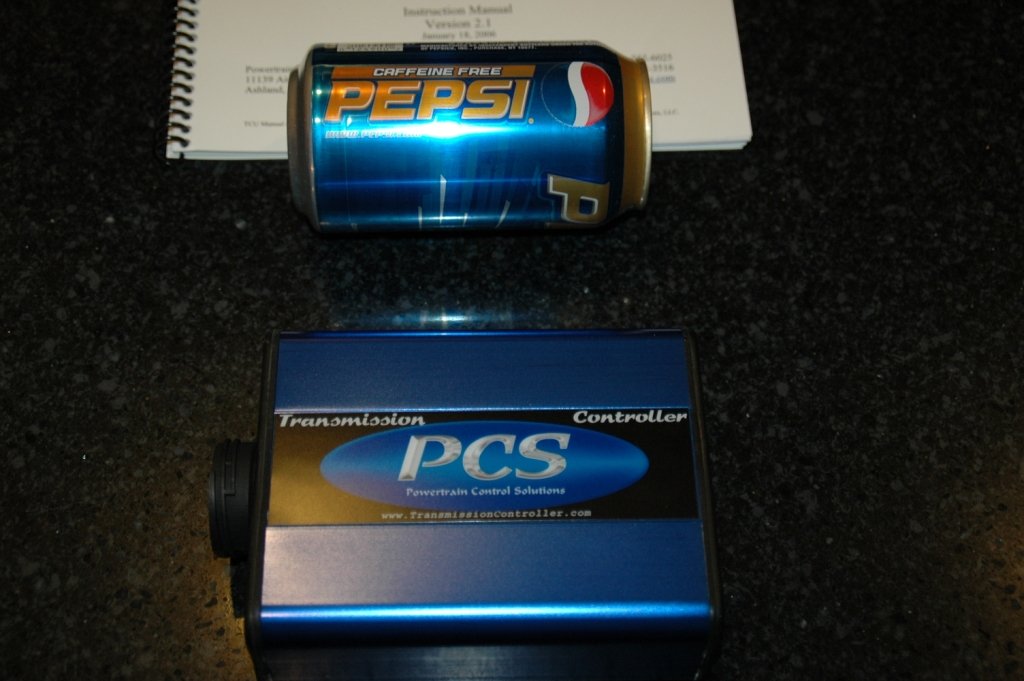

Gang: I received the Transmission ECU...woohoo.gif Powertrain Control Solutions builds the best Automatic Transmission ECU on the market!! I am excited to add this to my project car. I am now even more convinced that this is the way to go instead of a 6 speed swap...A BL built A340 transmission and a PCS controller...biggrin.gifthumbsup.gif
Enjoy the pics, much more to come. Car is in the paint shop right now...thumbsup.gif
Controller
Controller and manual
For size comparison

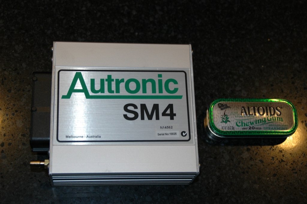

Gang, the Autronic SM4 is arriving at the dealer tomorrow, and will be shipping out to me, right away. They will ship the harness to Dr. Tweak of Phoenix Tuning, and he will work his magic on the Plug-N-Play harness for both the PCS and the SM4. I had Dave Frost of East Orange Customs weld an enclosure of matching sheet metal in the baffle area where the air box was. I did not like the way it was cut out to fit the 3" IC return to the Intake...The hole was gaping, and it would allow large amounts of water, sand, dirt, bugs, etc to pour into my engine bay. So, David welded it shut, and welded a 3" tube into the baffle repair, and now the structural integrity is as good as new in that area, and the steel pipe he welded will be primered with a special priner, and then painted with the same PPG paint. I will post pics up when completed. I know it seems like a little thing, but I am a detail oriented man, and I like doing the "little" things right just as much as the big things...
The engine bay should be painted this week, then I can install my engine and tranny back into place. I am looking forward to it. Then, my car ships to Driven Concepts in Tampa...I can't wait to see their completed work.

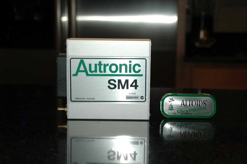

Gang, one of the most important parts of my build has come in...The infamous Autronic SM4...I got it from TNT Motorsports in California, an authorized dealer for Autronic. The SM4 is not cheap, but it is by far, one of the very best in quality, features, flexibility, and reliability of any stand-alone engine management on the market...That is why I bought it.
It will work with the stock ignition system, or convert to CDI, if I want to. It will work with variable valve timing, and it offers traction control. It has a built in MAP sensor, so no MAF to deal with, and it has probably the best and easiest Auto-Tune feature of any ECU on the market. It offers very precise control of injectors and ignition angle at very low or high rpm or manifold pressures. This unit ensures excellence in how the engine operates at low or high rpm, so idle is also very smooth, even with the 96 lbs injectors I am installing...I could go on, but go their website if you want to know more...I am not selling the unit, I am just telling you a few of the many reasons why I "bit the bullet", and bought this ECU for the V8. Plus, several Aussies have used this very unit to control their Forced Induction Lexus 4.0 liter V8's, with great success...So that means there are several Fuel and Timing MAPs already in existance to start off with a Base Tune, before fine tuning. I will be able to literally upload the MAPs to the SM4 after installing it, and start the car and drive away within less than an hour of doing so. The car should start up, idle, and drive smoothly on the street. For boosting, I will still put the car on the dyno, to review the Fuel MAPs and to fine tune the Timing MAPs.
TNT drop shipped the manual, the sensors, and the harness to Joshua at Phoenix Tuning so he can work his "wizardry"...He now has both harnesses for the PCS ECU which controls the transmission, and the SM4. Plug-N-Play Baby!!!!!!!!!!!!!!thumbsup.gifbiggrin.gifthumbsup.gif

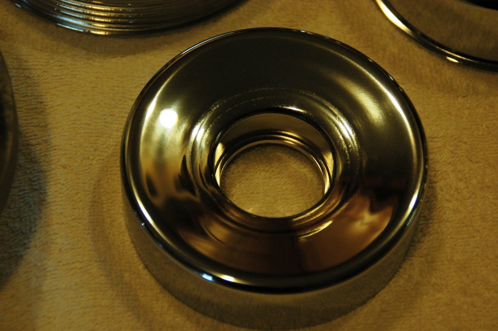

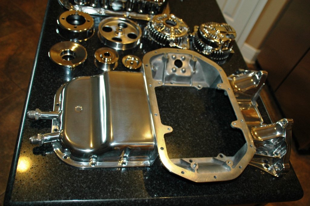

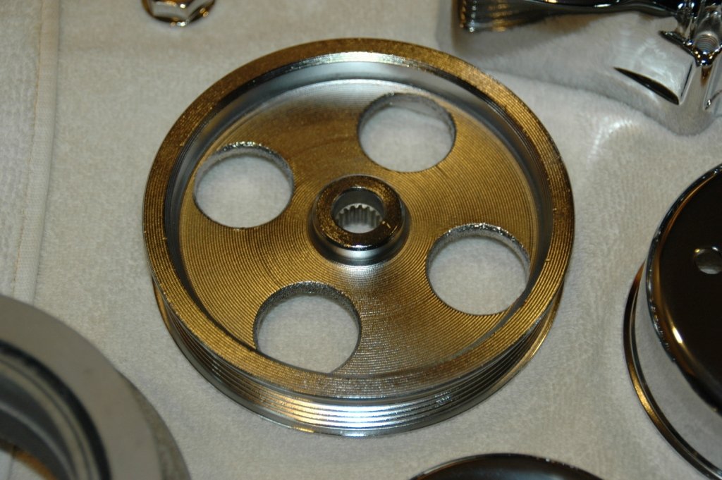

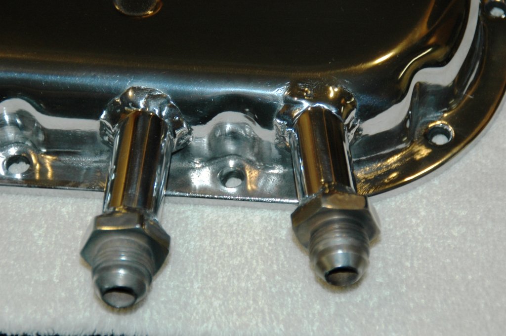

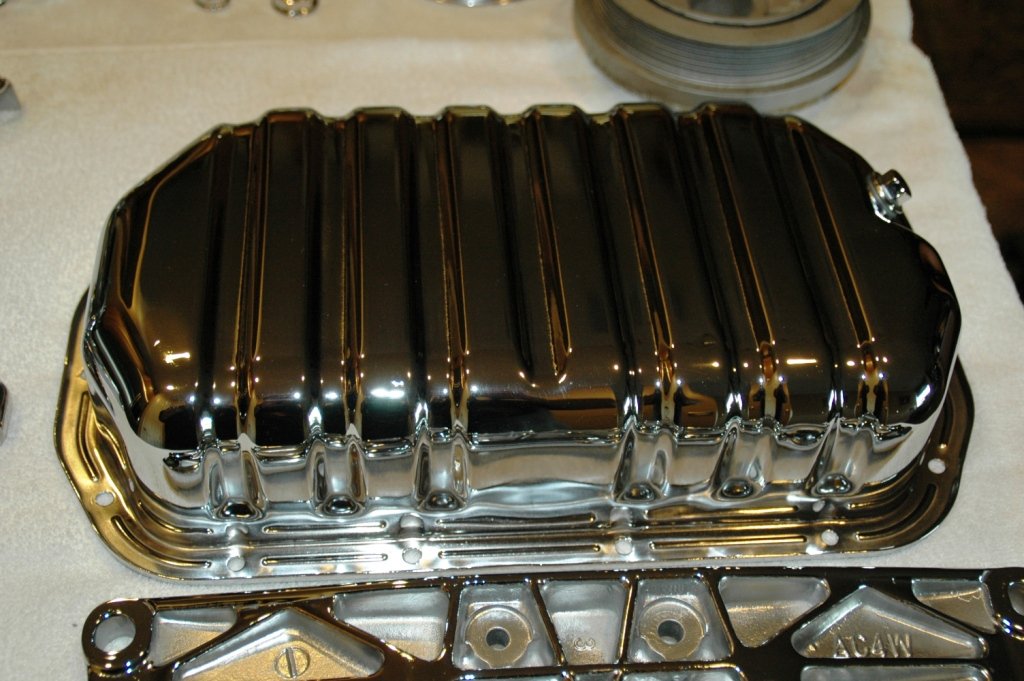

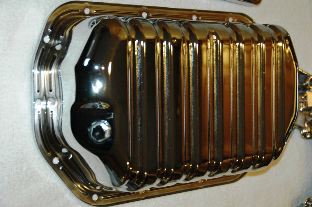

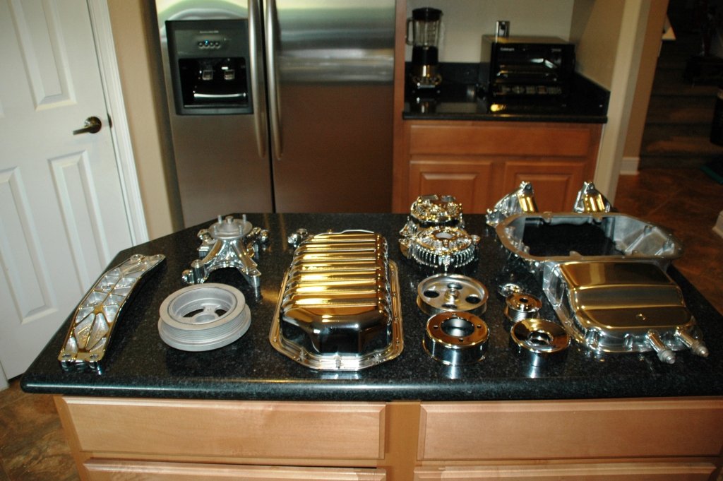

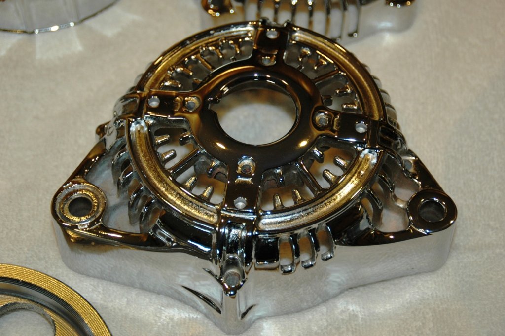

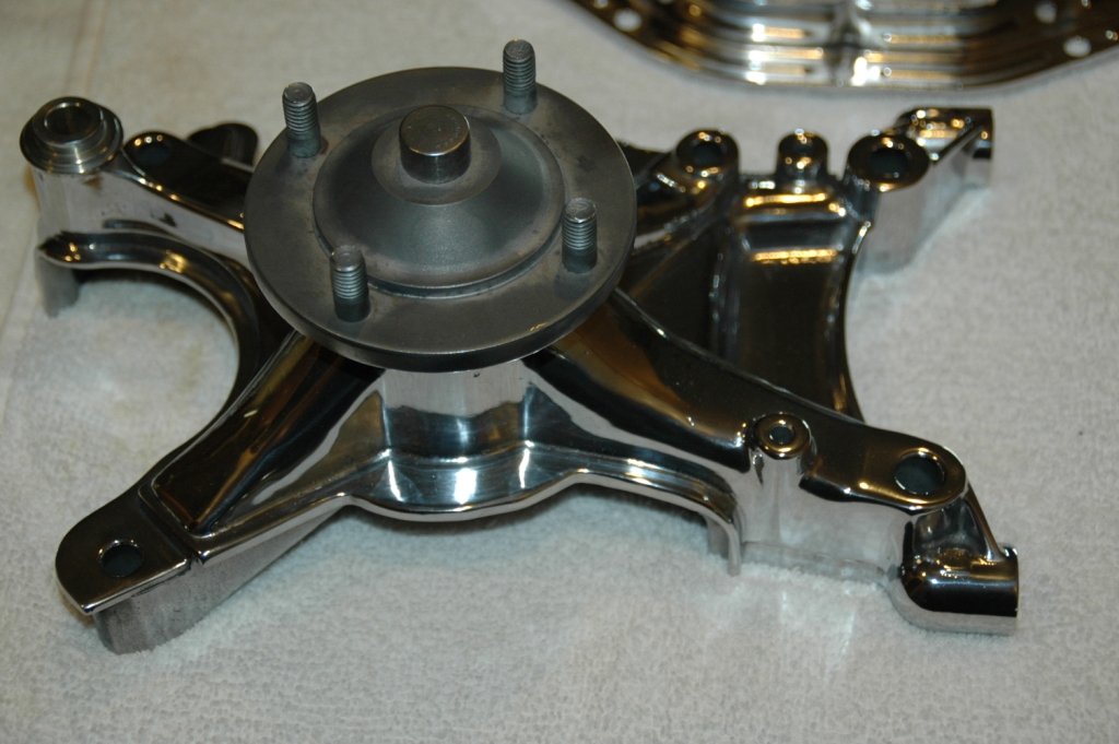

Gang: I picked up some of the chromed, polished and sand-blasted parts for my engine today...I have some pics for you. Keep in mind that I haven't learned yet how to set my lighting on my Nikon SLR, so the pics are only average...

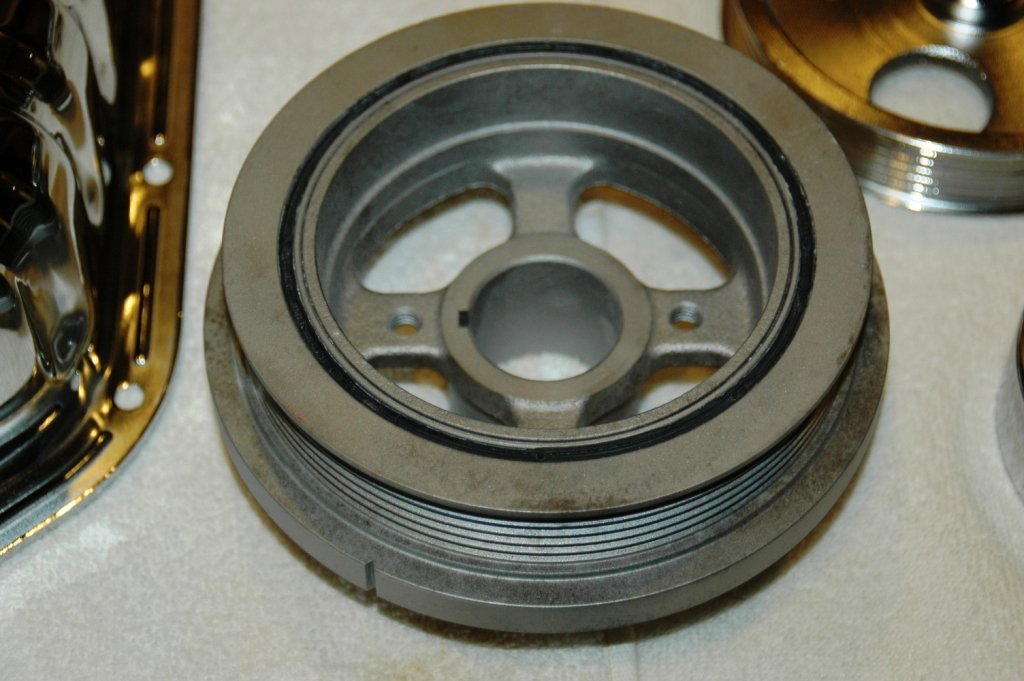

This is the harmonic balancer...It cannot be chromed or anodized, or powder coated due to the rubber ring built into it. I had it sandblasted, and it will be painted.

Here are the rest of the pics:
