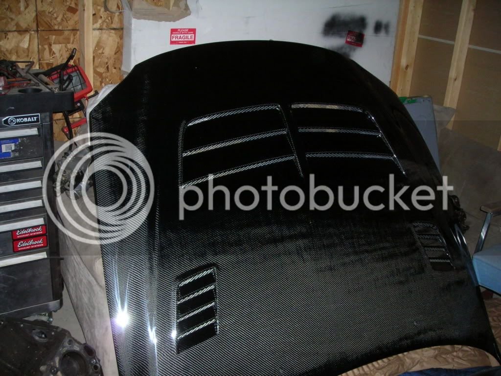

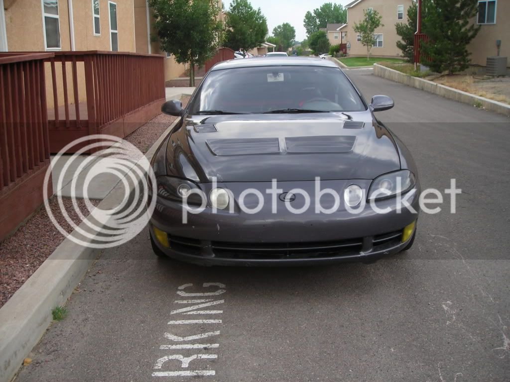

You should install the hood pins to hold down the CF hood. There're several situations where the hoods flying off. If your hood is 1 piece from top to bottom and is very rigid with no flexing, then you probably don't need the hood pins. But if the top layer is glued to the bottom layer, then you need them for sure. Some CF hoods are better than the others, but don't take your chance.
I talked to a Seibon rep awhile ago and he also recommended the hood pins on his hood.
Another thing is if your engine bay is too hot, you'll need insulation under that hood. Otherwise, the heat will damage the hood.
