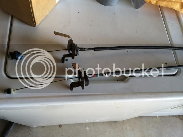

86 celica throttle cable, little difference on the stop. i cut off the big rubber piece and swapped it over.
