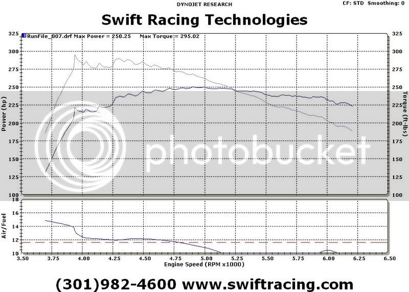

Sup fellas, dont have the sheets to show because they dont have a printer nor do I have a floppy but... I dynoed my car with a 75 shot with bottle psi at 1100psi and it made 250hp and 295 tq with it starting to run pig rich at about 4500 rpm.

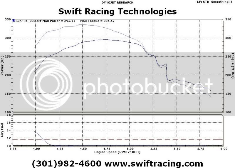

Then I did a 150 shot run at 1100 psi bottle pressure and it made 295 hp and 336 tq, but it ran pig rich throughout the entire powerband once the nitrous kicked in. I think the motor should get alot more hp than what it did with nitrous, but do you guys think the stock ecu is sensing knocking and retarding timing to where its adding more fuel?

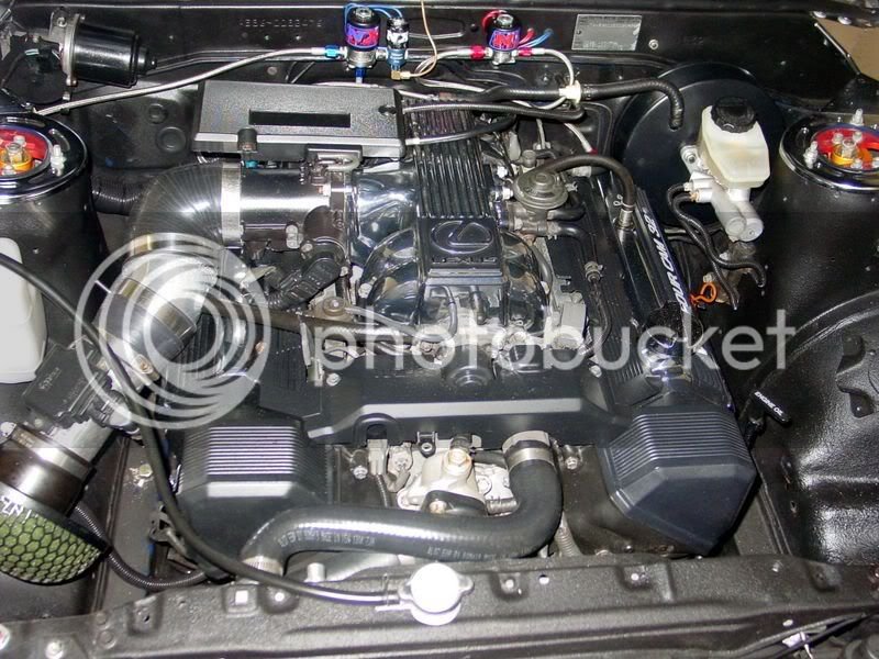

Couple questions for you. Is it wet or dry? I assume single nozzle, so where is the nozzle located in the intake track(pre or post AFM)? If its dry, what type of dry, single solenoid or dual (like NOS brand that raises fuel pressure)? Define pig rich, what is the A/F ratio from the dyno run? Any lean spikes? Pics of setup and dyno run would help,. Can they email a jpeg of the dyno, since they do not have a printer?
thanks for the reply supra, the setup is a wet kit and its located like 4-5 inches from the throttle body ( where the trac butterfly was at previously) single nozzle. The AFR went from a 13.2 straight down to a 10.0 with a 150 shot. Mind you its a stock ecu. Im going to see if i can get a copy of it this week and see if i can post it up here
no lean spikes either, I actually called NX , and they told me for a 150 shot i need to use "62" N2O jet and a "38" fuel jet, I t ran rich, so i jetted down the fuel jet to a "35" and it did the same thing again, ran pig rich 10.0 AFR
here are some pics of it installed, the shark single fogger nozzle is under the black cover
Nice setup. 35F jet sounds a little big. The GM LS1 guys usually use a 33F jet. What's your fuel pressure look like during the run? How did the spark plugs look after the run?

thanks elh, I dont have a fuel pressure gauge nor an aftermarket FPR, everything is stock, I assume the stock fuel pressure is 38-43psi on the 1uz, so the NX guy told me the suitable jet for that application would be a 38F, I took the chance with the 35F jet. Still ran rich. Thanks for the refferal, I will contact him and see what he says. I know there was one guy in here that got 369 rwhp on a 150 shot, but cant remember his name.

nice! Im running the stock LS400 auto tranny and doing 3rd gear pulls, do u have an auto also and doing 3rd gear pulls or have a stick and doing 4th gear pulls. On a 4th gear pull I got 295 hp and 336 tq with a 75 shot but then did a 3rd gear pull( cuz I didnt realize it was in 4th gear until I saw the mph which was 147 mph) and got 250hp and 295 tq from a stock 206 hp and 214 tq.
We ran it till it got to 3rd gear then let the revs come down to 3000 rpms and mashed it, of course I have my nitrous engage at WOT wide open throttle.

So at the end of the day, do u think the stock ecu is retarding the timing and dumping more fuel? or maybe the jet size is too big? cuz by ur dyno charts u went rich but not pig rich like I did, What mods did you have back when u did that dyno run as in fuel upgrades? All I have is a Walbro pump
The timing is conservative on the stock ecu already, so you are probably safe with a 100, possibly more. I would just try a smaller fuel jet. If you're unsure, start with the 75 shot and back the fuel jet down till you get it dailed in on the dyno. Then call NX and ask for a recommended fuel jet on the 150 shot based on the fuel jet you use in the 75 shot you set up on the dyno. I was also using a walbro fuel pump.
Ive already sprayed 150shot and she takes it just too rich.
